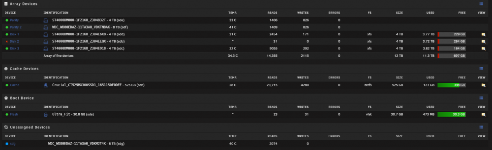

Hey all,
I noticed last week that one of my drives was dying, so I ordered 4 new drives to replace all of them.
I am going to switch from:
4x4TB (one parity)
to:
4x8TB (one parity)
Potentially adding 2x4TB to that.
I thought I understood what to do, so yesterday I installed a new drive to act as parity. It's currently the second parity drive.
During the rebuild, the 4TB drive errored out, so now I am in a strange state where I have a 4TB parity, an 8TB parity, 2 working 4TB drives and a broken 4TB drive.
I added another 8TB drive to serve for data, but I can't add it to the pool because of the 4TB parity drive. (I can add the other 2 8TB drives when needed)
How should I proceed from here to get the data transferred over to the 8TB drives?

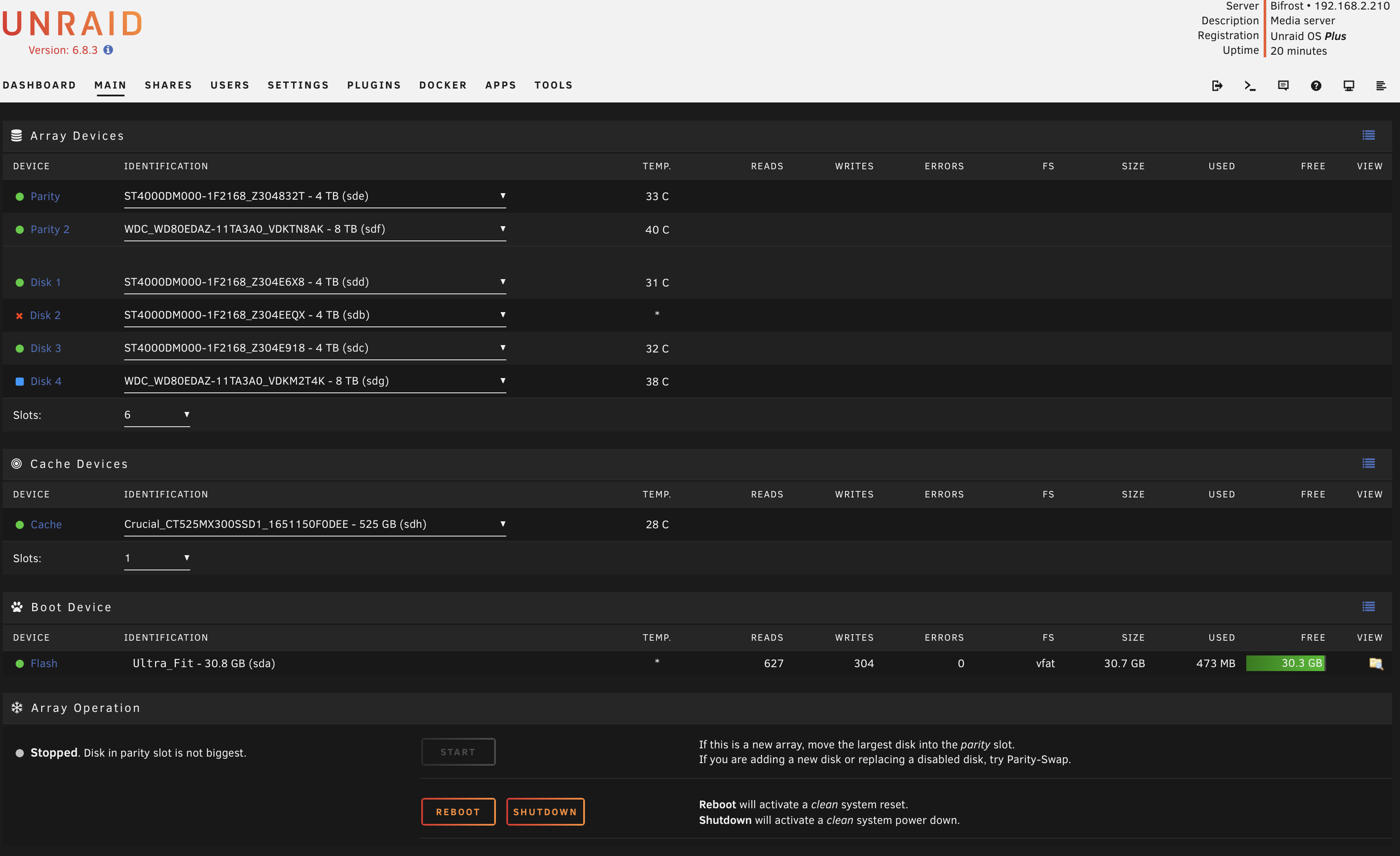

After looking at those diagnostics I realized I didn't look closely enough at your screenshot. You can't add a disk larger than parity, and you shouldn't attempt to add a disk when you have a disabled disk anyway.
Unassign that new disk and see if you can start the array. Then post a new screenshot and new diagnostics.
Do you want me to start the array without either of the 8TB drives, or only without the 8TB data drive?
The 8TB parity2 is OK. Just unassign the 8TB data drive since you can't have any data disk larger than any parity disk.
