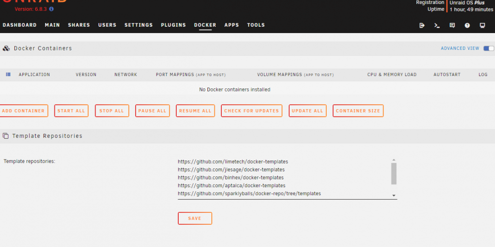

August 30, 20206 yr My server was running a little sluggish, so i rebooted it. After reboot all my docker apps are gone! I assume i can reinstall them, but i am hoping to not to that everytime i reboot. can anyone assist? thank you! q-nas-diagnostics-20200830-1159.zip
August 30, 20206 yr As far as the system is concerned, the docker.img file didn't exist, so it recreated it. Without knowing the exact chain of events, its impossible to know for sure what happened there. But, simply go to apps, previous apps and check everything off you had installed before, hit install, grab a coffee or a beer (depending upon the time of the day) and before you get back to your computer everything will be back as they were.
