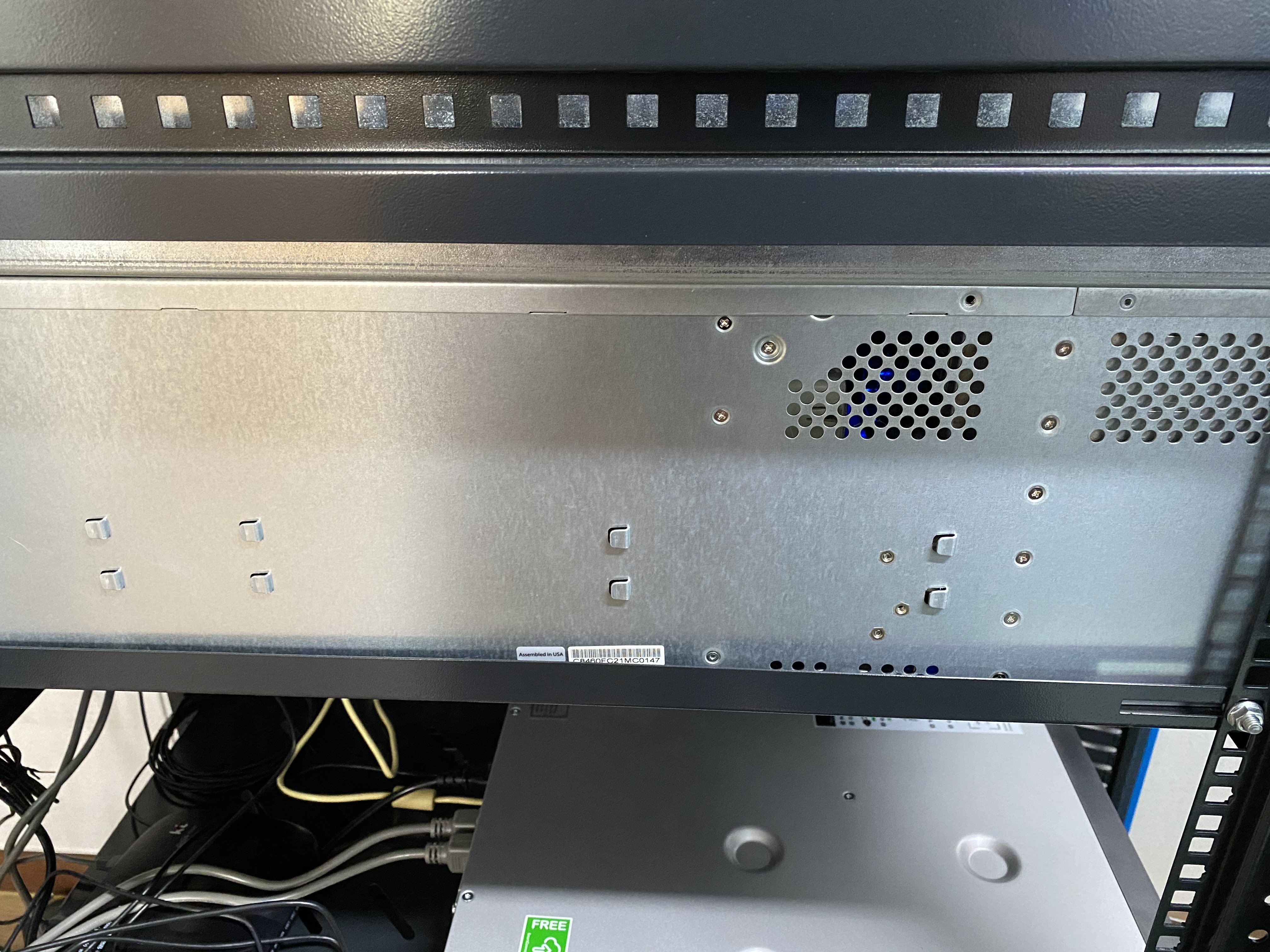

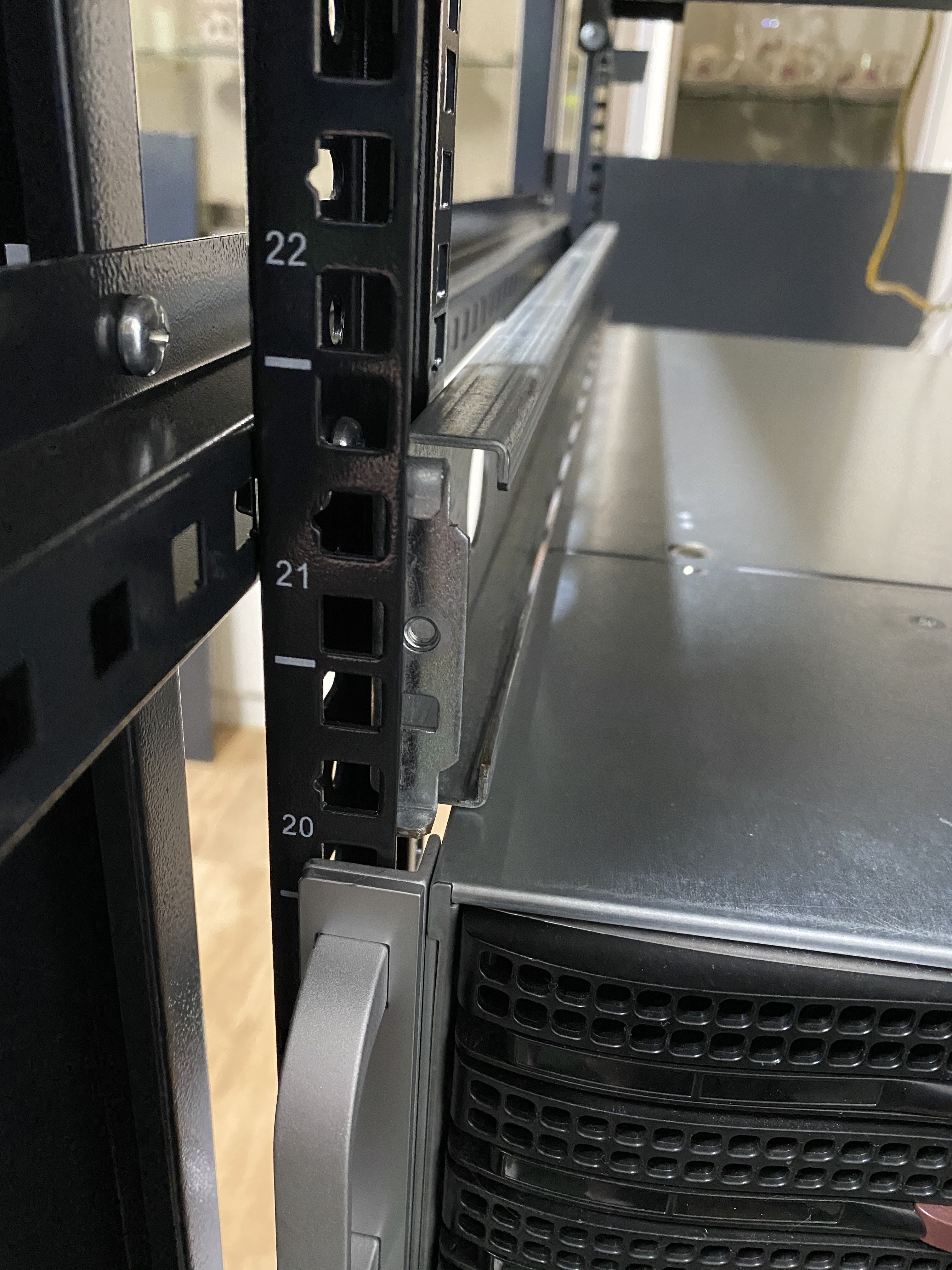

[Rails]
I got a Supermicro 846 chassis about a year ago.  It came with some cheap rails. Besides the fact that the max length on the rails is 29.5 inches, and my server rack is 30 inches, the rails don't seem to fit.  Please see the pics.  The rack I have has a second set of cage nut inserts that face inward and seem to get in the way of the rails.  Are there thinner rails that I can use?  I've looked online and I'm confused and I don't want to buy the wrong product.  First pic is of the rails not lining up to include showing the inward facing securing point.  The second pic is of the side of the 846 chassis, for reference.  The rack is a Daewon TMT DW-S1200 if that matters.  22U, 1200mm high, 1000mm deep, 600mm wide.
