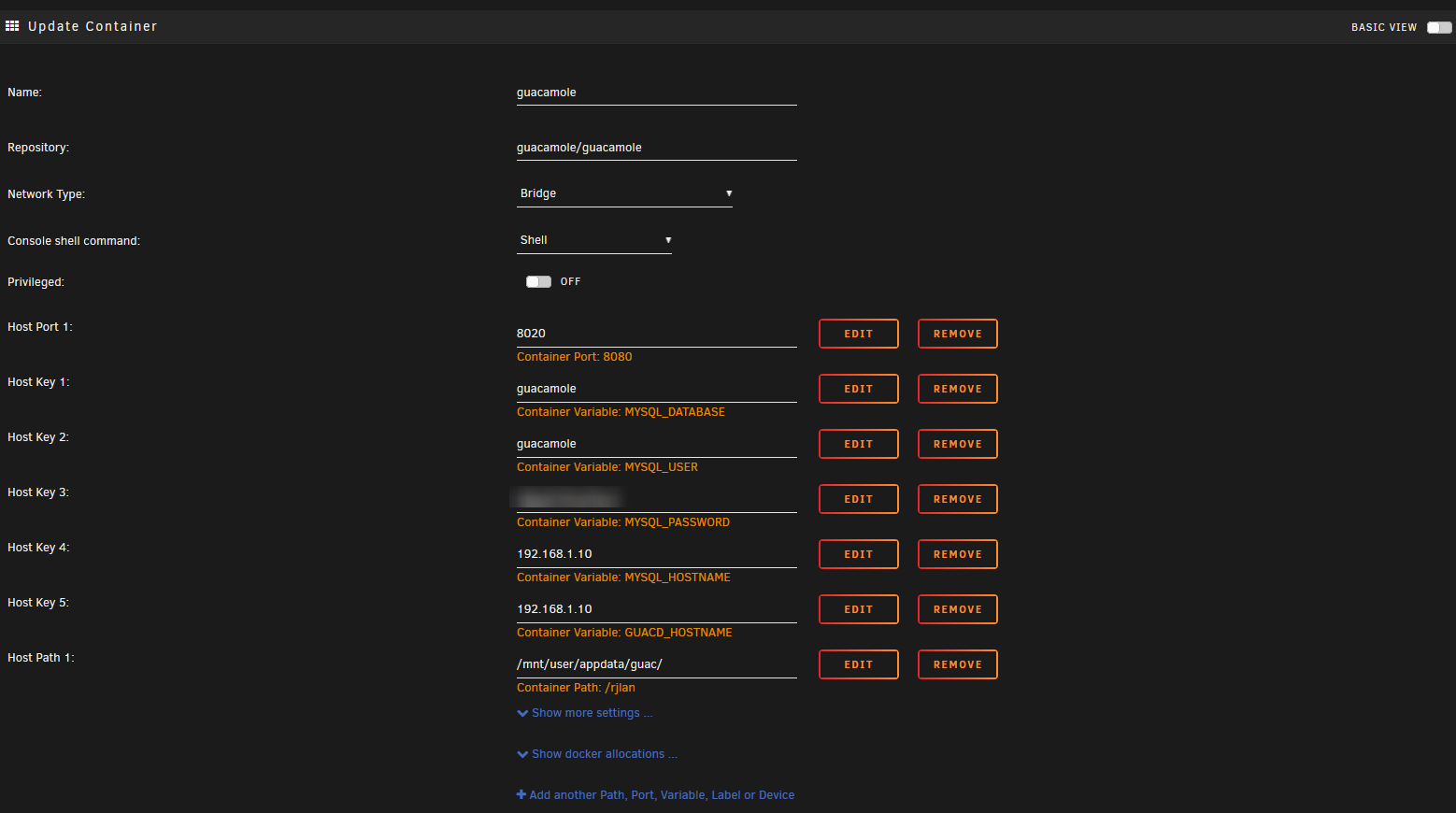

November 14, 20206 yr You can use this as the frontend. See screenshot for an idea of what you will need to configure. Note that you will also need a database and will need to import some sql for it to work. I added a path to my appdata folder to copy the sql that will be needed to import into the database. I used maria as the db and used phpmyadmin to create the database, user, and import the 2 sql files which can be find in /opt/guacamole/mysql/schema Hope this helps and good luck!

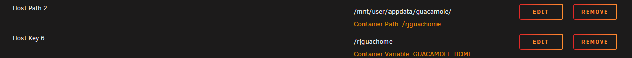

November 21, 20206 yr @crazykidguy So I hadn't setup any extensions yet, but since you asked I dug into it. You will need to create an appdata folder and link it somewhere (anywhere) in the container (guacamole frontend, not guacd). Then you will need to create a variable GUACAMOLE_HOME of the directory you linked inside the container. See attached screenshot. Then create a folder in the appdata directory named extensions and download and extract guacamole-auth-totp-1.2.0.jar into that folder. Restart the container and you're done. Sources: https://guacamole.apache.org/doc/gug/guacamole-docker.html#guacamole-docker-guacamole-home https://guacamole.apache.org/doc/gug/totp-auth.html#installing-totp-auth TOTP Jar https://guacamole.apache.org/releases/1.2.0/ Edit - You will be prompted to setup TOTP at login. Out-of-the-box it doesn't appear to be optional, all users will have to setup TOTP Edited November 21, 20206 yr by rjlan Login info
