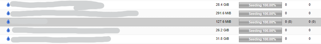

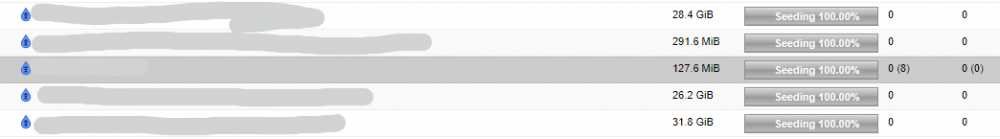

  4. Unfortunately I never got an answer to my issue. I ended up routinely going into Deluge to pause all the torrents and then restarting them, then I would verify it's being seen by the trackers. It doesn't seem to have been happening since I made my last post about this but I would say probably check if there's any updates you can make to the image or if everything is ok with your VPN port-forwarding service. I was using PIA and believe the endpoint for my port-forwarding went down and I had to update that.

  14. Anyone else getting an issue like below where the torrents stop announcing/ updating to the trackers? They seed perfectly normal for an amount of time and when I happen to check it after some time, they look like the ones below with (0) on Seeds and Peers. I have to manually pause and restart the seed to get the Seeds and Peers to display and the Tracker Status to read OK. Any idea what's causing this? I'm behind PIA and again, things seem to seed perfectly find initially after I restart the torrents. It's after some unknown time for some unknown reason they stop announcing.
