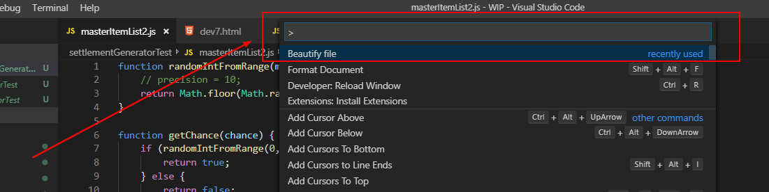

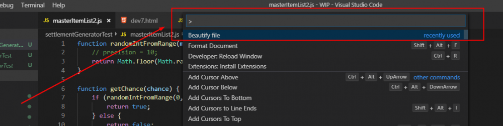

Does anybody know how to get the command window to open up in the browser window?
The window I am talking about is opened by hitting CTRL+Shift+P in the Windows VSCode application, but doing that in browser does not work.
