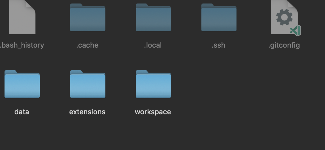

Got this setup but I can't drop my SSH key in the .ssh folder. It's grayed out. When I check permissions it says I have read/write but when I try to drop it in, it just doesn't go. Doesn't say I don't have permissions, just doesn't do anything. Thanks for all your hard work!
That just looks like it's greyed out because it's hidden files. Have you tried to open the folder?
I don't know how you are accessing your appdata, but you can also copy them to the appdata folder and move them using the command line to the .ssh folder.
I was connecting from my macbook via smb. I was able to drop them in the code-server folder then move them into the .ssh folder from the terminal. Thanks!

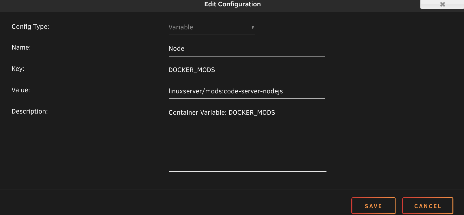

Apologies for the noob question, I can't get the script to work. I'm trying to install nodejs. Can anybody see what I'm doing wrong from the logs below?
[cont-init.d] 99-custom-scripts: executing...
[custom-init] files found in /config/custom-cont-init.d executing
[custom-init] apt-get update && apt-get install -y nodejs: executing...
/bin/bash: /config/custom-cont-init.d/apt-get: No such file or directory
[custom-init] apt-get update && apt-get install -y nodejs: exited 127
[cont-init.d] 99-custom-scripts: exited 0.
[cont-init.d] done.

Did you look at the link above your post?
I've also tried that method but couldn't get it to work so I must be doing something wrong.
Here's my code-server environment variable:
Yet I still can't get node to run -
`DOCKER_MODS` needs to be in Key. It should look like this
Thanks very much, that sorted it.
