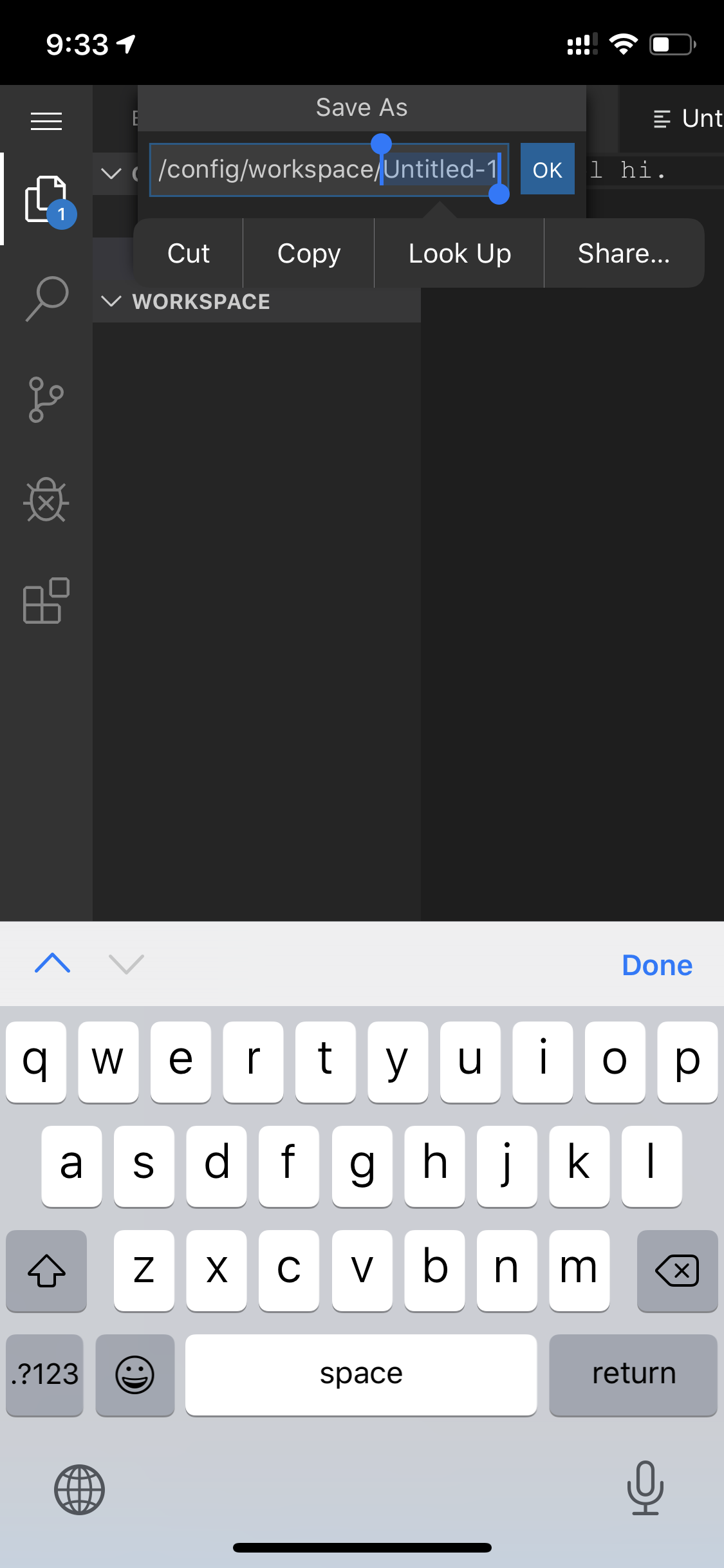

Do I have to add a new volume mapping? The default current save directory is loading
/config/workspace/Untitled-1
which I don't think is correct..? The user can traverse upwards and expose the config folder...
Why isn't that correct?
Is there a way not to expose to config folder?
What? Not expose to what or who? It's the folder that contains the container data
This is the default Save folder. Which is saved inside the config folder for the container data. Feels wrong to me, especially if the user can just navigate to upper folder easily (on a desktop). Is there a way to hide it? Change the default folder?
You might be able to change the default folder, but then you have to check out the code-server documentation.
This isn't a multiuser software so /config will always be available to the user using code-server. If that feels wrong to you, you have to find another alternative to code-server.
@CyberMew
I don't know how much you used code-server, or vscode for that matter, but when you open a terminal, you have access to the entire container. Same as when you open the terminal on a bare metal install of vscode, you have access to the entire machine contents.
So I genuinely don't understand what your expectations are here.
I thought that it was “disposable” and it would be great if it was in “incognito” mode everytime for just playing around. I just didn’t want the config folder to be the default folder since it isn’t multi tenant(?). I will figure out if it’s possible to change the default save directory to a folder that I will map it to. At the very least that will indicate users not to touch anything outside of my sandbox folder. Thank you both for your inputs.

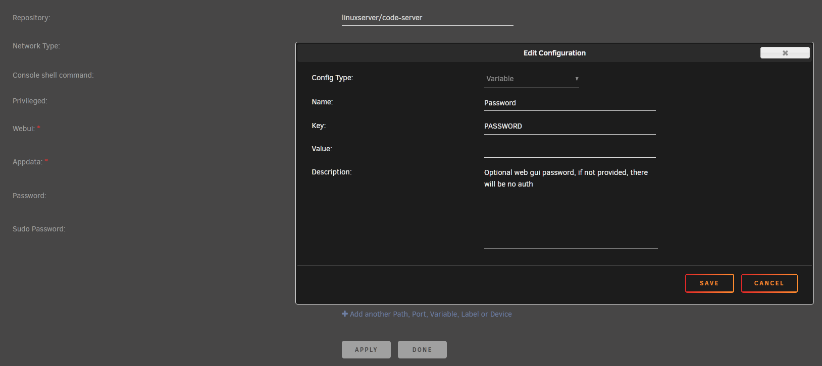

I've a second question, I've not understood how to implement the FILE__PASSWORD inside your dockers (in uNRAID)
You can ask their dev
Map the file somewhere (or use docker secrets) and pass the location in an environment variable
Hello, but Docker secrets aren't only for swarm?
And with your Template - how I have to pass the variable?
This one is the Variable that come with the template.
With docker compose you can. Anyway, that was just an option listed, not a recommendation.
For the second, you need to look at docker faqs. It's an unraid thing but in a nutshell, you use the key/value to set the variables and you can add as many as you like (volume mappings, too).
