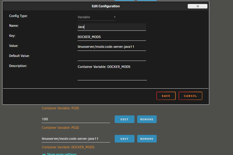

I am a bit of noob with all of this so I am probably missing something simple but I am trying to get a java project to work in this, but I don't seem to be able to get java properly installed.  I'm not sure of steps needed for this but I was hoping for a little help?
I did install the java docker mod but that doesn't seem to installing Java?

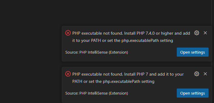

Hello,
Does anyone know how to solve this php error in the container "PHP executable not found. Install PHP 7 and add it to your PATH or set the php.executablePath" ?
Did you try the binhex version of code-server?
yes thanks all good !

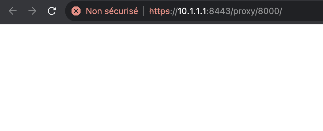

Hello, I am trying to configure the Code Server proxy through a VPN, but it redirects me to a blank page when I try to connect to a web page, even though the proxy is working:
But when I want a web site:

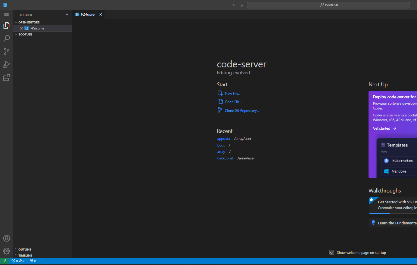

How can I access /boot to modify user-scripts?
I try this:
I try this:
You don't need to do that, there's a 'User Scripts' plugin that is easy to use.
I know it. But I want to user code-server to modify my scripts under /boot/config/plugins/user.scripts/scripts/XXX
