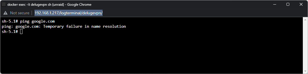

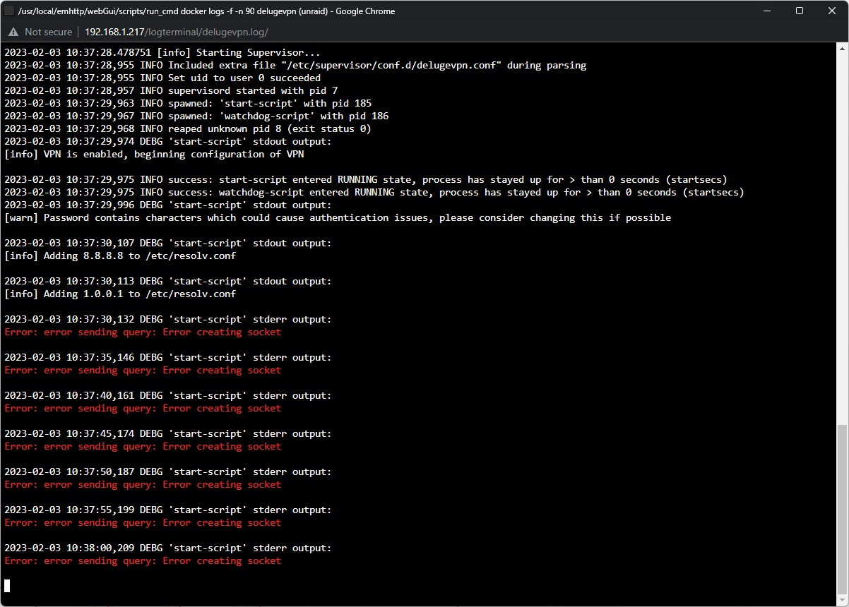

  2. I am running Unraid and I recently had a RAM stick go bad which corrupted my cache. I have identified and removed the bad stick, fixed cache, and restored from CA backup. All is fine EXCEPT for my delugeVPN docker. I am back to having DNS issues with it and stumped as to what the problem could be. I had changed the DNS per issues reported above and all was working find up until the restore. I have tried several opvn files but it doesn't really make a difference because DNS isn't working. Any ideas?
  3. I had the exact same issue, running PIA on openVPN. The Fix: via the Unraid WebUI: 1) Under Dockers 2) Edit DelugeVPN 3) Scroll to the "DNS_NAMESERVERS" key 4) remove the long list of DNS IP addresses (clear them out) 5) replace with 8.8.8.8,1.0.0.1 6) hit apply 7) test this by launching a console from within the DelugeVPN docker and attempting to ping something like "ping google.com" and verify that it resolves the address. If so, you are good to go.
