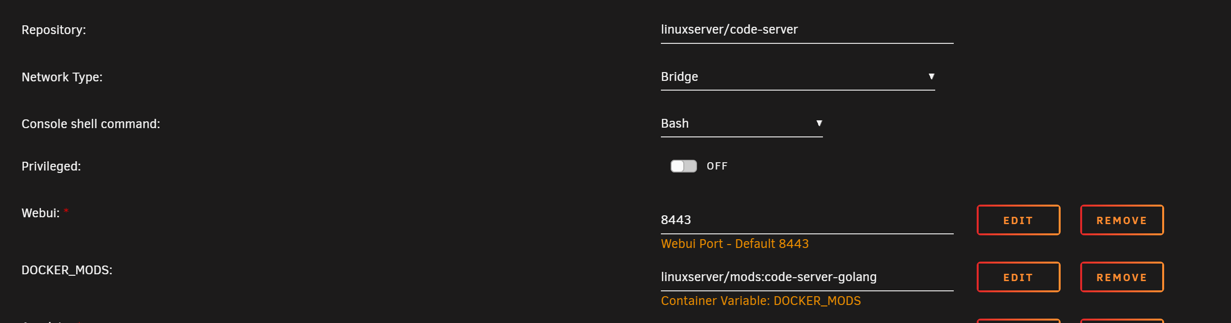

8 hours ago, muwahhid said:
Started studying golang, used ide vscode.
How can you install a golang in a docker so that when you upgrade, it doesn't disappear?
Read the readme section called docker mods.
It's a pity it's so complicated. I didn't really know how to do it.

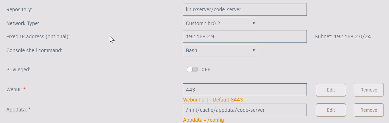

Hello, I am having trouble getting this container to run on a different port. See here I am trying to set port 443 as the host port:

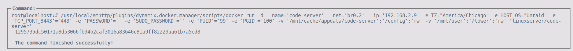

Then, during docker run, it appears to be set correctly:
But then it still starts on the default port:
And the logs show the same default port being used, not the set one:

How can I get this running on port 443? Is there a limitation where it cannot run on 443/HTTPS?

4 hours ago, dave said:
That's because you set an IP for the container. Port mapping have no function then, as it's the same as running it in host mode. If you want to use port 443 you have to use bridge network mode.

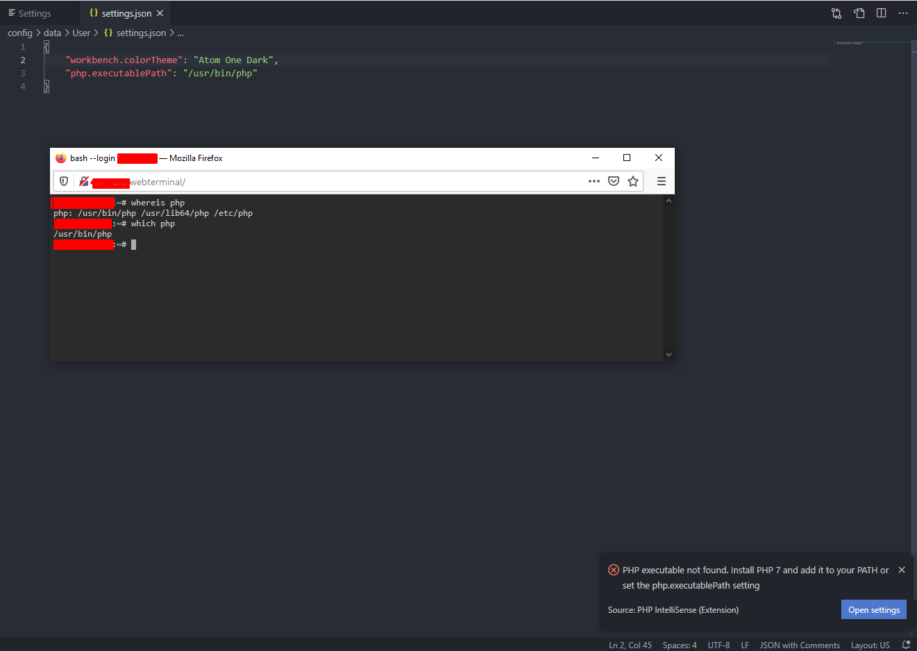

Set up the linuxserver.io code-server docker and loving how remote it has allowed me to be. However, there's a setting I relating to the intellisense setting for in php (which I code in) that I can't set properly and its been driving me nuts. The setting is php.executablePath. I believe I have the correct path set but for some reason it won't pick it up. To verify that I do have a php executable I went to the terminal and ran whereis and then which. It's spitting back the same executable path that I've put into my code server settings, so I can't figure out why i'm still getting errors. I ran < php -v > and I do have a php version installed, see below. Any help is appreciated.
php -v result:
PHP 7.4.15 (cli) (built: Feb 11 2021 09:48:37) ( NTS )
Copyright (c) The PHP Group
Zend Engine v3.4.0, Copyright (c) Zend Technologies

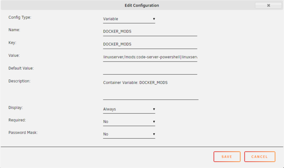

I recently lost and had to rebuild my docker.img file settings in unraid, I had this running perfectly with MODS previously but now I seem to be running into issues.  I assume I have messed up somewhere but I cant seem to locate my error.  A second set of more experienced eyes are welcomed.
[mod-init] Attempting to run Docker Modification Logic
[mod-init] Applying linuxserver/mods:code-server-powershell files to container
gzip: stdin: unexpected end of file
tar: Child returned status 1
tar: Error is not recoverable: exiting now
[mod-init] Applying linuxserver/mods:code-server-python3 files to container
Please post the docker run command so we can see the full picture.

16 hours ago, flinte said:
root@localhost:# /usr/local/emhttp/plugins/dynamix.docker.manager/scripts/docker run -d --name='code' --net='reverse-proxy' -e TZ="America/Denver" -e HOST_OS="Unraid" -e 'PASSWORD'='' -e 'SUDO_PASSWORD'='NunY0Businass!' -e 'HTTPS_PROXY'='https://192.168.11.3' -e 'DOCKER_MODS'='linuxserver/mods:code-server-powershell|linuxserver/mods:code-server-python3' -e 'HTTP_PROXY'='http://192.168.11.3' -e 'PUID'='99' -e 'PGID'='100' -p '11443:8443/tcp' -v '/mnt/user/appdata/code-server':'/config':'rw' -v '/mnt/user/software/Scripts':'/workspace':'rw' 'linuxserver/code-server'
8cf52278e45640c43f3a34724c3ae5d55d377d949116ee4b9702f4219b3910ad
The command finished successfully!
Where did you get the http and https proxy env variables from? That's not something from our container.
I am unsure.  I thought I got it from your dockerhub page .. regardless removal of these lines worked
It's not in our documentation and I can't remember having it there either.
