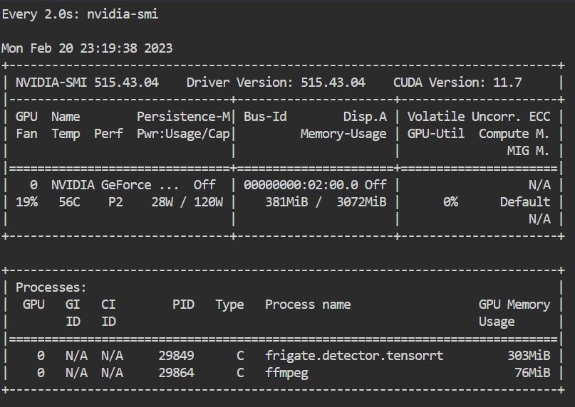

  1. Thank you so much! I did get it set up on my one (test) camera, only going to be using it for 2 total, so shouldn't overload my 1060 3gb too bad Really great documentation! I can't say I know the first thing about object detection models, so I'm using default everything.. I'll report back with any feedback on performance.
  2. Hey there, I'm using the beta8 Frigate docker, MQTT in docker, run HA in a VM also on unraid, and using Nvidia GPU for hardware acceleration. All is working fine, couple of minor issues, but really liking this and dropped Shinobi, finally (!) I'm curious if there are any additional steps or instructions to enable object detection using Nvidia GPU as opposed to CPU? I don't have Coral but my vintage Xeons seem to be doing fine, would be great to offload to GPU though. I see this in the docker: - If you want to use the NVidia TensorRT Detector, you have to add the tag suffix "-tensorrt" to the repository link, and create the models using the "tensorrt-models" app from the CA app. So would the steps be more or less as follows? 1) Get the tensorrt-models and follow the instructions as listed there 2) Change repository on Frigate from ghcr.io/blakeblackshear/frigate:0.12.0-beta8 to ghcr.io/blakeblackshear/frigate:0.12.0-beta8-tensorrt (note - is it beta8 or beta2?) Is that it? Do I need to add anything else to my Frigate config? In this link it states "Note: There is no support for Nvidia GPUs to perform object detection with tensorflow. It can be used for ffmpeg decoding, but not object detection." Thanks very much!
