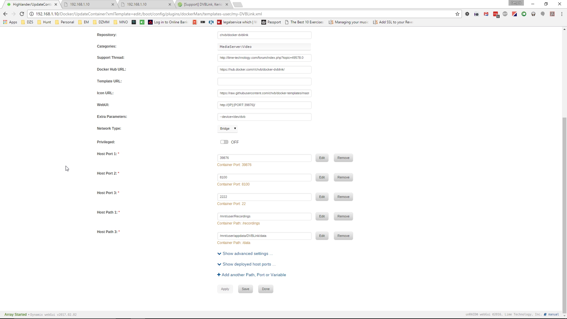

OK..thanks.. but following the instructions i'm getting
root@localhost:# /usr/local/emhttp/plugins/dynamix.docker.manager/scripts/docker run -d --name="DVBLink" --net="bridge" -e TZ="Europe/London" -p 39876:39876/tcp -p 8100:8100/tcp -p 2222:22/tcp -v "/mnt/user/Recordings":"/recordings":rw --device=/dev/dvb chvb/docker-dvblink
18f28a73ca18c618ca61d8e3b001bd92023eca3c4a98ea5c0ce61cf99448f07a
Error response from daemon: Cannot start container 18f28a73ca18c618ca61d8e3b001bd92023eca3c4a98ea5c0ce61cf99448f07a: error gathering device information while adding custom device "/dev/dvb": lstat /dev/dvb: no such file or directory
The command finished successfully!
