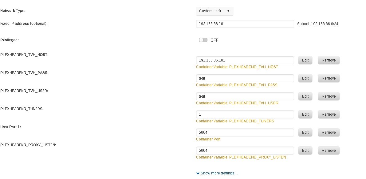

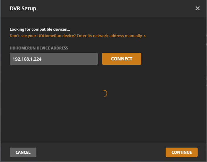

Okay, guys, i mightg found something out.
Yesterday i had to change my network from 192.168.0.X to 192.168.86.X because of this, dvr failed again, ofc.
1.) This time i entered IP:PORT of the tvh proxy (the one i posted above) (look picture, for configure)
2.) i didnt wait or anything, i just clicked next
3.) it didnt worked, like always
4.) But this time i didnt wait for it to come up under known devices, i just tried it some seconds after again with IP:PORT and next....
5.) and it worked, the device appeared AFTER i clicked next (oO)
6.) the coolest thing now is, you can use the EPG from tvheadend to configure your channels in plex (automatic! :D)
-> at EPG you can select use your own blabla you can enter there "http://test:[email protected]:9981/xmltv" Remember, i have all involved dockers (plex, tvheadend and the tvh proxy) in br0, with own ip adresses in the same subnet (im not sure if that is neccessary, but you should try)
Finally working :D

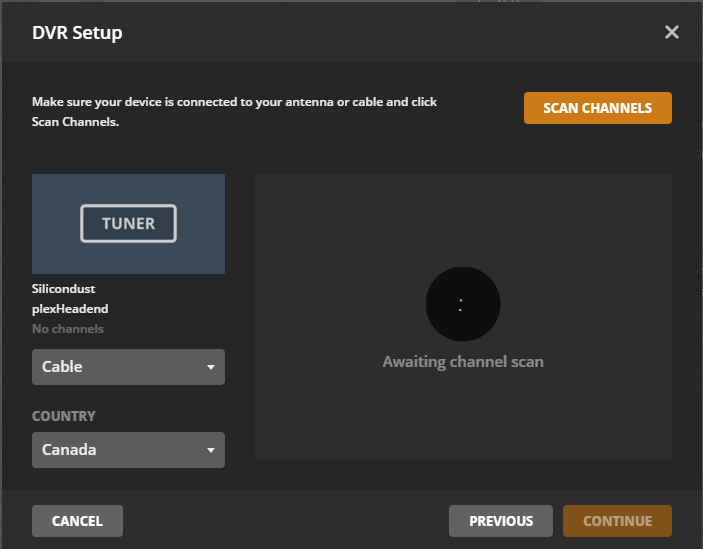

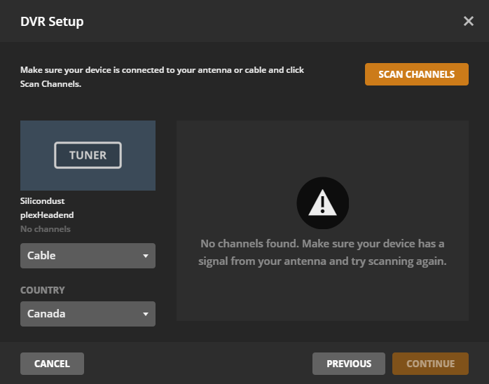

@nuhll
Any TVHeadend configs you can specify ? Now plex is giving me no channel scanned ...
Hmm, ask me specific things, its easier that way.
But i dont think i did something special. Just normal inbuild guide. But i needed to add another muxe, because i only got some channels.

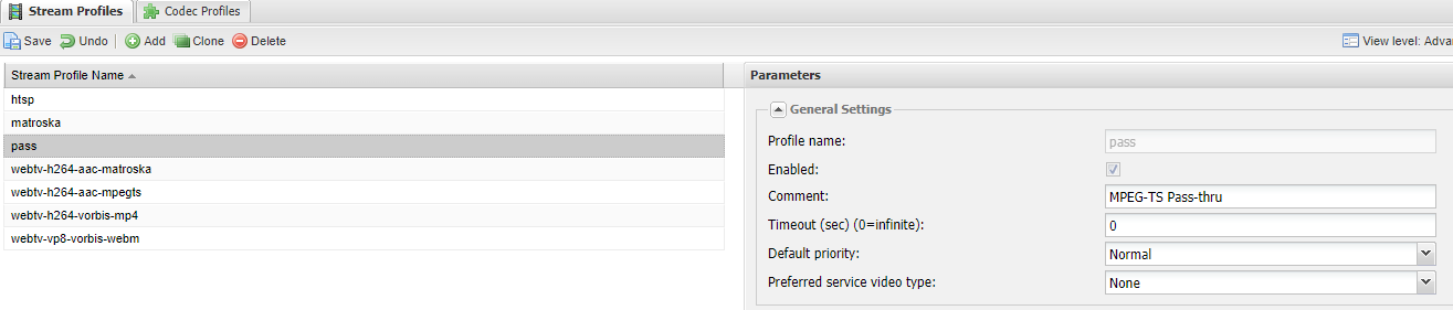

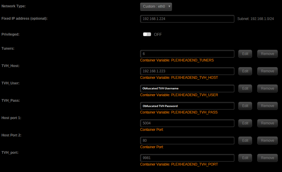

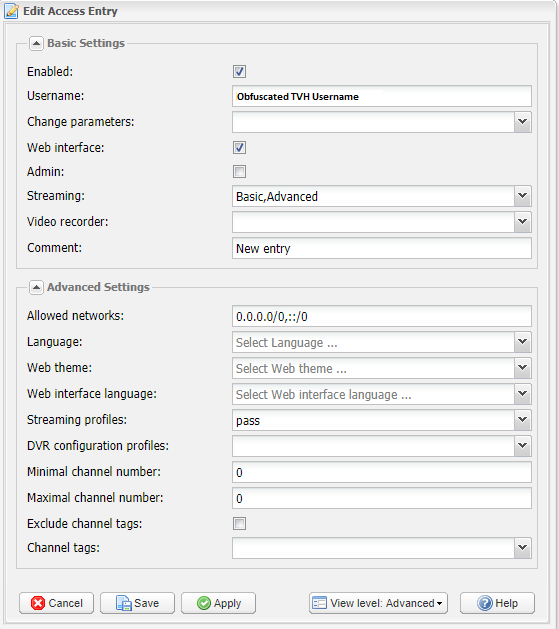

@nuhll Here is a rundown of my configs
On 5/16/2018 at 5:06 AM, nuhll said:
@nuhll

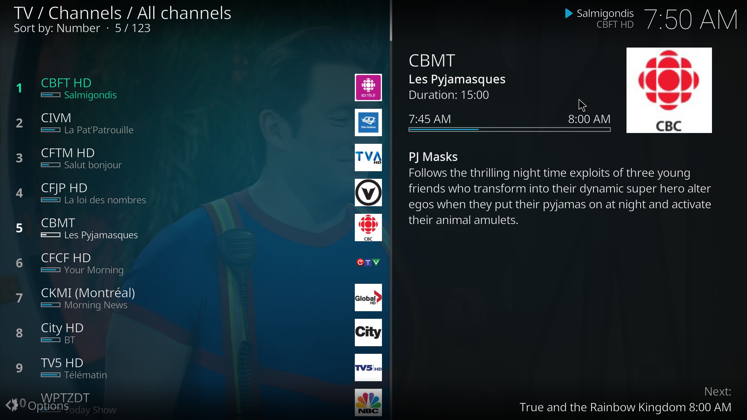

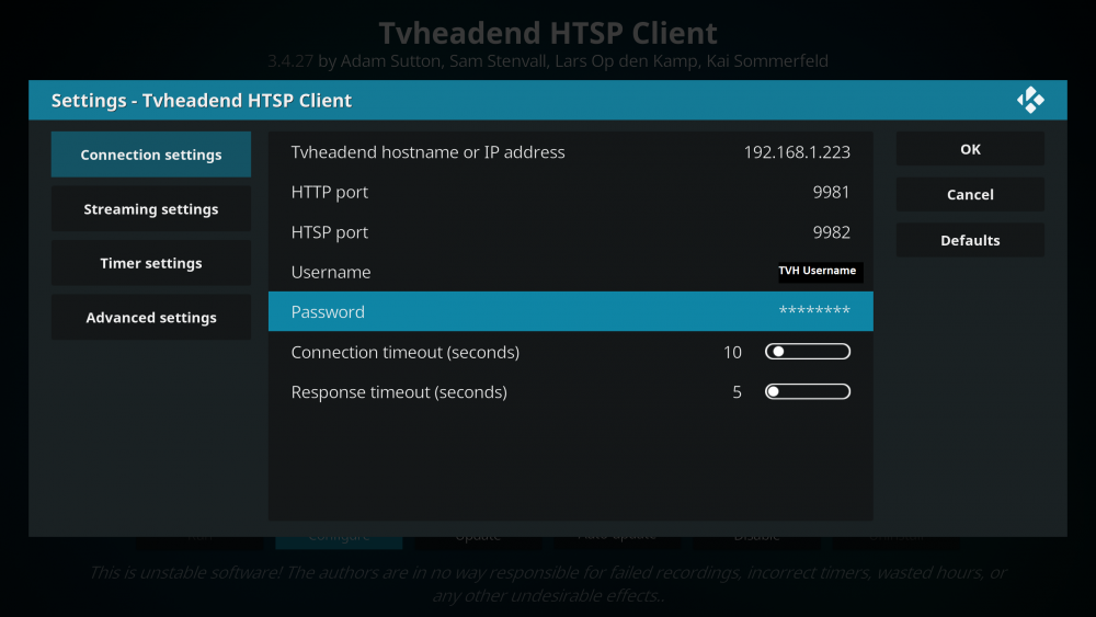

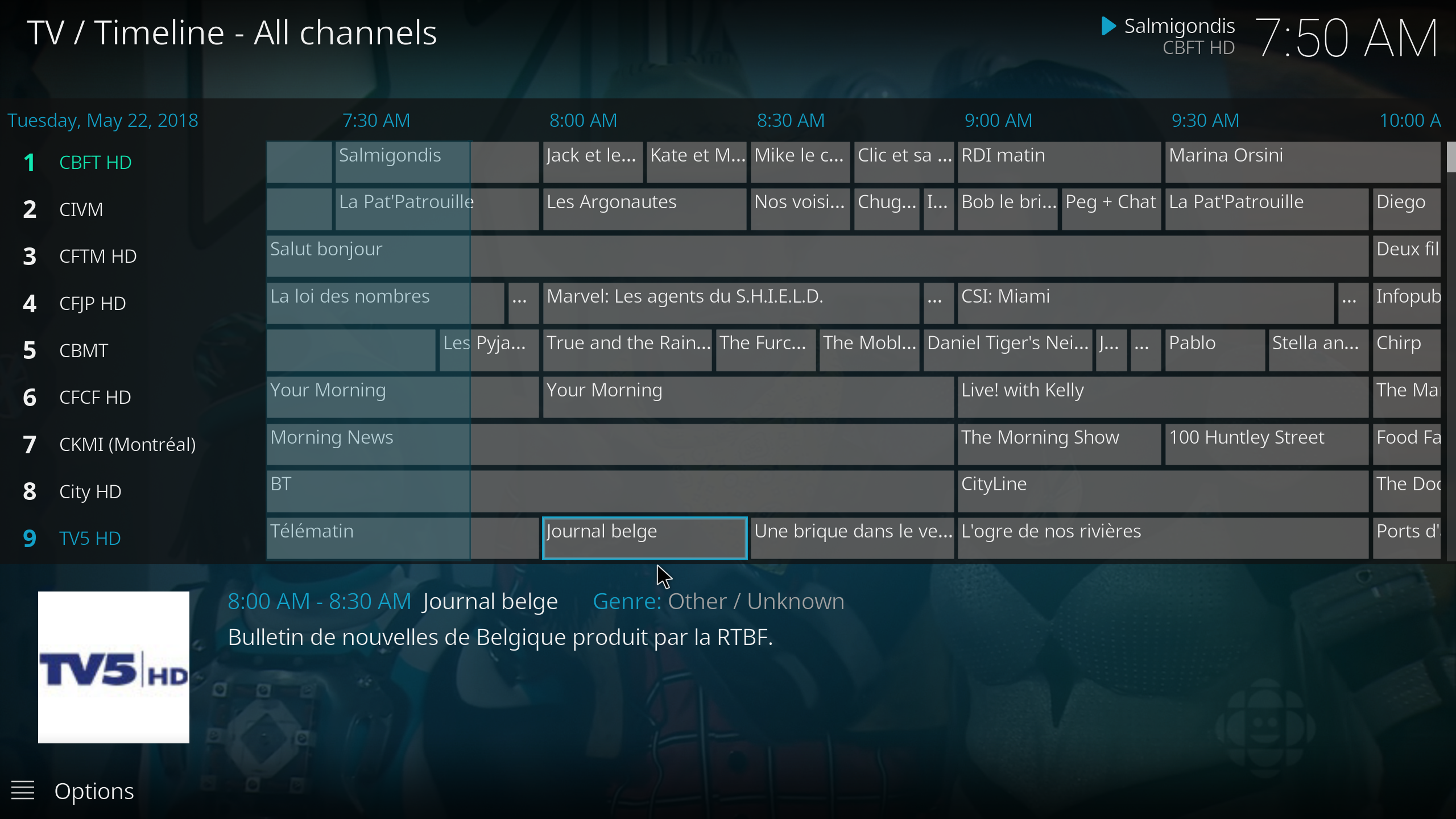

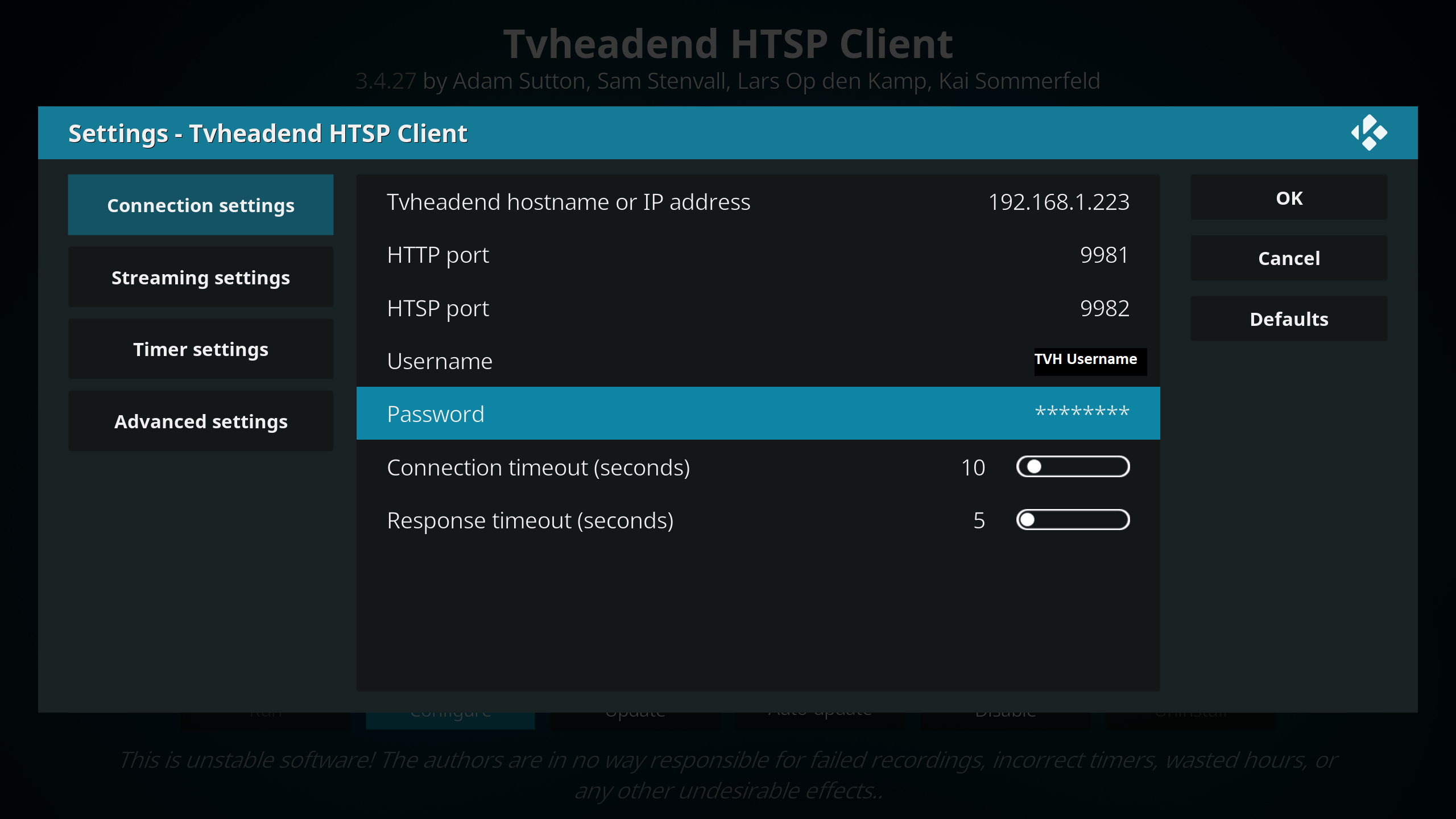

First of all, can you watch via tvheadend?
@nuhll Yes :) Here is from Kodi.
So any idea ?
I think the network type on this, TVH and Plex should be br0. No idea if it'll help, I couldn't get that docker working and went back to tvhproxy.

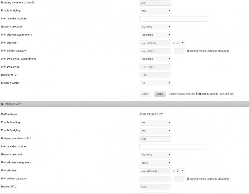

I did wonder that... I am just adding a 10gbe network today on another subnet, I can add another to get over this issue but surely people have got it working on the same subnet or does everyone have to do this?
I dont know what you mean.
No one needs multiple subnets, except you want to add multiple nets together (multiple routers).
br0 has nothing to do with subnet. Br0 is just OWN ip instead of UNRAID IP. And br0 always needs to be on the same subnet as UNRAID IP. (atleast in standard config)
Bridge is with NAT. br0 allows contaienrs to talk to each other without NAT.
To clarify this: Use br0 on the containers which have network issues, all other can be bridged.
To the 10g thing, tell us what you want to do, mostly you just add more switches and dont need to change anything on subnets.
Edited by nuhll

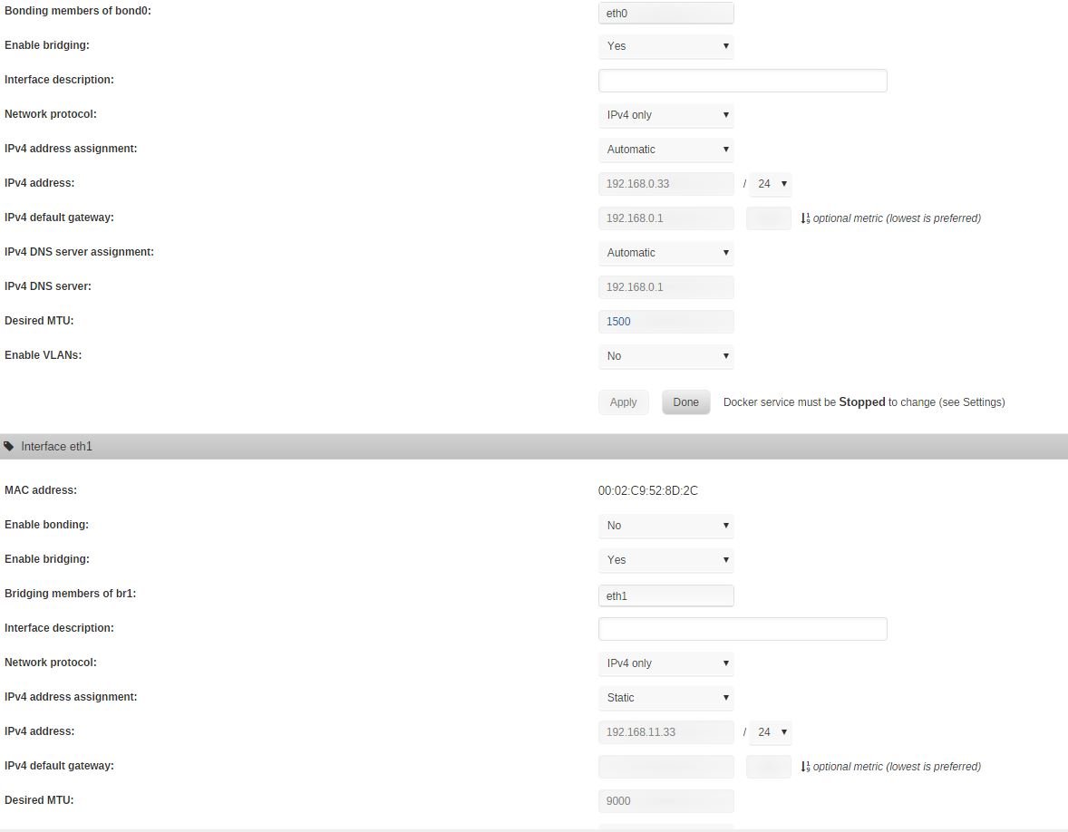

Hi mate,
Since installing the 10gbE card br0 is no longer available as an option for the dockers?  all the 10fbE is for is to transfer media between my main rig and my unRAID server, it has no access to the outstide world, please see screenshots below
Thanks for your help, I would love to get this working!
I dont know maybe u cant use br0 with multiple interfaces.
If so, i wouldnt know why. Maybe not added yet?!
@limetech is that the case?
Edited by nuhll
Just to update and prove that I was not going mad! the problem was due to the linuxserver Plex docker!
I installed a 10gbE network and found that the network could not co-exist with the linuxserver Plex Docker so changed to binhex and just thought I would try tvhproxy again and it worked straight away! hope this helps others as I have seen many people with similar issues.
Thanks so much for all your help nuhll ?
Good that its working now for you. I also tried both dockers, with same results and eneded with this here which worked after many many many many tries.. :)
