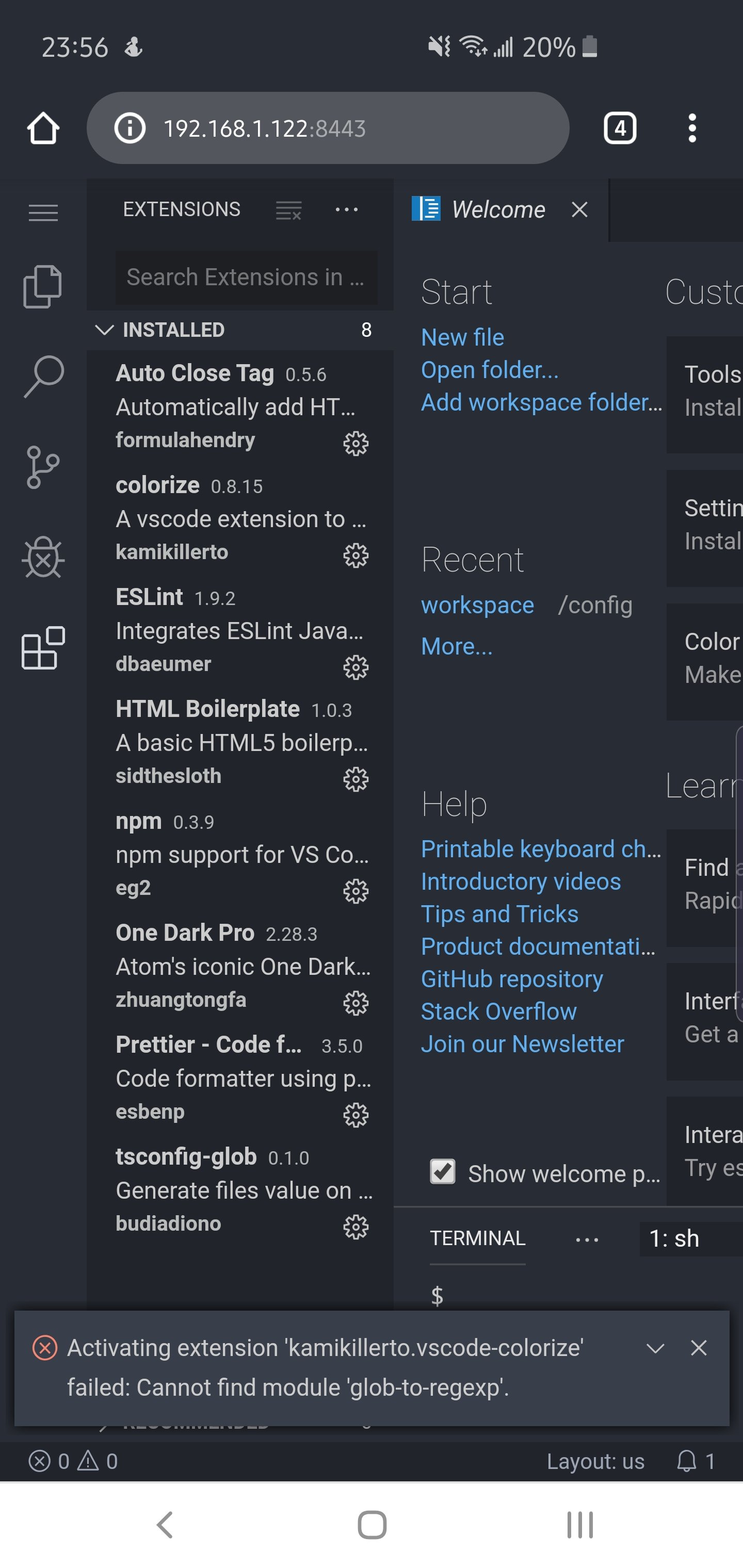

I keep getting the error at the bottom of the screenshot attached.  Apparently it has something to do with NPM and/or Node.js.  How would I go about installing Node.js on unraid or within the code server docker itself.
Also, what would be the best path to use for saving files?  Example: /files to /filesshare.
Thanks.
Edited by Xcelsior86
Thanks.
See here for customizing: https://blog.linuxserver.io/2019/09/14/customizing-our-containers/
