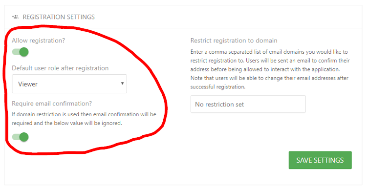

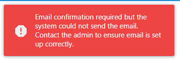

Does anyone have a mail server configured with bookstack (for users to create their own accounts and receive an email confirmation)? The documentation on the bookstack website doesn't cover it. I'm sure there's a config file somewhere I have to setup but I can't find it.
BookStack settings page to allow user registration via email
Error message when trying to register new user w/email confirmation
Add your mail settings to the .env file in `/config`
EDIT: I got it working - thank you @j0nnymoe! Here are the steps in case anyone else needs to get this setup:
1. Click on the bookstack docker icon and select console.
2. Type in nano /config/www/.env to edit your .env file
3. Arrow down to the bottom until you get to #Mail settings and configure it according to your mail server (I use Zoho mail). If you have 2FA setup on your mail server account, you'll probably need to request an application specific password to use in your bookstack .env file
