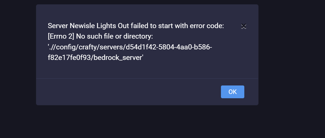

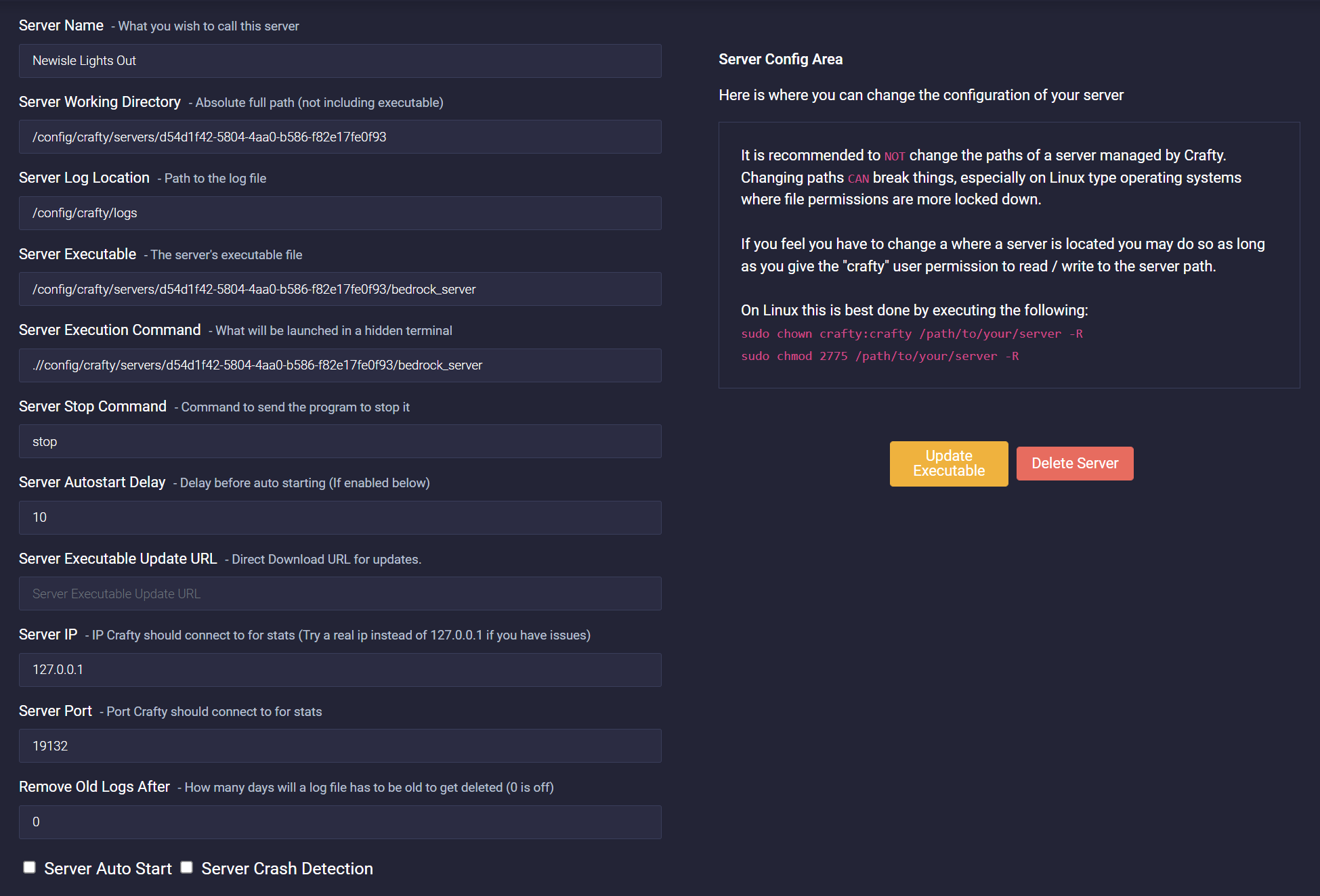

Trying to add server from binhex-minecraftbedrockserver but having error .
what path and executable should i use for server ?
anyone using it for bedrock server ?
Yep, me
Sent from my CLT-L09 using Tapatalk
11 hours ago, binhex said:
Yep, me

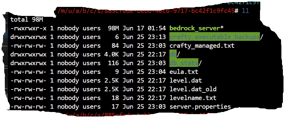

can you explain about config path for executable (bedrock_server) and how its working , it should be updated manually ?
i copyied (bedrock_server) file from binhex-minecraftbedrockserver but it cant be found ...
Where should i put bedrock_server file or how to use it ?
i meaned how to migrate server from binhex-minecraftbedrockserver to Crafty 4 ?
What to copy and where to put it things like behavior_packs and etc ...?
should i copy entire binhex-minecraftbedrockserver/minecraft/ maybe ?

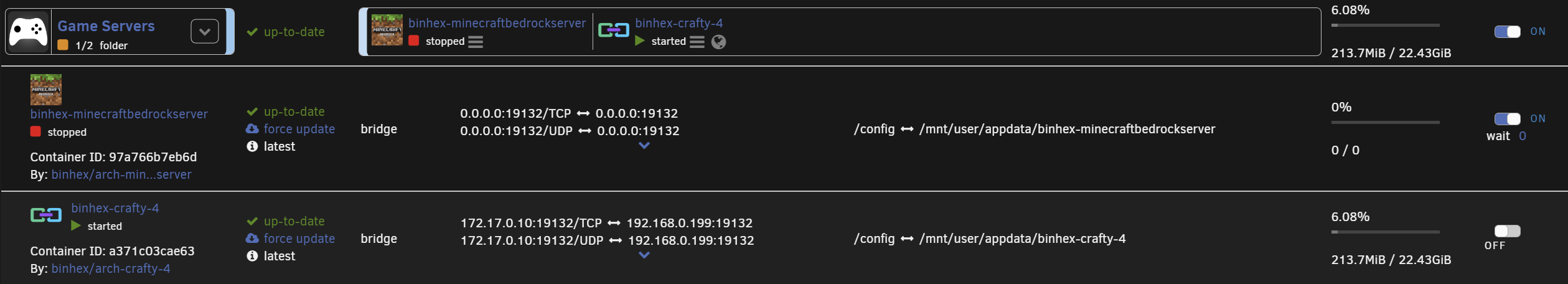

@binhex finally made one server works but how its work if i have 2 bedrock servers on same port ?
@binhex also was wanted to ask if is it normal that i have cpu % jumping from 0.5% to 6% but binhex-minecraftbedrockserver was only 0.5% ?
also how to autoupdate bedrock server ?
I haven't tried running two servers tbh
No idea if it's normal for crafty 4, keep in mind crafty 4 is in beta state right now it could be a bug
