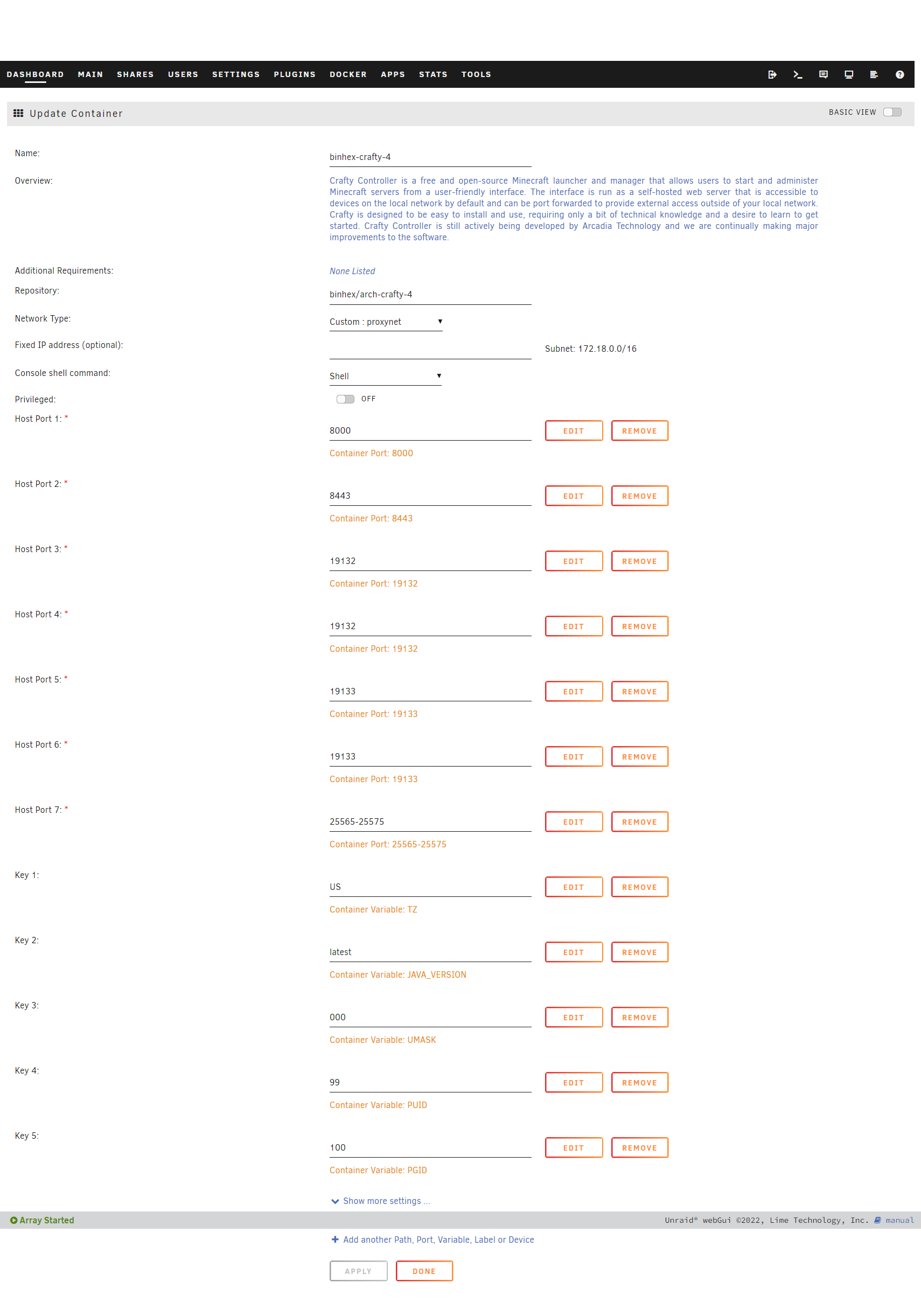

Thanks for the response. I managed to get mine working. Do you have any OTHER working SWAG containers that are forwarded? I do, so I started from there.
I copied a working SWAG subdomain.conf to a new name
cd /mnt/user/appdata/swag/nginx/proxy-confs
cp nextcloud.subdomain.conf crafty.subdomain.conf
nano crafty.subdomain.conf
Here are the contents of that file:
server {
    listen 443 ssl;
    listen [::]:443 ssl;
    server_name crafty.*;
    include /config/nginx/ssl.conf;
    client_max_body_size 0;
    location / {
        include /config/nginx/proxy.conf;
        include /config/nginx/resolver.conf;
        set $upstream_app binhex-crafty-4;
        set $upstream_port 8443;
        set $upstream_proto https;
        proxy_pass $upstream_proto://$upstream_app:$upstream_port;
        proxy_max_temp_file_size 2048m;
The parts I modified are:
server_name crafty.*;   ## this is the subdomain you setup at your godaddy CNAME, or wherever you host your main domain
set $upstream_app binhex-crafty-4;   ##this must match the name of your docker, Unraid > Docker Container > "Name:"
set $upstream_port 8443;  ## this must match "Host Port 2" container port on the Docker settings for Crafty 4. Hmm, that's not the best name for a variable is it!? But that's what it is.
Change Crafty 4 Docker container Network Type to "proxynet" (I had previously followed Ed Spacedinvader video for setting up reverse proxy youtube)
Then you gotta add "crafty" to the SWAG Docker > Settings > Subdomain(s):
I have a few others, so for me it looks just like this: "nextcloud,emby,crafty"
restart swag container, though when you make a change to the Subdomain(s), it will restart it already for ya.
boom, working.
Hope this helps! Let me know if you want screen shots of anything.

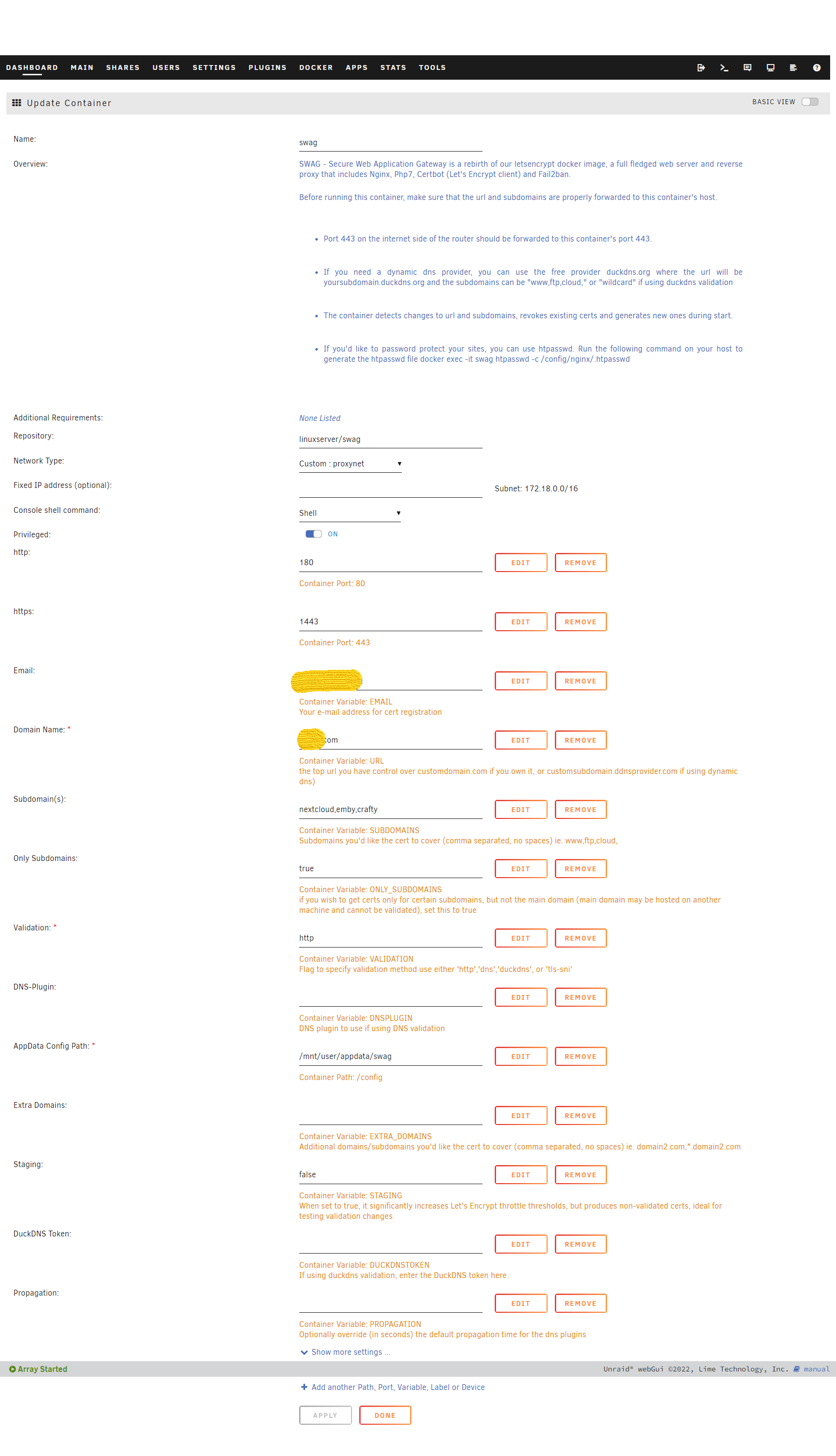

Unfortunately I still can't get mine to work. When I first started I had copied an existing config and tried to use that but nothing worked. I just tried using the config you provided but that also didn't work for me.
I must be missing something somewhere because all my other apps work through SWAG but just not this one. My subdomain is setup as "minecraft" so I have that configured in my SWAG container.
it's not a single step of copying a config over. There are variables that have to be changed.

Yep, I've made sure to change everything to match for what I need for this container. I've got many other applications running behind SWAG so I'm pretty familiar with how it works.
Also, I initially did follow a spaceinvaderone video when I initially setup my reverse proxy (before switching to SWAG) so just like you mentioned I have a "proxynet" network that I've assigned my containers to. I included a screenshot showing that I have my "crafty" container running on the proxynet along with the other applications I'm hosting.
To answer your question about the error message: it seems to be directly from SWAG as I'm not getting a DNS resolution error, it's specifically a 502 error from nginx. I've included a screenshot of that as well.
As for my config, I decided to try out your example and match it to my config:
