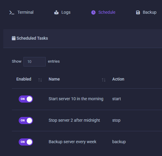

Hi, I’m having an issue were my server shutdowns every day at 12am. Has any one else had the same issue?
im on unraid 7.0.1. Using the latest version of the docker running a forge 1.21.1 Java server.
Did you check if you have set a schedule?
