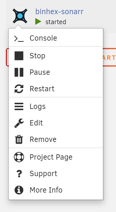

  2. After Upgrading to 6.12.3 when i click on most of my dockers (Binhex-sonarr, binhex-sabnzbd, and binhex-radarr) i've lost the ability to open WebUI? I can still direct open to the IP:port Is this something that needs to be enabled?
