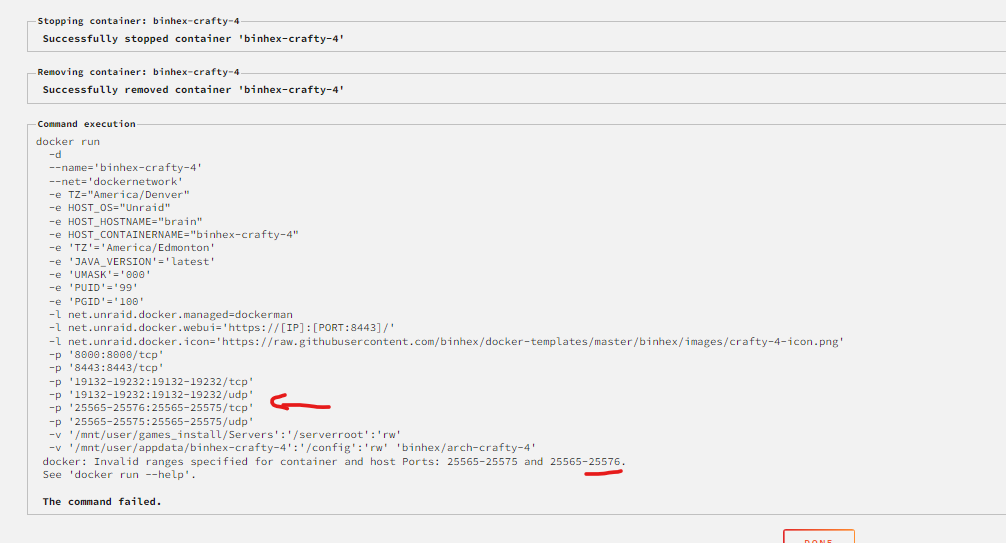

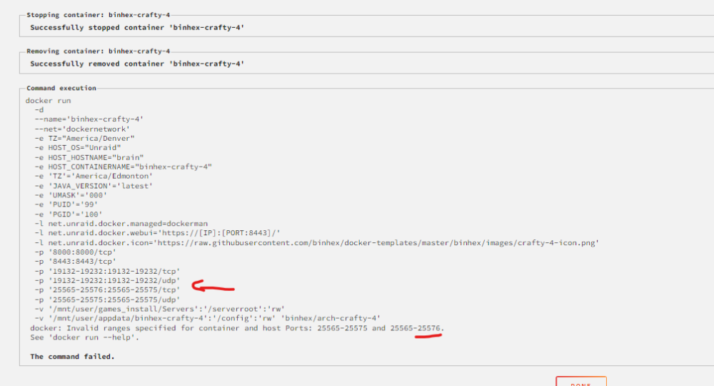

@binhex When I try to use a different port range it orphans the container.
image.thumb.png.4d5fd88e2eade46942c1df59f4f28785.pngimage.thumb.png.9dd5be41b3c6d0ee7e54206519051f45.png
this is incorrect, 25565-25576 cannot be mapped to 25565-25575 highlighted the incorrect port number range, do you see it?
Yes I thought this is where I would specify what ports I want.  I guess I have to delete the ports that come default and do my own mappings.
it is where you specify what ports you want, but you cannot have a larger range on the host side (left) compared with the container side (right), for example:-
this would work:- -p 2005-2015:25565-25575
why does it work?, cos the number of ports (10) is equal on both sides, access to the range of ports would then be via port 2005-2015
this does NOT work:- -p 2005-2020:25565-25575
why does it NOT work?, cos the number of ports on the host side is 15, but the number of ports on the container side is 10, they must be equal
now if the range is too large or too small on the container side, then yeah your only course of action is to completely delete the ports and create a brand new port, as you cannot change the container ports (right side) once defined.
