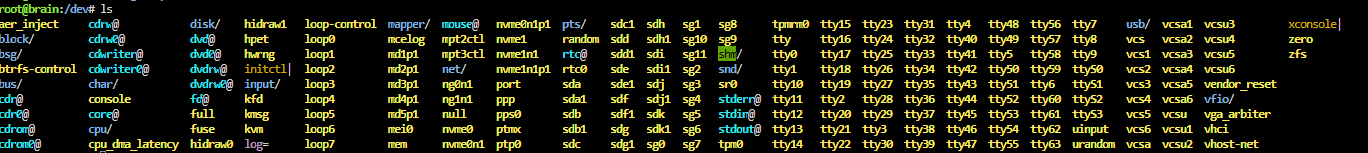

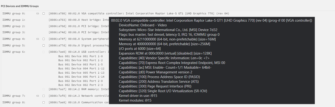

  11. I did the same thing. I think a few of us have a weird edge case with a docker (I have seen deluge mentioned), and upgrading.
  12. I've been having some issues after the latest update. 6.12.6. One of the issues I am having now is my /dev/dri has disappeared. Note: I do not have an HDMI dummy plug installed, I didn't have one prior to upgrade don't know if that matters. Note: I do not know if any bios settings got reset during reboots, it MIGHT be disabled in bios I can not check as I am remote for a while. System: 13700k with the 770 iGPU Radeon Card for VM The system devices tab shows my iGPU and that it is in the kernel. INTEL_GPU_TOP also shows no devices. When I install the SR_IOV plugin I get an error up top saying a process is still running and then eventually the GUI hangs. Don't know if that's related but there it is. Tried with both /boot/config/modprobe.d/i915.conf - empty file and /boot/config/modprobe.d/i915.conf - blacklist i915 root@brain:/dev# lsmod | grep -i 'i915' i915 2527232 1 iosf_mbi 20480 2 i915,intel_rapl_common drm_buddy 16384 2 amdgpu,i915 i2c_algo_bit 16384 2 amdgpu,i915 ttm 77824 3 amdgpu,drm_ttm_helper,i915 drm_display_helper 135168 2 amdgpu,i915 drm_kms_helper 167936 3 drm_display_helper,amdgpu,i915 intel_gtt 24576 1 i915 drm 495616 9 gpu_sched,drm_kms_helper,drm_display_helper,drm_buddy,amdgpu,drm_ttm_helper,i915,ttm video 61440 2 amdgpu,i915 i2c_core 86016 8 drm_kms_helper,i2c_algo_bit,drm_display_helper,i2c_smbus,amdgpu,i2c_i801,i915,drm backlight 20480 5 video,drm_display_helper,amdgpu,i915,drm root@brain:/dev# modinfo i915 filename: /lib/modules/6.1.64-Unraid/kernel/drivers/gpu/drm/i915/i915.ko.xz license: GPL and additional rights description: Intel Graphics author: Intel Corporation author: Tungsten Graphics, Inc. import_ns: DMA_BUF root@brain:/dev# lspci -k 00:00.0 Host bridge: Intel Corporation Device a703 (rev 01) DeviceName: Onboard - Other Subsystem: Micro-Star International Co., Ltd. [MSI] Device 7d32 00:01.0 PCI bridge: Intel Corporation Device a70d (rev 01) Subsystem: Micro-Star International Co., Ltd. [MSI] Device 7d32 Kernel driver in use: pcieport 00:02.0 VGA compatible controller: Intel Corporation Raptor Lake-S GT1 [UHD Graphics 770] (rev 04) DeviceName: Onboard - Video Subsystem: Micro-Star International Co., Ltd. [MSI] Device 7d32 Kernel driver in use: i915 Kernel modules: i915 00:06.0 PCI bridge: Intel Corporation Raptor Lake PCIe 4.0 Graphics Port (rev 01) Kernel driver in use: pcieport 00:08.0 System peripheral: Intel Corporation GNA Scoring Accelerator module (rev 01) DeviceName: Onboard - Other Current setup: INTEL_GPU_TOP installed, SR_IOV not installed, /dev/dri missing Thank you in advance to anyone looking at this. Derek brain-diagnostics-20231223-1641.zip
