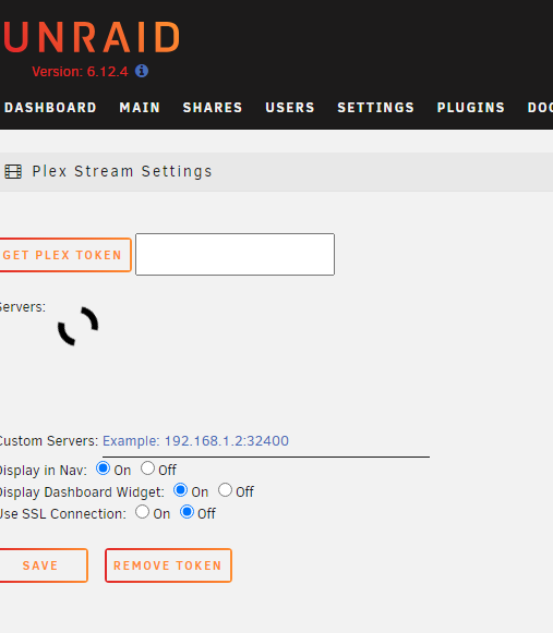

[Plugin] Plex Streams [Now supports Jellyfin and Emby]
Hello, Just installed on 6.12.4 and I'm having the same issue as iceperson above. The servers animation just spins and clicking on the Get Plex Token button doesn't do anything. I tried a different browser as well. Clicking on Save or Remove Token also loads a blank page. Also tried removing the plugin, restarting unraid, re-installing but no change. Thanks for the help.
