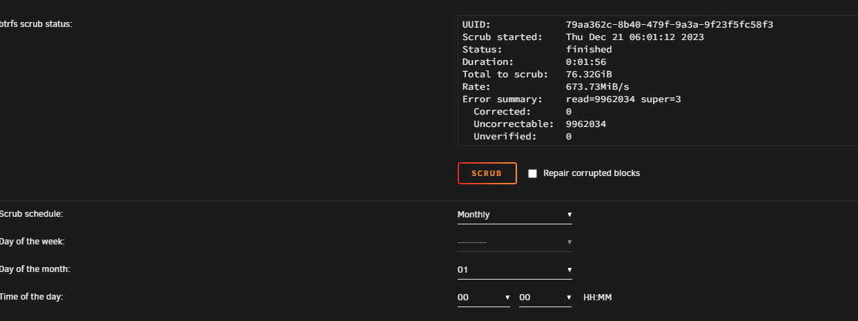

Tried running a scrub (and then a scrub with repair corrupted blocks) but unfortunately lots were uncorrectable:
Running btrfs dev stats /mnt/cache twice (with about a few minutes between running the command):
Tried running Fix Common Errors, but nothing.
Is nvme0n1p1 failing? If so, what steps should I take? I have them ran as a mirror.

One of the NVMe devices dropped offline, power cycle the server, not just reboot, to see if it comes back, if yes run another scrub.

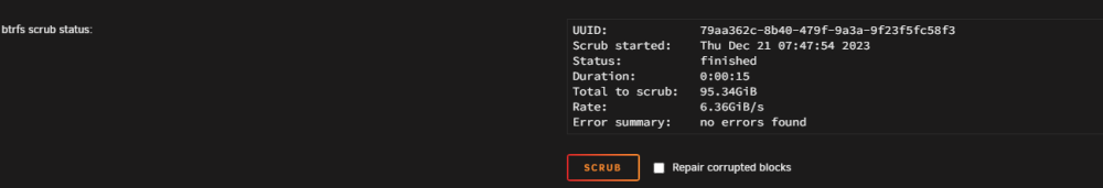

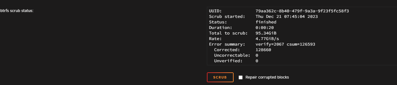

Was able to run another scrub and this time it was able to correct the errors.

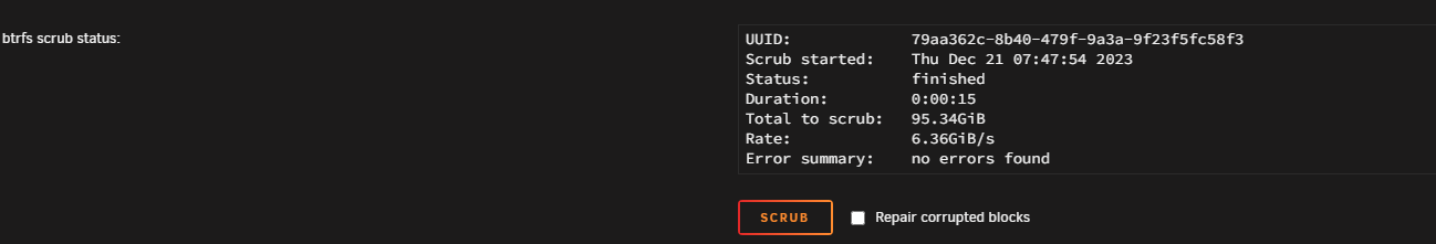

Ran another one and it seems good now.
