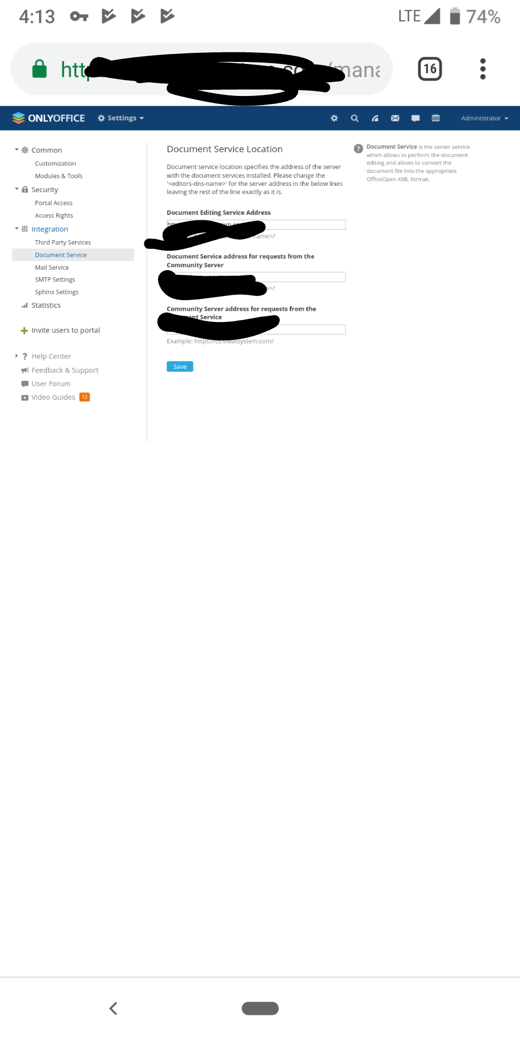

Installed both Onlyoffice Comunity and Document servers by default but cant edit any document online other then download it. Is there any settings I need to apply for Comunity server to talk to Document server so document cout be edited with OnlyOffice?
Here are some questions I need to ask
1.what is your unraid server internal ip
2.are you accessing it from the internal Network or the external Network
3.what are the configuration for the onlyoffice community edition server bridge (the page in the picture)
4.are you using reverse proxy?

I'm having a little trouble getting Onlyoffice to run. If i keep everything internal, it works perfectly. As soon as i switch everything for external access it stops working and i get a "<insert domain> refused to connect" error
Any ideas? I have confirmed that it can reach /web-apps/apps/api/documents/api.js?ver=9.6.4.736
I have both servers running in Docker, didn't mess with any port settings and both are reverse proxy'd through the Linuxserver.io Lets Encrypt container.
Anybody have an example of a working letsencrypt/nginx reverse proxy config for the Onlyoffice Community and Document servers they could share? I'm close, but when I go to open a document, it throws an unknown error. It's works locally, avoiding the proxy, though.
The onlyoffice CS and DS need it's own certificate because the the client need to be able to access both because when you edit a document it is just onlyoffice DS inside an iframe of an CS and because of https strict transport policy you need to install ssl certificate on both and in community server , set the document server location to your public address. Basicly CS and DS need to have ssl enabled with the certificate  from let's encrypt or else it will try to connect to each other using http protocol over https port which obviously not going to work and all it's port must be accessable from the external address, I done this with HAProxy
