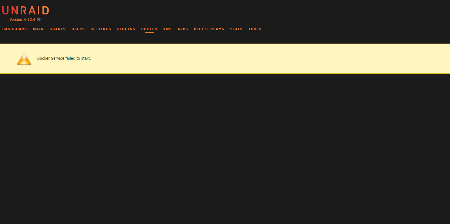

Been on 6.12.4 for a little over a week now with no problems, but noticed today my Docker tab said, "Docker Service failed to start".

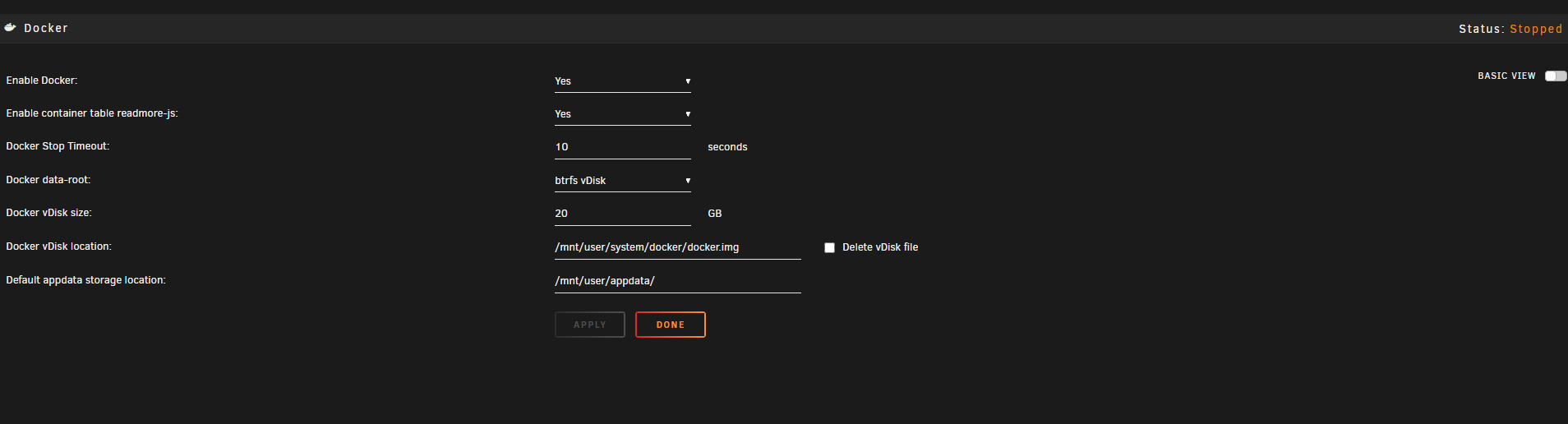

It doesn't have any errors on the docker tab
Settings > Docker

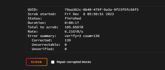

So, I followed the directions you outlined, and it reported some read write errors with my 1st nvme cache drive. I created a user script as outlined as well, as well as forced a reset of the stats. Then I ran a scrub and it was able to repair the errors :

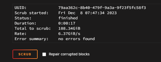

I followed the same steps and performed another scrub, but this time it reported no errors were found / none needed correction:
