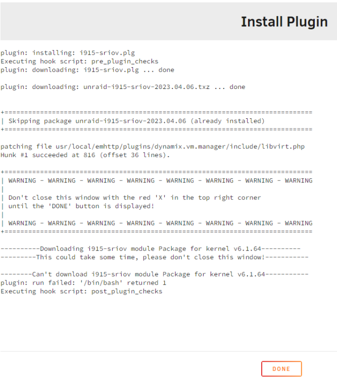

  • I have now adapted the plugin so that users are able to install it on Unraid 6.12.4 without any workarounds and to make sure that packages for upcoming Unraid versions are available. The new plug
  • I want to thank you for providing this solution and information in this thread! Was reading for a while now and fully managed to get iGPU passthrouh working yesterday.   My used Hardwar
  • For all who are in need of a plugin package for Unraid 6.12.4 here it is: i915-sriov-6.1.49-Unraid.txz i915-sriov-6.1.49-Unraid.txz.md5   To install them do the following:

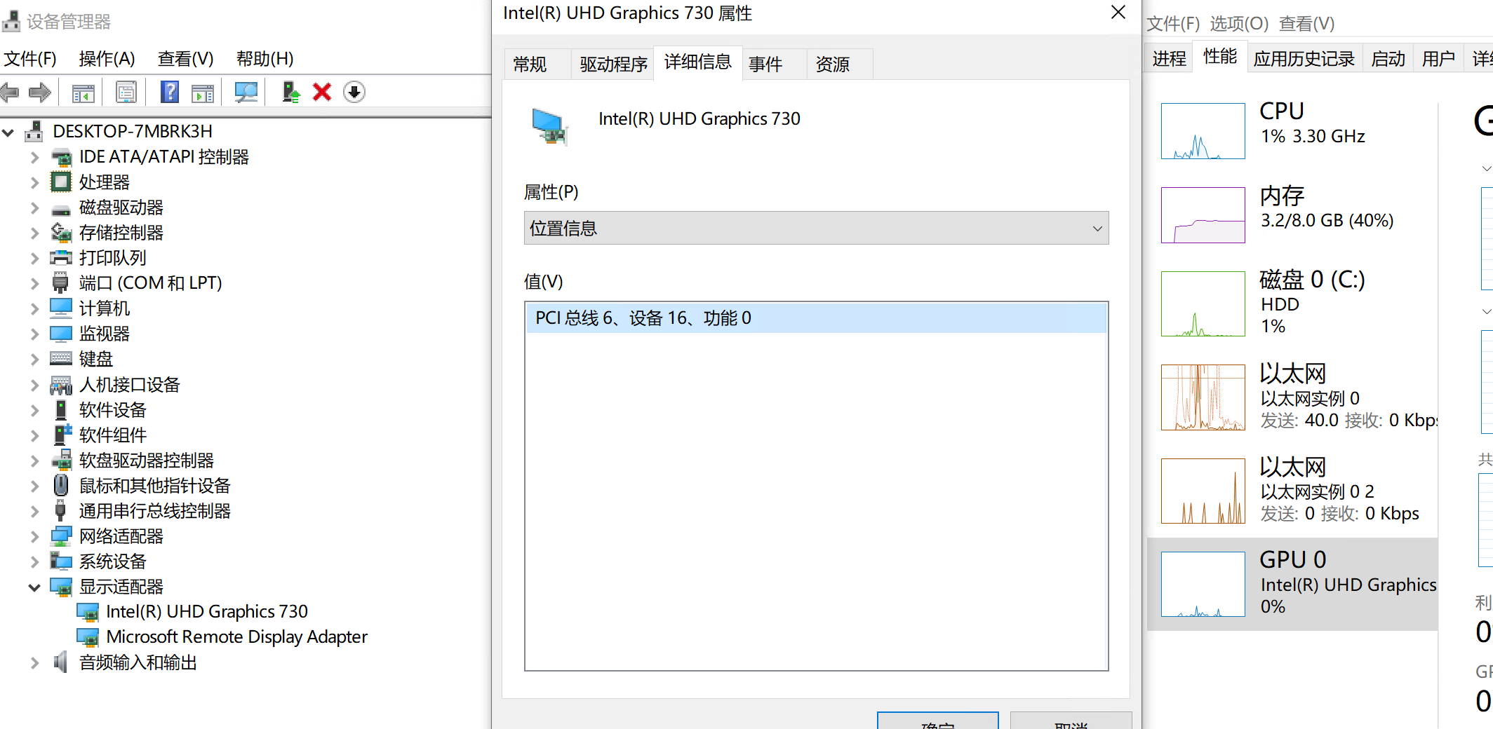

It is not true. Because the VM do not have a PF device, the VF pci address (like 0000:00:02.1) won't make the device work.
Then I changed the address to 0000:00:02.0, and the guest system recognized the graphics card and made it work.
So, I modify the the file /usr/local/emhttp/plugins/dynamix.vm.manager/include/libvirt.php: line 813 on every boot.
sed -i "s/\(strSpecialAddress.*\)\$gpu_function/\1\"0\"/" /usr/local/emhttp/plugins/dynamix.vm.manager/include/libvirt.php
Then the VM with iGPU VF works fine.
I think it is a bug for passthrough iGPU's PCI address.

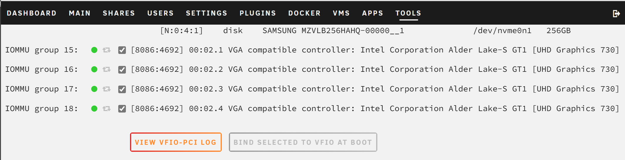

I guess the guest VM driver assumes that the card is 02.0. is there any think in lspci to indicate a child node.
What does lspci -Dnnmm provide as we may be able see that 02.1 is a child of 02.0 and write 02.0 to XML. same would be for 2.2, 2.3 etc.
# lspci -Dnnmm
0000:00:00.0 "Host bridge [0600]" "Intel Corporation [8086]" "Device [4630]" -r05 "" ""
0000:00:02.0 "VGA compatible controller [0300]" "Intel Corporation [8086]" "Device [4692]" -r0c "" ""
0000:00:02.1 "VGA compatible controller [0300]" "Intel Corporation [8086]" "Device [4692]" -r0c "" ""
0000:00:02.2 "VGA compatible controller [0300]" "Intel Corporation [8086]" "Device [4692]" -r0c "" ""
0000:00:02.3 "VGA compatible controller [0300]" "Intel Corporation [8086]" "Device [4692]" -r0c "" ""
0000:00:02.4 "VGA compatible controller [0300]" "Intel Corporation [8086]" "Device [4692]" -r0c "" ""
I test the address with 0000:06:10.0, and the VF also works fine in guest system.
  <driver name='vfio'/>
  <source>
    <address domain='0x0000' bus='0x00' slot='0x02' function='0x1'/>
  </source>
  <address type='pci' domain='0x0000' bus='0x06' slot='0x10' function='0x0'/>
</hostdev>
Then I shutdown the guest system and change the address to 0000:06:10.1, after reboot, the GPU device disappeared.
So for iGPU VFs, the function number of PCI address should be 0.
do i need to bind that IGPU to VFIO at boot? to make it work?
I did
1) in Bios enable sriov
2) Intel GPU TOP, can it be installed or not?
3) install i915-sriov Plugin from the link (for now) you provide
4) add echo 3 > /sys/devices/pci0000:00/0000:00:02.0/sriov_numvfs to go file
4) add /usr/local/sbin/vfio-pci to go file
5) reboot
iam here but nothing changed
6) The PF (00:02.0) could be used by Unraid host. And the VFs(00:02.x) are only used for passthrough to VMs
7) instal IGPU Intel driber in guestsystem win/linux
DO NOT do this. The IGPU 0000:00:02.0 should always use the i915 sriov module to make VFs work.
You should only bind VFs to vfio-pci.
