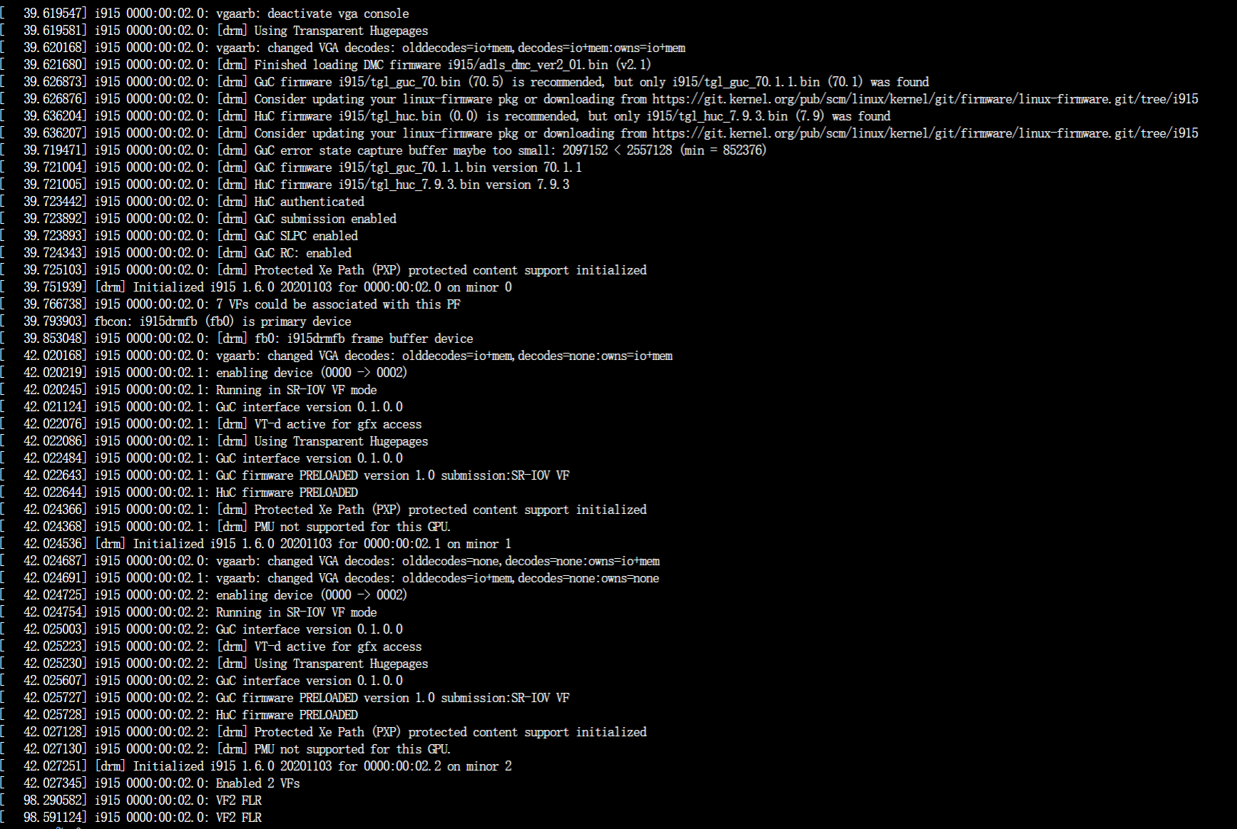

[   43.663221] i915 0000:00:02.1: GuC interface version 0.1.0.0
[   43.663869] i915 0000:00:02.1: IOV: Failed to get runtime info (-EPROTO)
[   43.669365] i915 0000:00:02.1: Device initialization failed (-71)
[   43.669368] i915: probe of 0000:00:02.1 failed with error -71
According these info from your dmesg, I can locate the error in running this function. It happens when not enough MMIO resources for SR-IOV.

Can you add "pci=realloc,assign-busses" to your boot kernel command line to have a try?
I tried. It's still exactly the same output.

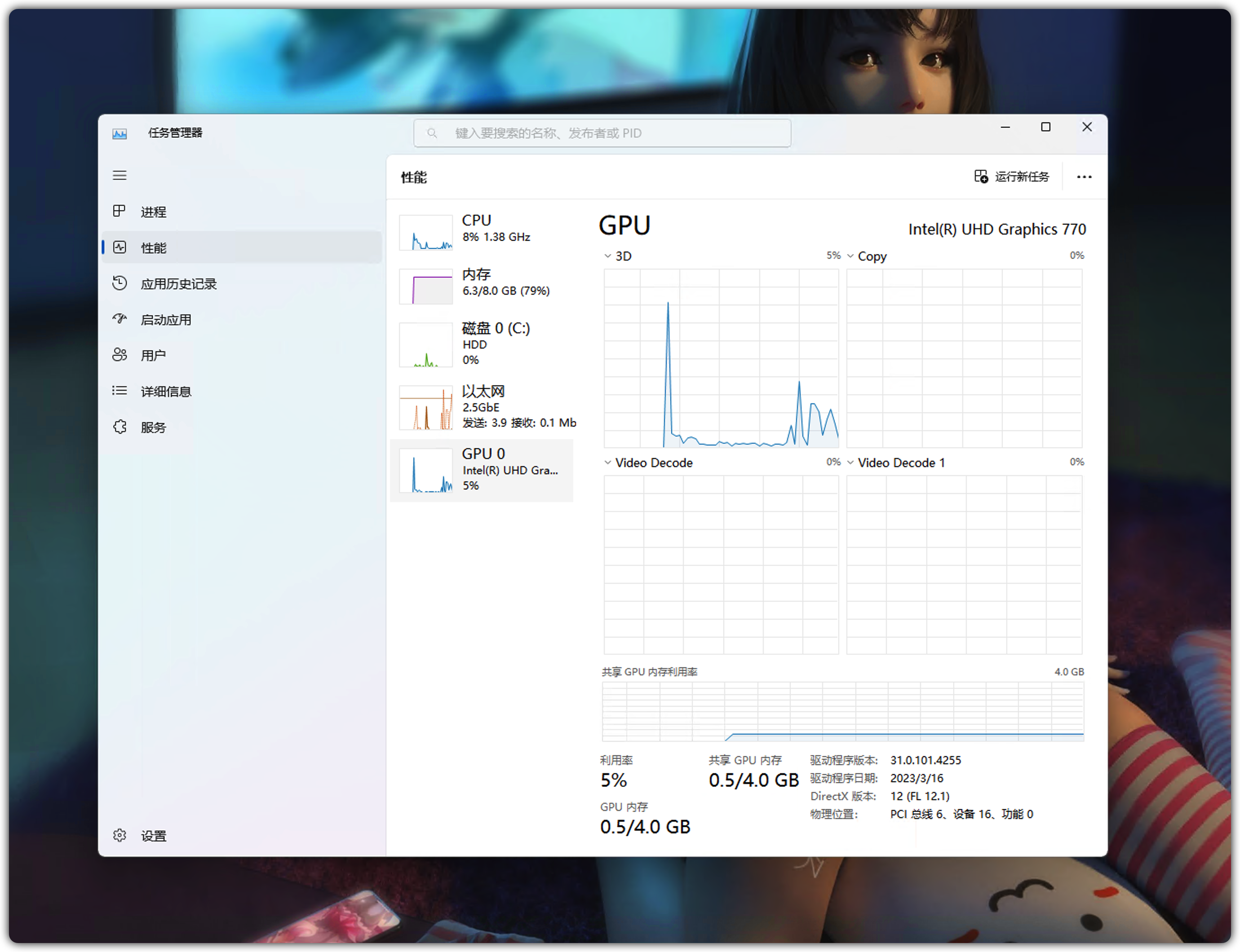

Thanks for the contribution of the author to the SR-IOV in unRaid. I started to use this plugin from the first verison till now. It's good for me to passthrough the gpu UHD 730 (i3-12100) to a windows 10 guest. However, after I updated the latest version (2023.04.06), troubles came to me. Simply, after I start the win10 guest with SR-IOV gpu, the host crashed within 10 min and can never restart untill I re-pluged the RAM. Now I have to uninstall the plugin and look forward to the next version.
Thanks anyway for this plug!

Thanks for your feedback. I am using i3-12100 too and do not meet this issue. And I can not figure out what happen to you now.
The 2023.04.06 updates only the setting page.
If it is convenient to you, would you please install the version 2023.04.01 with the URL below to have a test?
https://raw.githubusercontent.com/zhtengw/unraid-i915-sriov/525f2d329c6a7bea471964cf8f9364b2b8980ac5/i915-sriov.plg

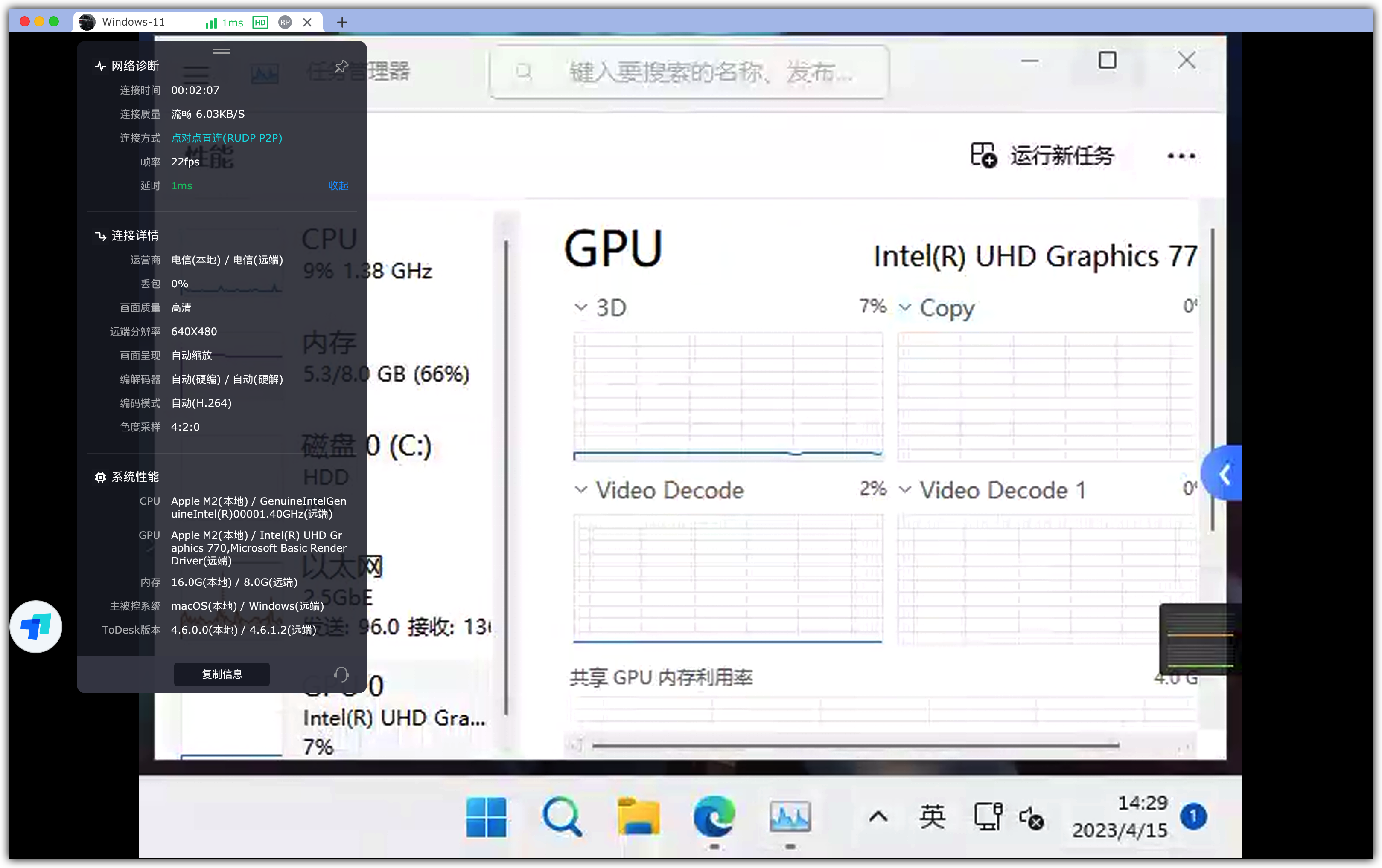

When I use SR-IOV the Intel XE graphics card is correctly detected. I'm using Teamviewer to view the screen, but the resolution is just 640x480. I assume this is because no physical screen is attached to adapt the resolution to. Any ideas how to resolve this?

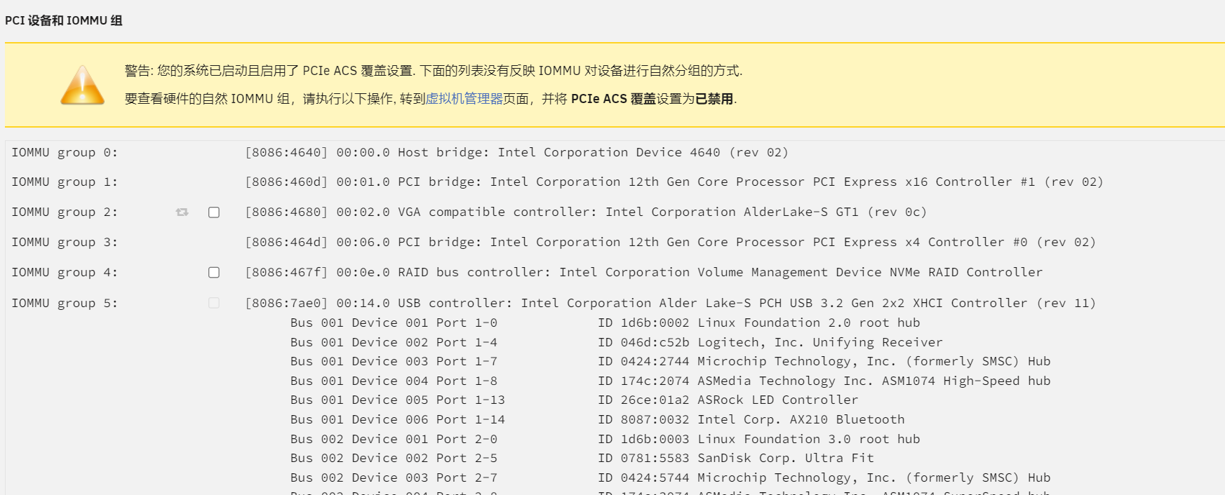

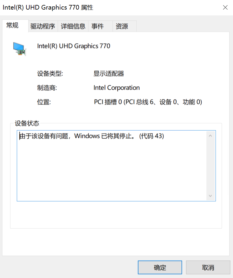

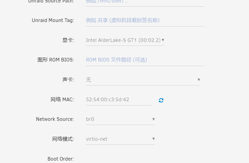

我是6.11.5版本,配置是13600+z690,虚拟机使用虚拟显卡,但是显示代码43,如附件,这是我的信息,麻烦看下是哪里配置错了?除了安装插件意外还需要在哪里设置吗?image.thumb.png.250226031a9f32d03b07edc5bb7325a4.png
你好,您的虚拟机类型是不是q35,改成i440fx看看行不行

中文大佬你好,请问这个插件的直通方案是不是无法输出?我尝试用显卡诱骗器,但还是除了mstsc远程外,其他远程方法都是640x480,除此之外没有其他问题。谢谢
unraid 6.12 rc2
unraid 6.12 rc2
你好,SR-IOV的虚拟显卡目前是没法显示输出的,用Windows自带的RDP服务可以保证不错的远程桌面体验,用mstsc或者其他支持rdp协议的远程桌面客户端都差不多的。VNC、向日葵这些体验就差一些了。

Tested the 1st version in plugin store.
After updated to 2023.04.06, windows guest gpu got error code 43.
Tried rollback to 2023.04.01, it's still code 43.
15 minutes ago, maxAtmin said:
12400 + Z690
unraid 6.11.5
Update:
Reinstall 2023.04.06, then install latest intel GPU driver in Windows 10 guest. The installation failed. But the SR-IOV gpu works after reboot.

Issue is VFIO check is completed before plugin is loaded so 2.1 and 2.2 don't exist. You don't need to bind them to VFIO.
For now suggest remove bindings from system devices.

Yes you can use SR-IOV but you dont need to bind the VFs to VFIO. Check for Hardware changes was added into rc3. Passthru of the vgpu will still work.
Sorry ignore my previous statements, it does look like the plugin is loaded before vfio is process. I will review the logs.
But removing binds should allow Auto start to work again. You don't need to bind gpus, but is recommended.
