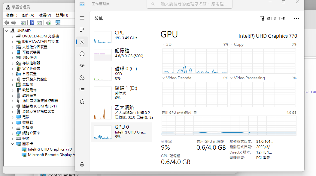

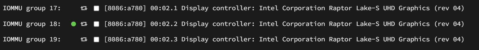

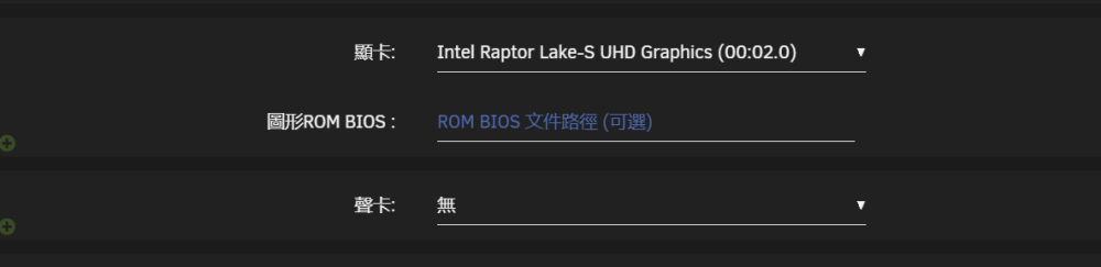

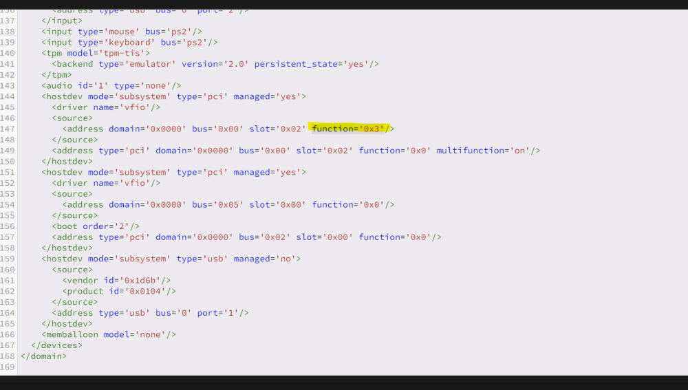

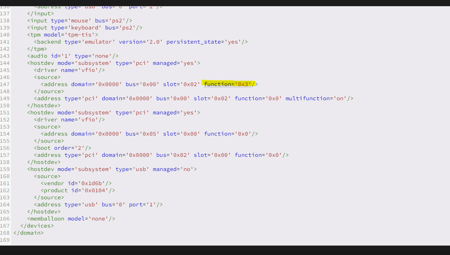

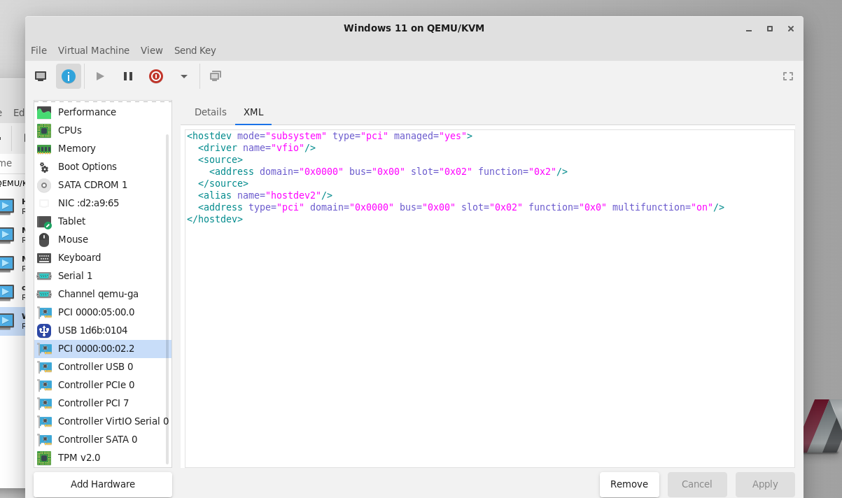

13th 13600k success
use virt-manager edit address
Edited by BHWang

1 hour ago, king-unraid said:
大佬,帮我看看,vfio-pci报错,也无法添加到虚拟机,报错"XML error: Invalid PCI address 0000:06:10.0. slot must be <= 0"
Processing 0000:00:02.1 8086:4626
Error: Device 0000:00:02.1 does not exist, unable to bind device
Processing 0000:00:02.2 8086:4626
Error: Device 0000:00:02.2 does not exist, unable to bind device
Processing 0000:00:02.3 8086:4626
Error: Device 0000:00:02.3 does not exist, unable to bind device
Processing 0000:00:02.4 8086:4626
Error: Device 0000:00:02.4 does not exist, unable to bind device
以下是dmesg |grep i915输出

22 hours ago, Acidcliff said:
Hey, it's amazing that you have brought it so far!
I've the following problem. When I try to bind one of the VFs (02.1) to the VM (Win 11) the iGPU does not seem to work (Code 43 in the device manager)
I'm running a 12600k on 6.11.5.
VFs are created and visible in device overview.
02.1 is bound to vfio at boot.
Any idea why it's not working?
    <graphics type='vnc' port='-1' autoport='yes' websocket='-1' listen='0.0.0.0' keymap='de'>
    </graphics>
    <audio id='1' type='none'/>
    <video>
    </video>
      <driver name='vfio'/>
      <source>
        <address domain='0x0000' bus='0x00' slot='0x02' function='0x1'/>
      </source>
      <address type='pci' domain='0x0000' bus='0x06' slot='0x10' function='0x0'/>
    </hostdev>
Loading config from /boot/config/vfio-pci.cfg
BIND=0000:00:02.1|8086:4680
Processing 0000:00:02.1 8086:4680
vfio-pci binding complete
Devices listed in /sys/bus/pci/drivers/vfio-pci:
Vendor:Device 8086:4680 found at 0000:00:02.1
IOMMU group members (sans bridges):
/sys/bus/pci/devices/0000:00:02.1/iommu_group/devices/0000:00:02.1
Binding...
0000:00:02.1 already bound to vfio-pci
Successfully bound the device 8086:4680 at 0000:00:02.1 to vfio-pci
lrwxrwxrwx 1 root root    0 Mar 28 16:01 0000:00:02.1 -> ../../../../devices/pci0000:00/0000:00:02.1
Yay I finally got it working!!!
Tried everything: Reinstalling the plugin, intel_gpu_top, using the modified kernel instead of the addon...
But the error 43 always remained.
The solution was the following:
Although I already had the intel GPU driver installed, I had to reinstall it with the option for "clean install" marked (otherwise it didnt't work). After the reinstall everything worked as a charm
I'm finally able to run my Win11 VM on VF 2.1 with Parsec (using the Virtual Display Driver) (don't forget to remove the Red Hat Display Driver)
