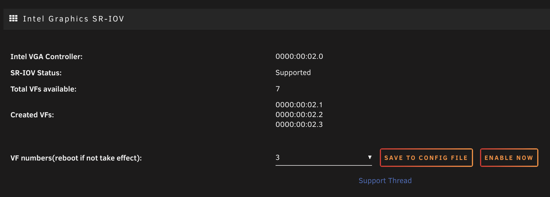

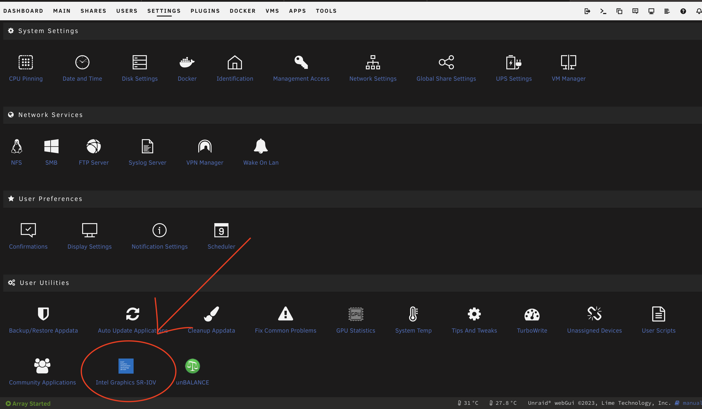

  1. It should be under settings, I'm not sure what causes it to be there as it showed for a bit even when the plugin was not installed during the upgrade.

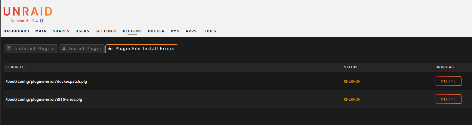

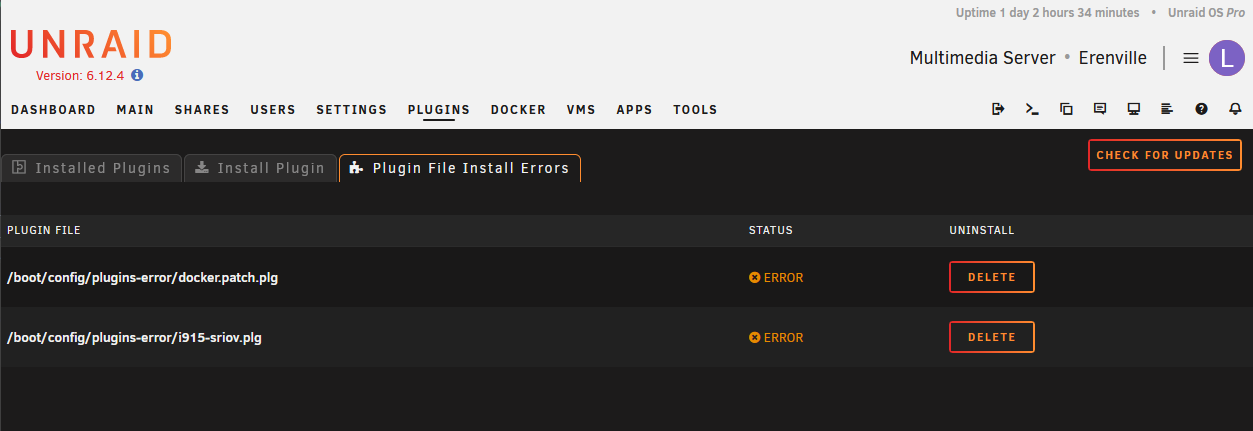

  3. Yep, you're right, it's right there under errors, don't know how I've never noticed that tab before, I'm guessing it only exists when ther are errors...

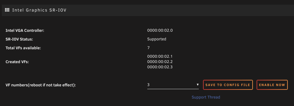

  4. Thanks, I went to try this last night, but was having problems mounting any of my shares from my windows PC (to then copy onto the boot drive in terminal after), it's working from my office PC over my wiregaurd connection, so I've dropped them on now ready. Will have another shot at this tonight and let you know how I get on. I already had the plugin installed from 6.12.3, it's not showing in my plugins list, but it's still on the settings page, this isn't going to cause any issues when I go to install the plugin again will it? If it thinks it's already installed (from the old version) I'm guessing I would need to delete it off my boot drive and reboot first
  5. So just to confirm, if I've alredy updated to 6.12.4 the best way is to downgrade unraid and follow the original steps?
  6. I installed the plugin earlier this week, just before is appeared on CA Since then, my Plex and Fileflows containers can't use quicksync anymore, any flows that need transcoding are failing with: [WARN] -> Cant process '/usr/local/bin/ffmpeg -loglevel error -f lavfi -i color=black:s=1080x1080 -vframes 1 -an -c:v hevc_nvenc -f null -': [hevc_nvenc @ 0x55702636efc0] Cannot load libcuda.so.1 Error initializing output stream 0:0 -- Error while opening encoder for output stream #0:0 - maybe incorrect parameters such as bit_rate, rate, width or height And Plex is now hammering my CPU directly for any HW transcode streams. Is there anything I need to change in the params or individual configs for plex/fileflows so they're using the correct device(s)? They both currently have --device=/dev/dri in the extra params which was working before I split out the device. (I'm on an i5-12600K) *EDIT* - Just saw the post about someone with the plex issue and they 6.11.5 fix. I'll try it this evening and see if it fixed file flows as well. Would it be worth swapping to the CA version, or do they pull from the same place? I did update it a couple of days ago but not sure if they're in sync or not.
