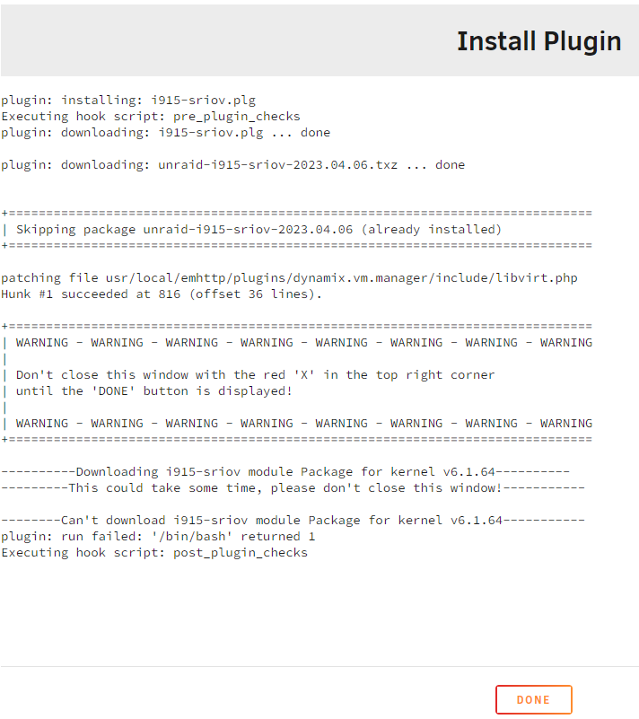

Is this working with 6.12.6? i keep getting below when i try to download the plugin
----------Downloading i915-sriov module Package for kernel v6.1.64----------
---------This could take some time, please don't close this window!-----------
--------Can't download i915-sriov module Package for kernel v6.1.64-----------
plugin: run failed: '/bin/bash' returned 1 Executing hook script: post_plugin_checks
You need to use the updated version from here:

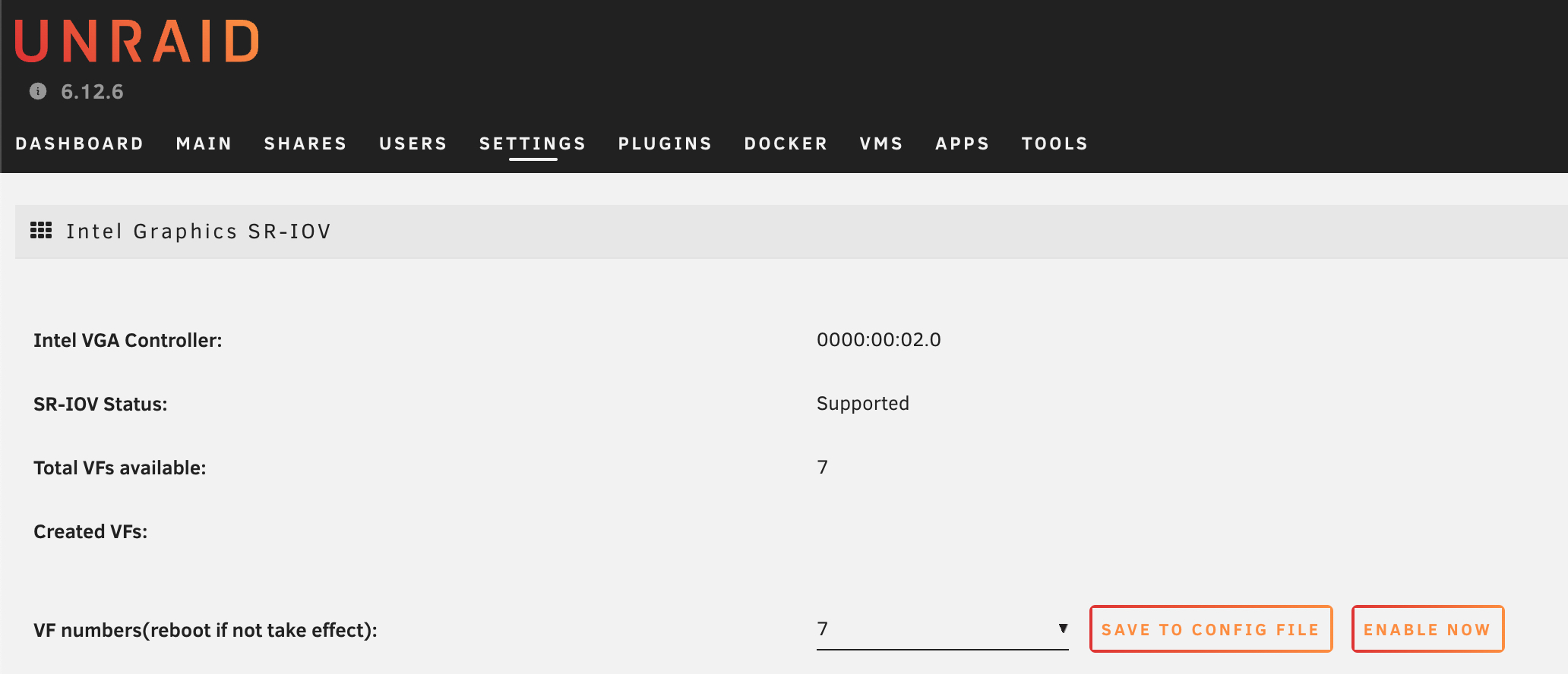

Great! that installed! but now i can seem to get it to add any VFs, no matter what i change, or clicking enable, i just stays like this, and i cant see any added VFs in the VMs setup
you should set the VF Numbers, hit save ... and then
you did a reboot like its stated here ?
yep i've rebooted and no joy, do i just hit enable now, or save to config then enable? I've done both before a restart, and each on their own before a restart and none of the 3 have worked
Edited by Tpole

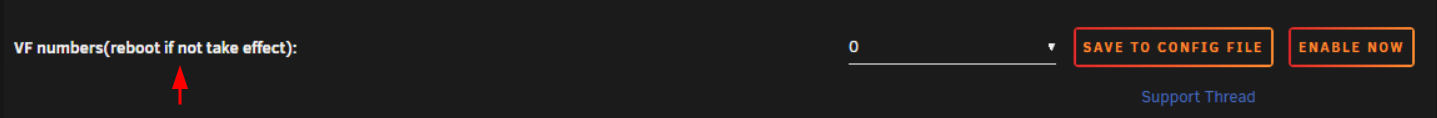

Hello,
i got the same in my Unraid 6.12.6
Got a 12th Gen Intel® Core™ i3-12100
What ever i try, every combination, several restarts, its sticking to 0 and "enable now".
Who has an idea how to use this plugin?
Did you check `dmesg`?
I am not familiar with Linux, but I did put the command to the unraids terminal.
That's the result:
(just like the last page of a lot more messages)

5 hours ago, Commerzpunk said:
Hello,
I still havent managed to get this to work as well, so any help on this would be great!
Do you have any active vfio binds for the igpu? I think I had this problem before I unbound everything
That was the solution for me!
Go to the top menu, tools, system devices, unbind the igpu. Reboot, and the plugin works. :)
No, its not. As soon as I bind the igpu again after reboot its not working again.
Same as in the screenshots above. Always 0.
Who can help please? I relly like to use my igpu in my VMs. :(
Edited by Commerzpunk
Take my tips with a grain of salt but do you need to bind it at all? I just leave everything unbound.

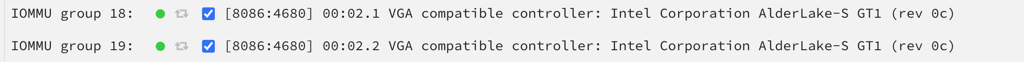

I was able to successfully install this plugin and (unlike other recent commenters) successfully set the VFs number.
However I don't really understand what these virtual functions are or how many I need. I am just trying to pass my 12600k iGpu through to a windows VM (top priority) and if possible allow to also be used by my plex docker. If the simultaneous use by plex docker is not possible, then I can just run the plex server in the windows VM.
When I activate 1, 4, or 7 VFs I get the same error in logs:
kernel: i915 0000:00:02.1: [drm] *ERROR* tlb invalidation response timed out for seqno 23
From the VM logs I get this:

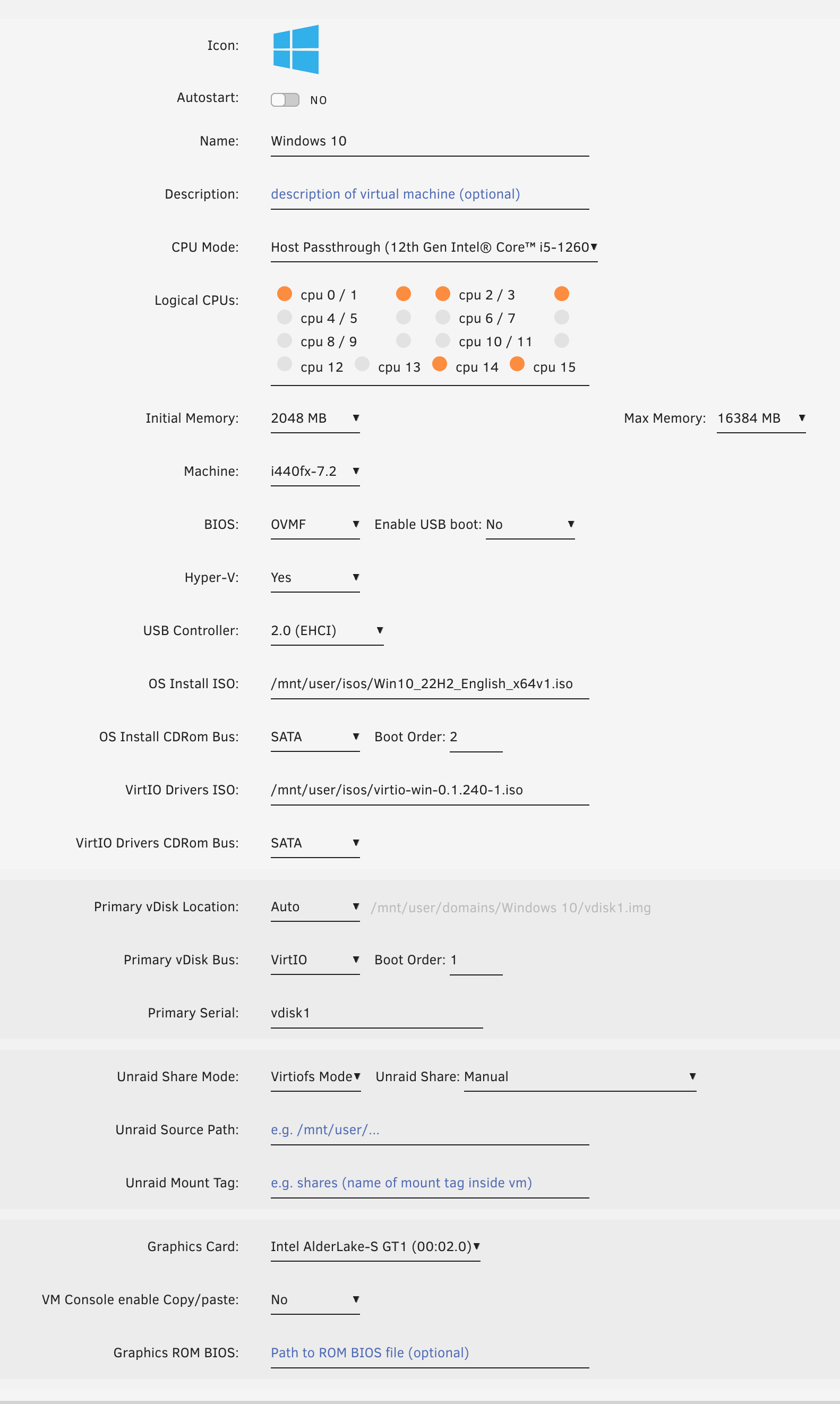

Here are the settings I used for the VM (see attached image).
No idea what to do here but would super appreciate any help!!

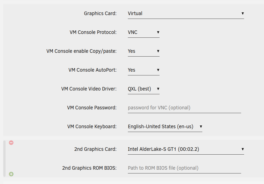

@WobbleBobble2 In your VM settings, change the graphics card (near the bottom of your screenshot) from 00:02.0 to one of the other functions (e.g. 00:02.1). 00:02.0 is reserved for the system itself and must not be used by a VM. Also make sure that each VM you want to pass the graphics card through to is using a different one (e.g. 00:02.1 for this VM, 00:02.2 for another VM, etc).
Using it in a Plex Docker should work fine. I've got a Plex container that has transcoding enabled, plus an Unmanic container that transcodes antenna TV recordings from MPEG2 to H.265, and I'm also using the iGPU in a Windows Server 2022 VM for Blue Iris at the same time. All works fine.
Thank you for the quick reply! Ok so I set the number of VFs to one in the SR-IOV plugin, then selected 00:02.1 in the VM and that seems to have resolved the first error in my original post, which is in the main unraid log.
However the second error still shows up in the VM log and the VM won't start:
-device '{"driver":"vfio-pci","host":"0000:00:02.1","id":"hostdev0","bus":"pci.6","addr":"0x10"}' \
-sandbox on,obsolete=deny,elevateprivileges=deny,spawn=deny,resourcecontrol=deny \
-msg timestamp=on
char device redirected to /dev/pts/1 (label charserial0)
2024-02-06T03:13:40.767622Z qemu-system-x86_64: VFIO_MAP_DMA failed: Invalid argument
2024-02-06T03:13:40.767677Z qemu-system-x86_64: vfio_dma_map(0x14942d228c00, 0x381800000000, 0x20000000, 0x14940b000000) = -2 (No such file or directory)
2024-02-06T03:13:40.823130Z qemu-system-x86_64: VFIO_MAP_DMA failed: Invalid argument
2024-02-06T03:13:40.823146Z qemu-system-x86_64: vfio_dma_map(0x14942d228c00, 0x381800000000, 0x20000000, 0x14940b000000) = -22 (Invalid argument)
2024-02-06T03:13:42.798137Z qemu-system-x86_64: VFIO_MAP_DMA failed: Invalid argument
2024-02-06T03:13:42.798242Z qemu-system-x86_64: vfio_dma_map(0x14942d228c00, 0x381800000000, 0x20000000, 0x14940b000000) = -22 (Invalid argument)
2024-02-06T03:13:42.835529Z qemu-system-x86_64: VFIO_MAP_DMA failed: Invalid argument
2024-02-06T03:13:42.835550Z qemu-system-x86_64: vfio_dma_map(0x14942d228c00, 0x381800000000, 0x20000000, 0x14940b000000) = -22 (Invalid argument)

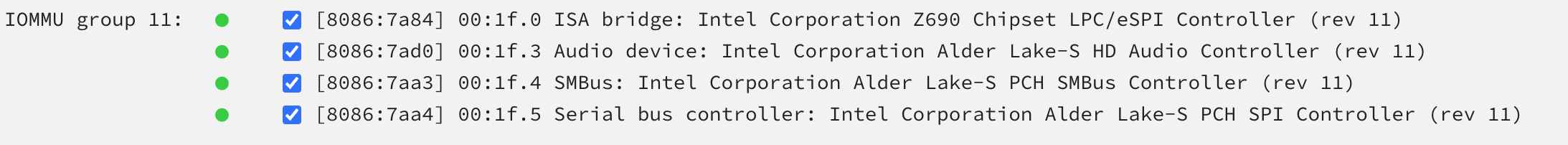

Also wanted to add a few more details as I am still getting the same VFIO_dma_map errors:
1. I am able to successfully get the 2 VFs (02.1 and 02.2) to show up in settings > system devices in their own IOMMU groups and bind them to VFIO at boot.
2. The alder lake sound card cannot be separated into its own IOMMU group for my motherboard, so it's in a group with the ISA bridge, SMBus, and Serial Bus.
3. I double checked that the drive my domains folder is in still has plenty of space (another person with the VFIO_dma_map error encountered this)
4. I thought the error might have something to do with me disabling the sound card in UEFI, but I re-enabled audio and got the same error.
5. I also tried enabling & disabling multi-monitor igpu setting in UEFI and it had no effect.
If you are having trouble getting the new VFs to show up make sure you haven't bound the primary VF 02.0 to VFIO at boot as this will prevent the new VFs from showing up.
I'm posting the full VM log here along with my diagnostics in case anyone might be able to help:

It appears that I am having problems downloading i915-sriov module Package for kernel v6.1.64
It fails really quickly and just complains that it cannot download and the install does not complete.
I am running UnRAID 6.12.6
Are you using the newer version from this thread? See the "recommended post" at the top. The version in the apps section in Unraid does not work properly with newer Unraid versions.
