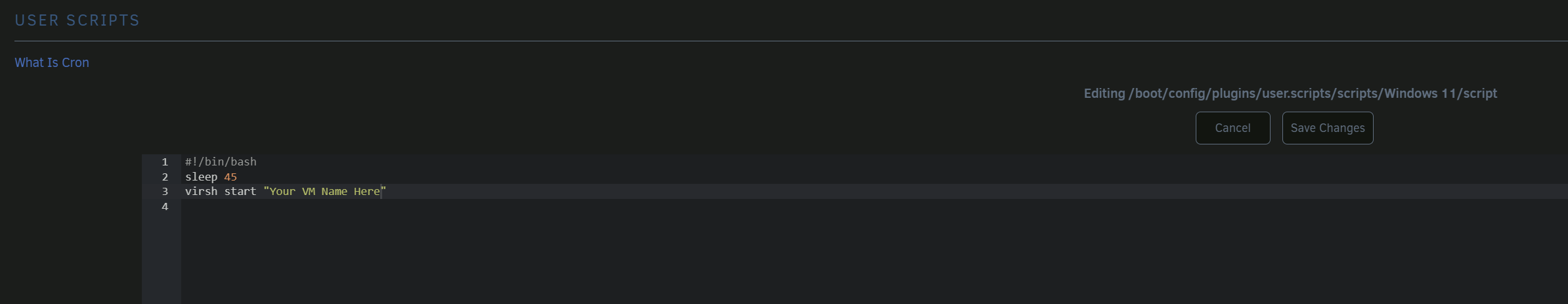

add another userscript to delay your VM autostart
#!/bin/bash
sleep 45
virsh start "Your VM Name Here"
Thank you, sir.

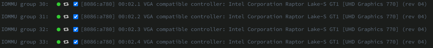

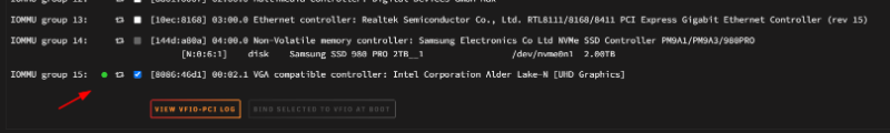

On 10/31/2023 at 4:10 PM, domrockt said:
nope it is not like you imagine!!
You have a real IGPU that is device 00.02.00
this is automaticly used by Unraid as a docker IGPU
you need the Intel TOP plugin to work with Plex.
your two VF's igpus can be passed trough to VM's and need to be stubbed like you have.
I understand, you mean that in addition to the virtualized GPUs 00:02.1 and 00:02.2, I also have a real GPU, 00.02.00, which is used on the host machine. The virtualized GPUs, 00:02.1 and 00:02.2, are for the virtual machines to perform GPU passthrough. Thank you for your explanation.
Edited by coderZoe
5 minutes ago, coderZoe said:
Technically they're all virtualized :P
When SR-IOV is enabled, all three are virtual functions. There's nothing different about virtual function 0 other than the fact that the driver on the host uses it as its display by default. The physical card no longer appears as a PCIe device when SR-IOV is enabled since all access to it is now via the virtual functions.
the "no longer appears" Part is not true, its confusing enough but all cars are visible 00:02.0 <-- is the real IGPU when i bind it to VFIO the VFs disapear.
i did not bind it
Edited by domrockt

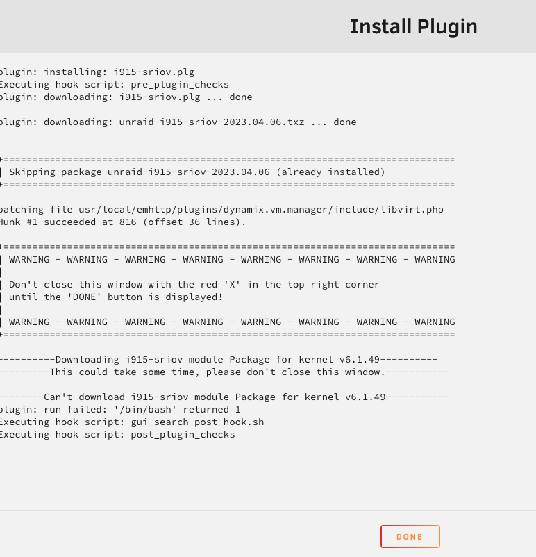

On 9/24/2023 at 8:43 AM, m0eak said:
Make sure that you are on Unraid 6.12.3 and that you have the SR-IOV plugin from @zhtengw installed
But i couldn't install SR-IOV plugin from @zhtengw, because it say Can't download i915-sriov module Package for kernel v6.1.49, how to force install this plugin?
Should these two files be copied as is, or extracted first?
7 hours ago, frodr said:
extracted
extracted
17 hours ago, domrockt said:
extracted
Thanks. I have to ask again. Is it the 2 files
"slack-desc"
"i915.ko.xz"
only, or the directories "install" and "lib"?
Edited by frodr
this is the correct way

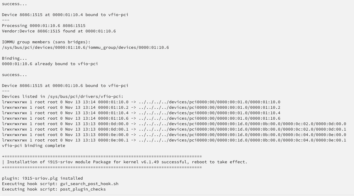

I followed these steps, but couldn´t get it going.
I copied the directories:
"install" and "lib", as well as just the files
"slack-desc"
"i915.ko.xz"
I got this error message installing the plugin:
861109869_Screenshot2023-11-09at22_06_33.thumb.png.ed6544d40622002f50fd3fb3dfd31928.png
I guess a make some stupid mistake with the files to be copied. (Yes, I have started Linux beginners crash course. I shout when finished......)
// Frode

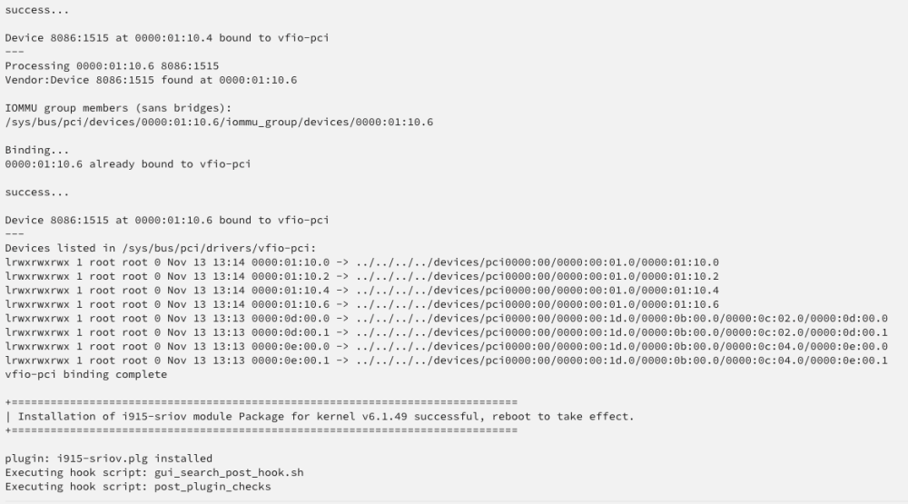

"slack-desc"
"i915.ko.xz"
// Frode

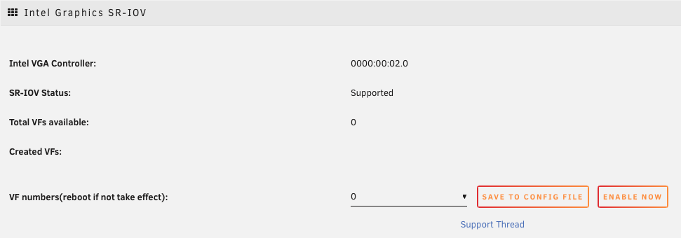

I followed the steps and could install the plugin successfully.
378297399_Screenshot2023-11-13at13_17_18.thumb.png.2634a86cdd111cf3ed726dd74c9fc5cd.png
After re-booting I could not set anything in the plugin
Setting up number of VF´s, etc. before rebooting just resulted in the same plugin as above.
A hint what I did wrong would be great.
// Frode
Edited by frodr

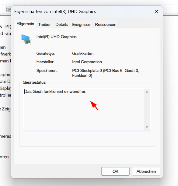

after some small tests here i have no success, gpu recognized, driver installed, but looks like its not starting in the VM.
also no Parsec, no hw video decode, etc ...
may anyone an idea, card is bound to vfio
passed to a win 11 pro VM (installed gpu drivers, tested with win update defaults and latest 31.0.101.4972)
but looking deeper, device not started
Hardware is a ASRock N100m Board
for a Tipp, thanks ahead ;)
is an HDMI cable connected? could be that some boards realy want a Dummy Plug or an actual Monitor connected.
not yet, thanks for the hint, i ll give that a try ;)
