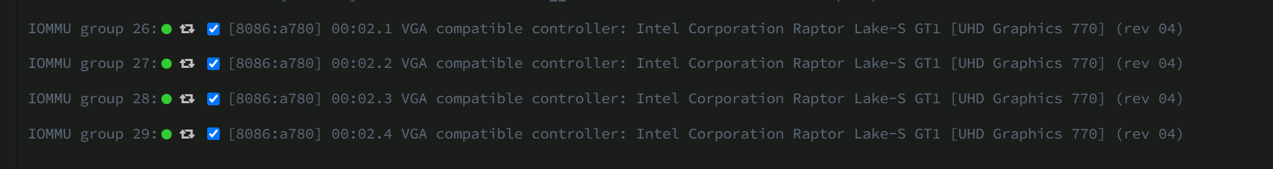

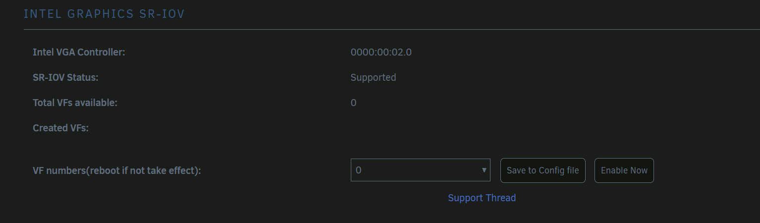

no VFs detected , went your route.

Wait, I have found the cause of the issue, give me a few minutes. The activation from the module changed slightly.
@domrockt please execute this command once from the command line:
sed -i '/  modprobe i915 enable_guc=7/ s/.*/  modprobe i915 enable_guc=3 max_vfs=7/' /boot/config/plugins/i915-sriov.plg
and reboot after that.
If that also does not work please post your Diagnostics.

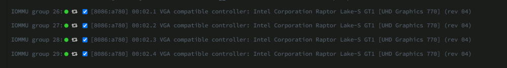

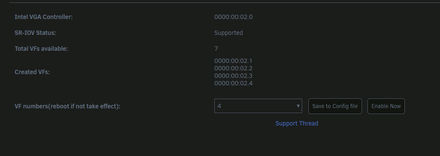

Yes it works, thank you very much!!

Works like a charm. I can play Diablo in Win11 VM again. :)
Thank you very much.

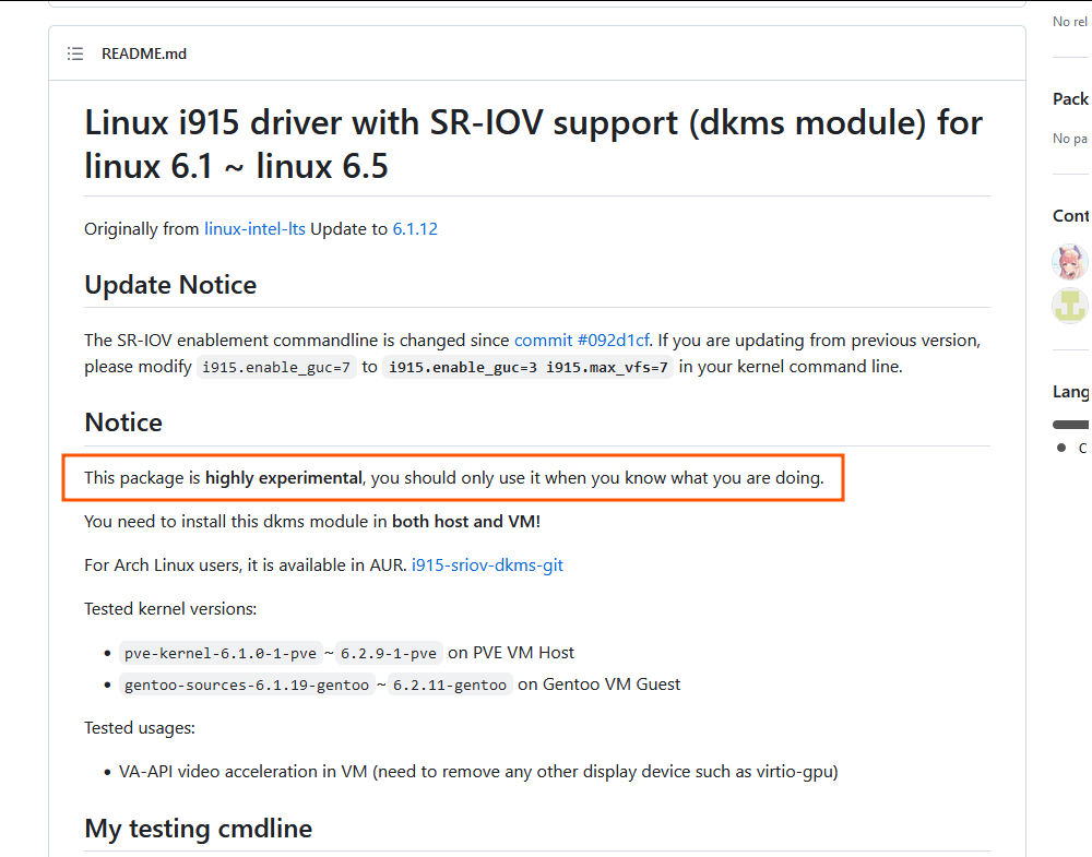

I would recommend for both of you that you consult the Issue tracker on GitHub from which the plugins is based on: Click
Search for something like "Parsec" or "The host encoder failed"...
...and please always remember what the README.md from the repository says:
Hold my Beer xD , i had it working back in 6.12.3 , afaik Sunshine worked fine, parsec worked too. I had to remove all other Displays and add an Virtual one like Amyuni USB Mobile Monitor and something else.. maybe a script that startet that VirtMonitor. its been a while didnt needed that for that long hab my 3060 working for that.
