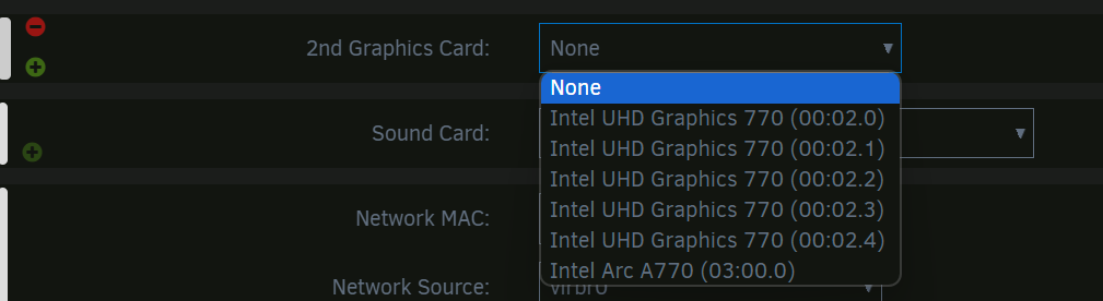

Hey guys, I'm trying to understand the purpose of this driver/plugin.
Will this basically allow me to pass through my IGPU to my VM and docker at the same time, kinda like the Intel GVT-g plugin?
Yes, but the definite answer can give @domrockt
i asked the same question a few pages earlier... here. Check the reply a few posts later.

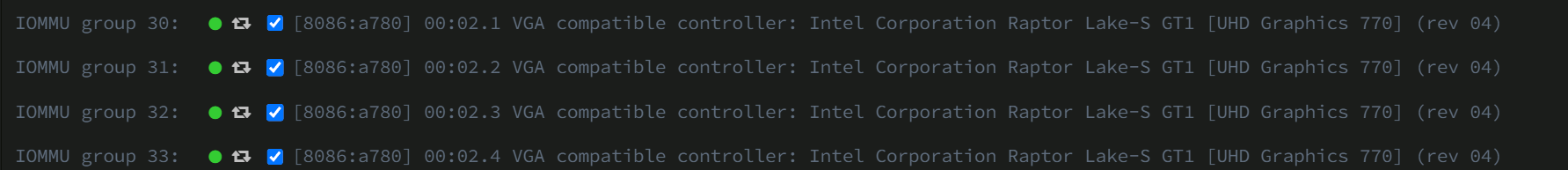

in Short, yes exactly like GVT-g
The main IGPU is unassigned for VFIO and is in use by docker
00:02.0 VGA compatible controller: Intel Corporation Raptor Lake-S GT1 [UHD Graphics 770] (rev 04)
the VF's are bound to VFIO and can be used in VM's
Edited by domrockt

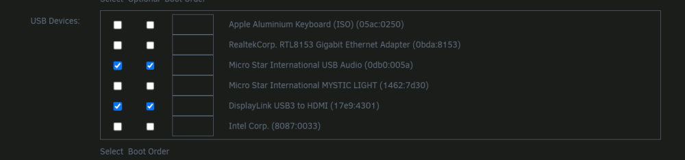

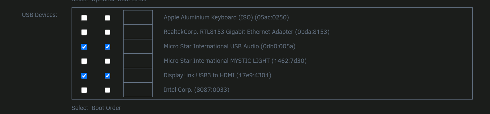

But to be clear the VM's can't use the HDMI/DP outputs on the iGPU correct?

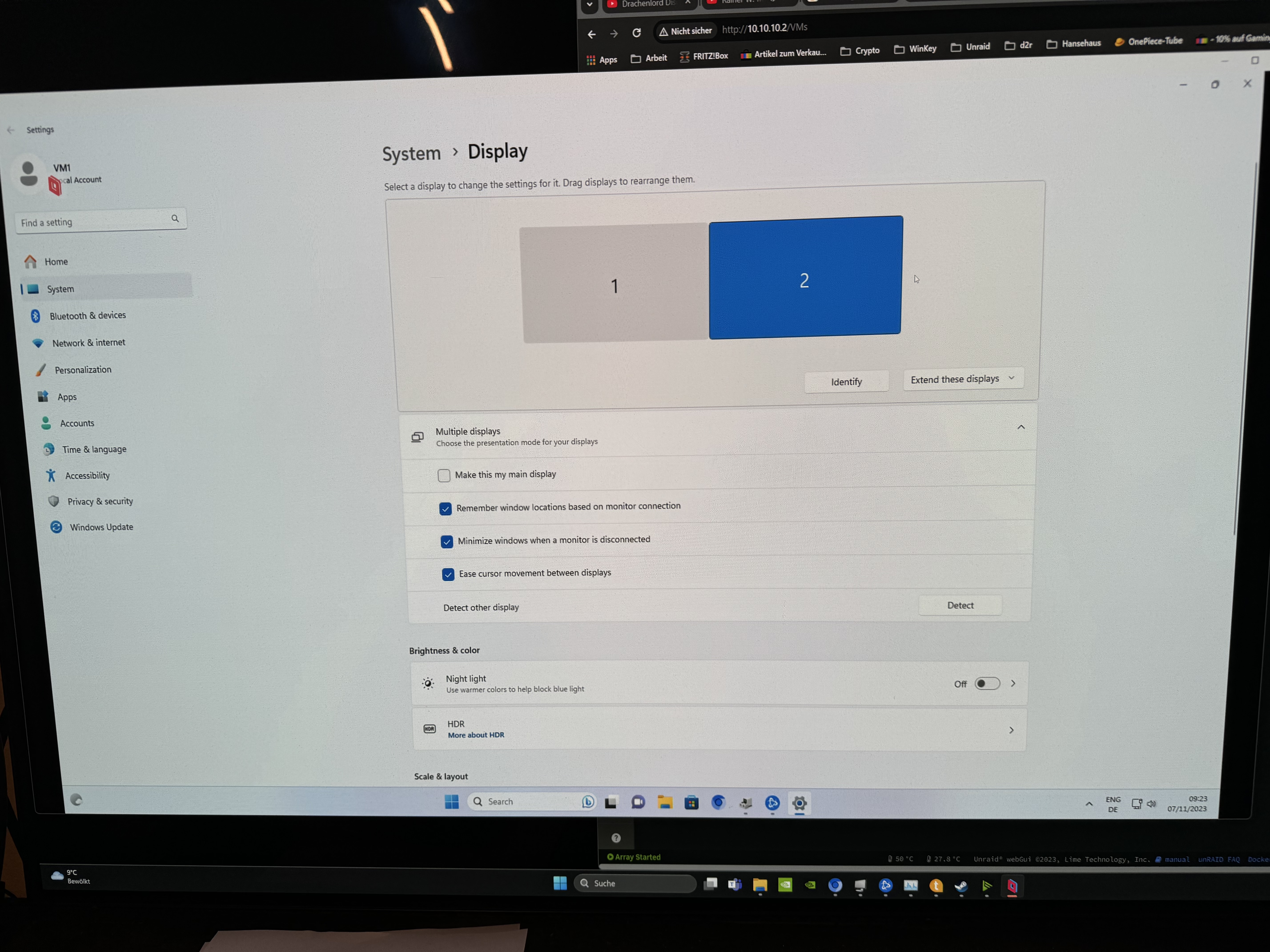

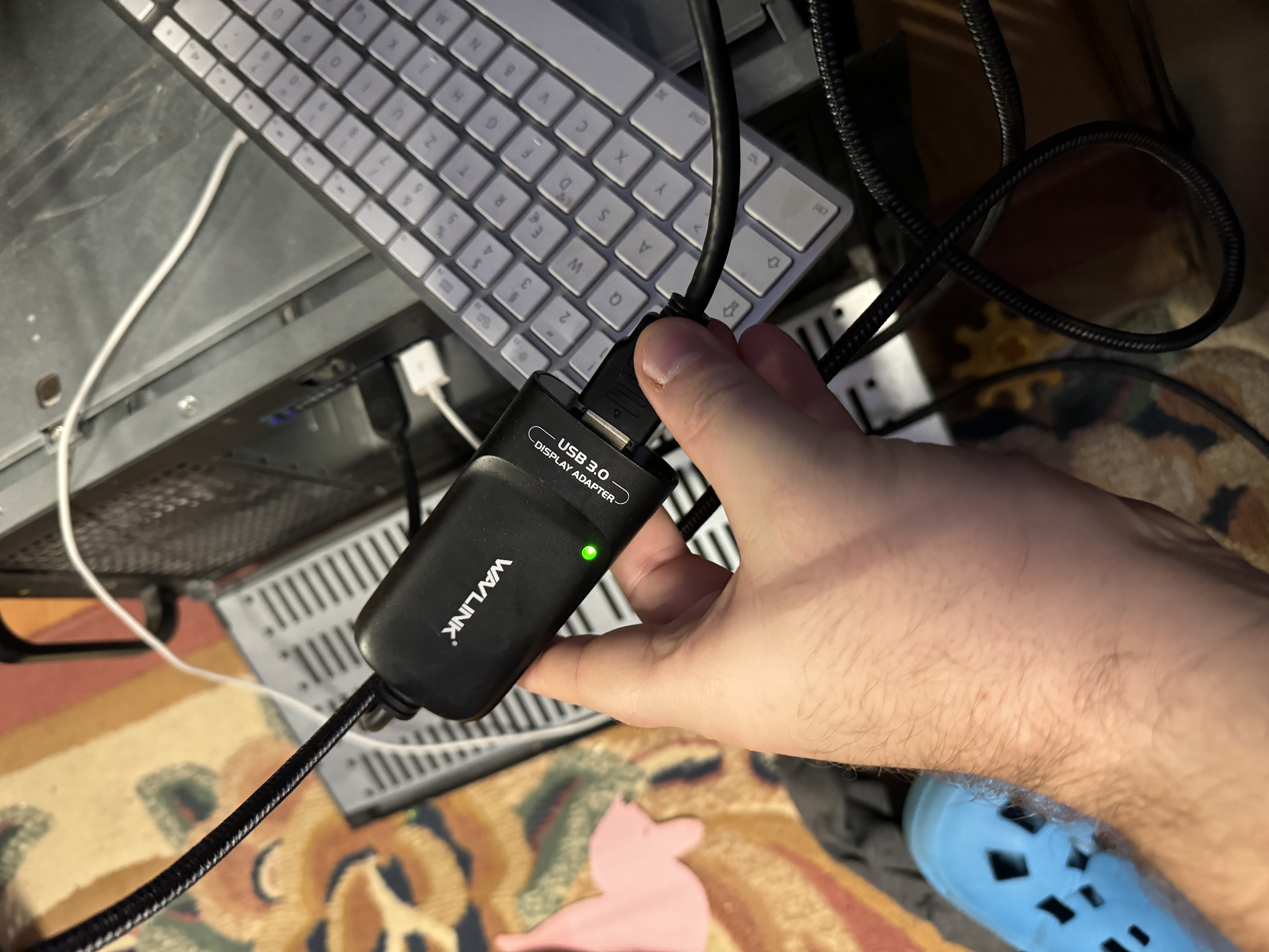

yes but you could pass trough an usb to hdmi dongle and use that as Display Output.
wavlink USB 3.0 zu HDMI Adapter... https://www.amazon.de/dp/B076SX73LY?ref=ppx_pop_mob_ap_share
Like an Laptop per se
had this Running with my windows paravirtualizing Adventures.
i splittet my old 3090 in two and used that dongle in the hyperV VM
Edited by domrockt
I tried a usbc to hdmi adapter.   Without an hdmi cable plugged in I didn't see anything to pass though via usb.   As soon as I plugged it in unraid picked it up and the unraid login console showed up.   Its a mini pc so I can't add a usb controller to pass through.  I didn't see it listed to pass through a usb device the way that keyboard and mice show up.   I looked in bios as well to see if I could maybe fiddle with the on board USB controller to see if I can pass through half of the ports but it seems there's only one controller.
Is there anyway to pass this usb c device to the vm?
Edited by dimes007

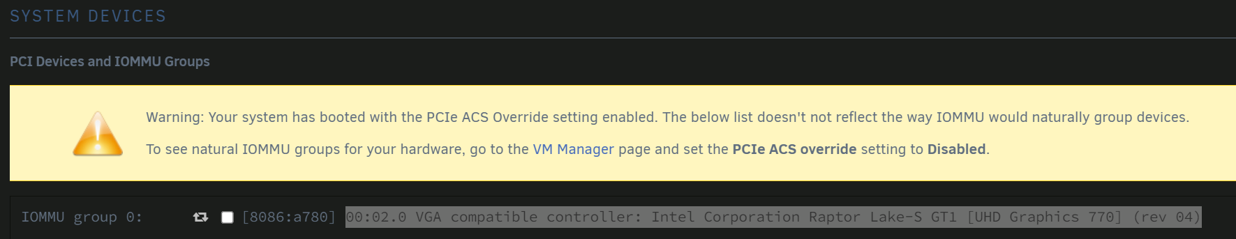

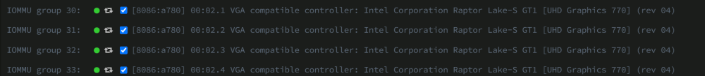

On 11/6/2023 at 2:25 PM, wbgwwd said:
Now there is a new problem, in the system when I start the bind reboot unraid, he gives this error
@ich777
15 minutes ago, wbgwwd said:
@ich777
@wbgwwd sorry but if you don't post your Diagnostics or the contents from the above file nobody can help you and it won't be able to help if you mention me in your posts where I see a screenshot of an error that I can't identify because I don't have your Diagnostics.
17 minutes ago, ich777 said:
@wbgwwd抱歉,但是如果您不发布您的诊断或上述文件中的内容,那么没有人可以帮助您,如果您在帖子中提到我,而我看到了我无法看到的错误的屏幕截图,那么它也无法提供帮助确定,因为我没有你的诊断。
wbgtower-diagnostics-20231107-1539.zip
14 minutes ago, wbgwwd said:
I think you should not bind the vGPUs to the VMs itself via VFIO:
Loading config from /boot/config/vfio-pci.cfg
BIND=0000:00:02.1|8086:4690 0000:00:02.2|8086:4690 0000:00:02.3|8086:4690 0000:00:02.4|8086:4690---
Processing 0000:00:02.1 8086:4690
Processing 0000:00:02.2 8086:4690
Processing 0000:00:02.3 8086:4690
Processing 0000:00:02.4 8086:4690
Devices listed in /sys/bus/pci/drivers/vfio-pci:
vfio-pci binding complete
Instead you should use the plugin to bind them to the VM, at least I think that's how you should do it, because as said I can't test this because I don't have compatible SRIOV hardware.
@domrockt can you help here please?
Please also change the file /boot/config/modprobe.d/i915-sriov.conf to:
# disable autoload old i915 module on boot
blacklist i915
(there are two empty spaces in-front of the second line which are maybe my fault)
You have to wait for @domrockt so that he can explain to you how this is working, maybe he can go through your Diagnostics and see what's wrong.
yea that error is normal have that too but its still working. as far as i understand the error comes because the VFIO command comes from the userscript the binding happens AFTER starting the array.
 no no not an simple adapter/converter it needs to be of sorts i posted its a dummyplug but with an actual hdmi port.
https://www.wavlink.com/en_us/product/WL-UG3501H.html
Edited by domrockt
