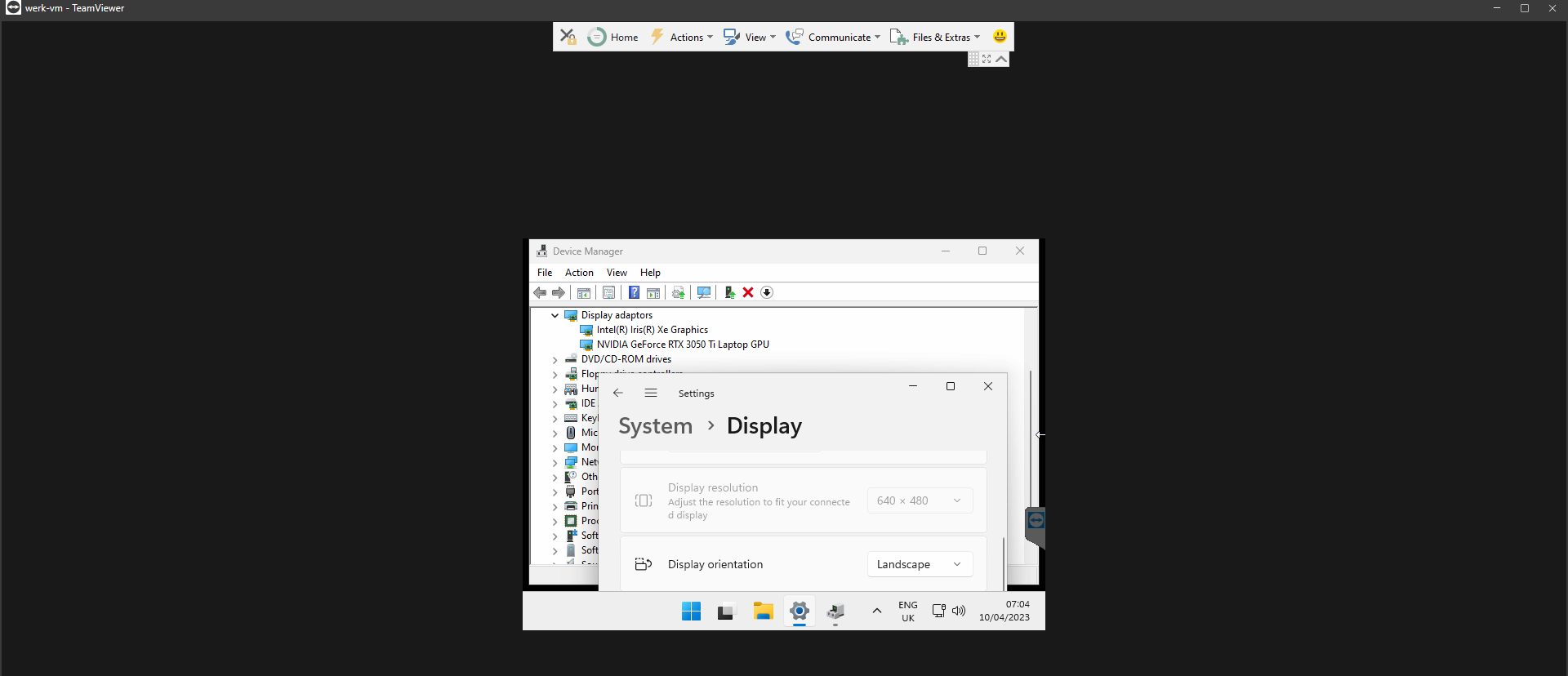

On 4/10/2023 at 4:07 PM, Cheater said:
When I use SR-IOV the Intel XE graphics card is correctly detected. I'm using Teamviewer to view the screen, but the resolution is just 640x480. I assume this is because no physical screen is attached to adapt the resolution to. Any ideas how to resolve this?
I have the same problem . i testet also with hdmi dongel in hdmi port but i cant set high resolution.
any tipps ?

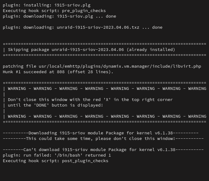

The plugin cannot work on 6.12.0-rc5
The installation run failed
----------Downloading i915-sriov module  for kernel v6.1.27---------- -
--------This could take some time, please don't close this window!-----------
--------Can't download i915-sriov module Package for kernel v6.1.27----------
- plugin: run failed: '/bin/bash' returned 1 Executing hook script: post_plugin_checks
Edited by FEILUAN
Mine installed just fine, but this plugin is causing incompatibility issues with intel_gpu_top

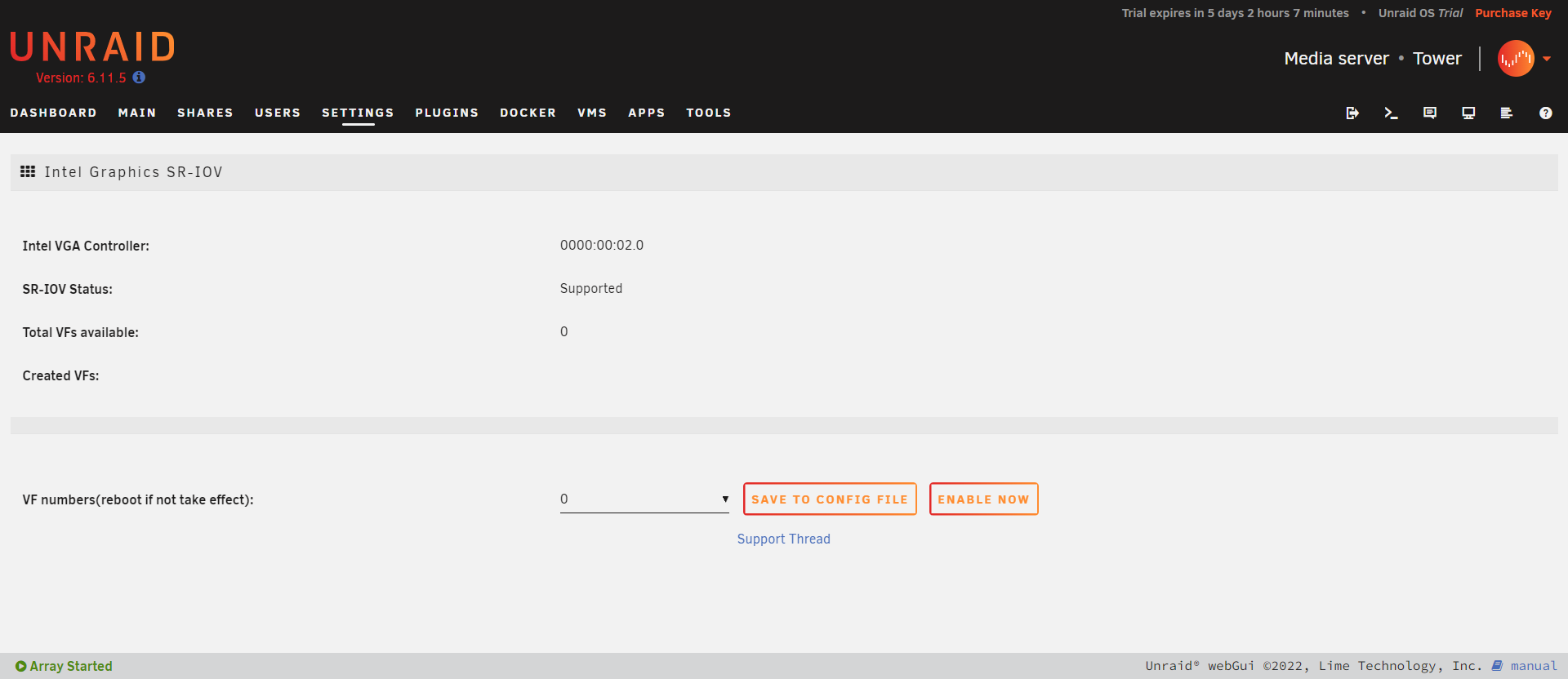

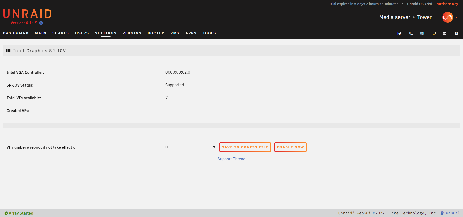

My hardware platform is ERYING 12500H+G660, and the plugin isn't working on my platform.
During the installation, the system log shows
May 10 19:53:33 Tower root: plugin: creating: /boot/config/plugins/i915-sriov//unraid-i915-sriov-2023.04.06.txz - downloading from URL https://raw.githubusercontent.com/zhtengw/unraid-i915-sriov/master/packages/unraid-i915-sriov-2023.04.06.txz
May 10 19:53:34 Tower root: plugin: running: /boot/config/plugins/i915-sriov//unraid-i915-sriov-2023.04.06.txz
May 10 19:53:34 Tower root: plugin: running: anonymous
May 10 19:53:40 Tower kernel: i915 0000:00:02.0: driver does not support SR-IOV configuration via sysfs
May 10 19:53:40 Tower root: plugin: i915-sriov.plg installed
before reboot, the plugin page shows
after reboot, the plugin page shows
I paste the system diagnostics before reboot and after reboot here. Does this is the problem of drive not supporting my devices?However, hardware decode works fine in jellyfin docker container. Thanks for paying attention.
tower-diagnostics-20230511-1451.zip tower-diagnostics-20230511-1455.zip

Problem solved. It needs enable "Above 4G MMIO BIOS assignment" in BIOS.

and the output of cat /sys/devices/pci0000:00/0000:00:02.0/sriov_totalvfs just returns 0.
Any idea what might be wrong here?
Thanks!

unraid 6.12.3 was just released. it broke sr-iov. worked fine in 6.12.2.
6.12.3 -
"Docker
This release resolves an issue where Docker does not properly stop when the array Stops, which can result in an unclean shutdown.
If Docker containers have issues starting after a while, and you are running Plex, go to your Plex Docker container settings, switch to advanced view, and add this to the Extra Params: --no-healthcheck"
I had the this problem with dockers and unclean shutdown, and disks not unmounting so upgraded. after upgrading sr-iov was missing. after trying to reinstall it this is the dialog. it appears in settings again, but as soon as i try to save config, and enable it doesn't work.
thanks
EDIT:
found this in the logs
"Jul 15 12:17:33 Tower kernel: i915 0000:00:02.0: driver does not support SR-IOV configuration via sysfs"
not sure what happened between 6.12.2 and 6.12.3. its weird that sr-iov is in settings, but not on the plugin page. and "apps" still gives me the option to install, but fails.
Edited by letrain
log located
