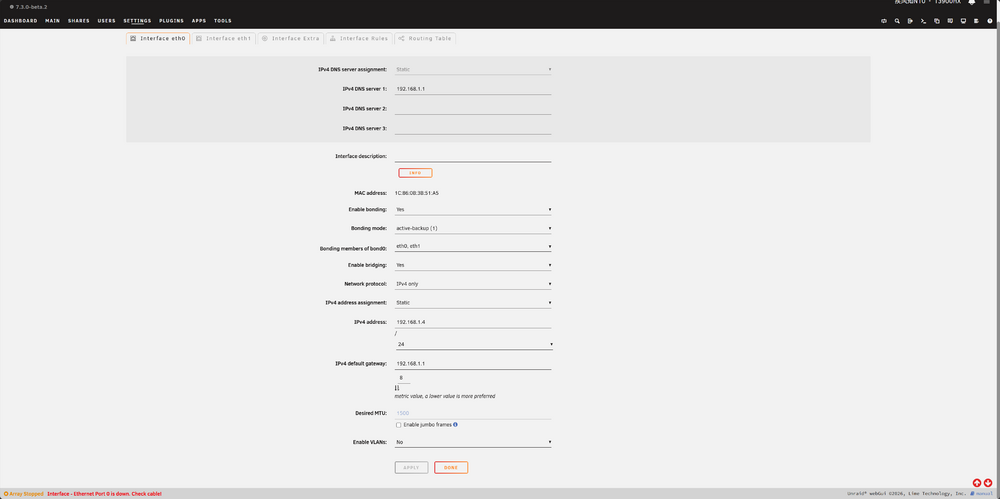

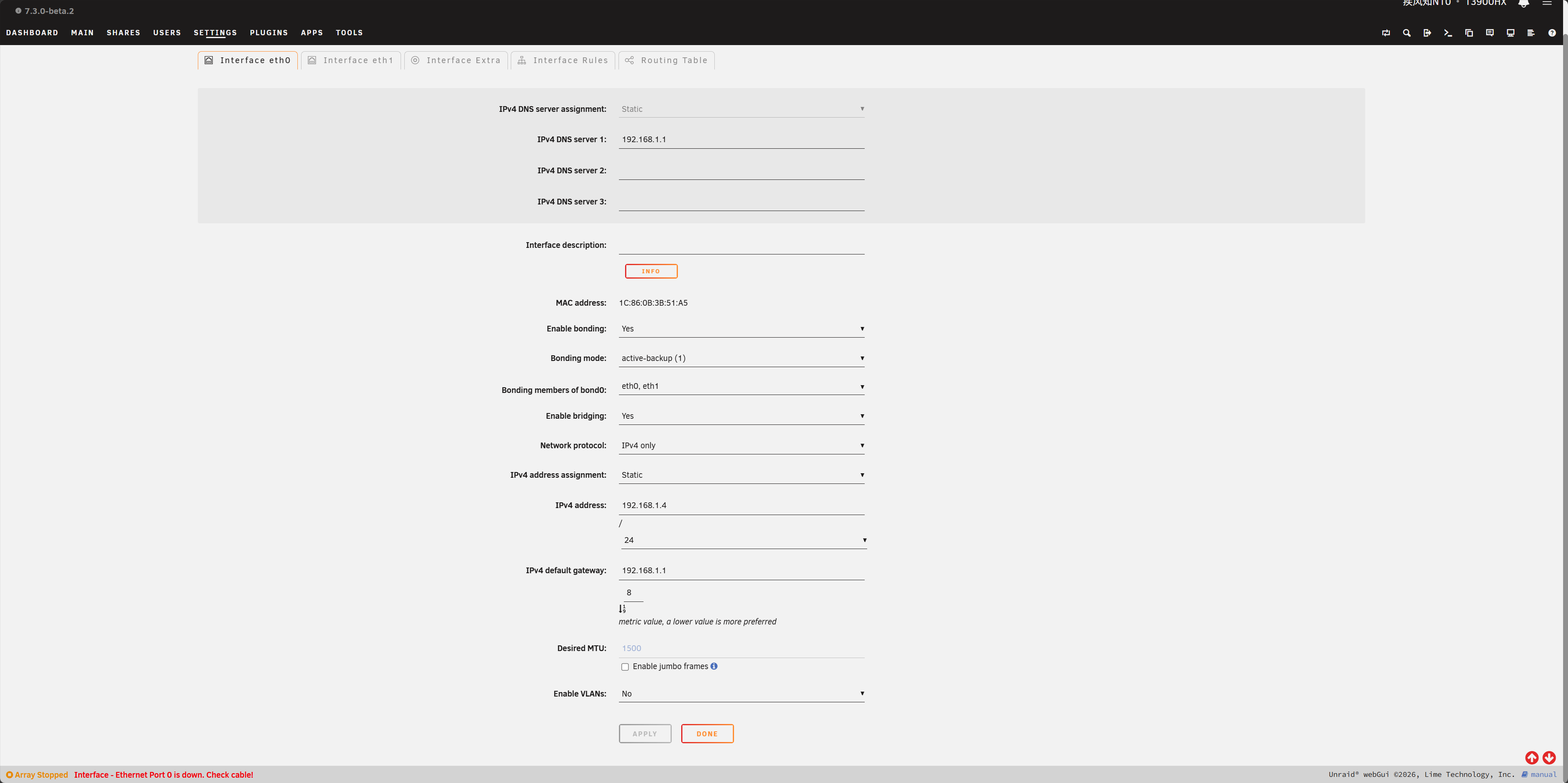

  1. I also have an 8127 (network card/device), but on Unraid 7.3 Beta 1 and Beta 2, I keep getting the error: "Interface-Ethernet Port 0 is down. Check cable!" It works fine when installing other systems. Do I need to install additional drivers? Thanks.
