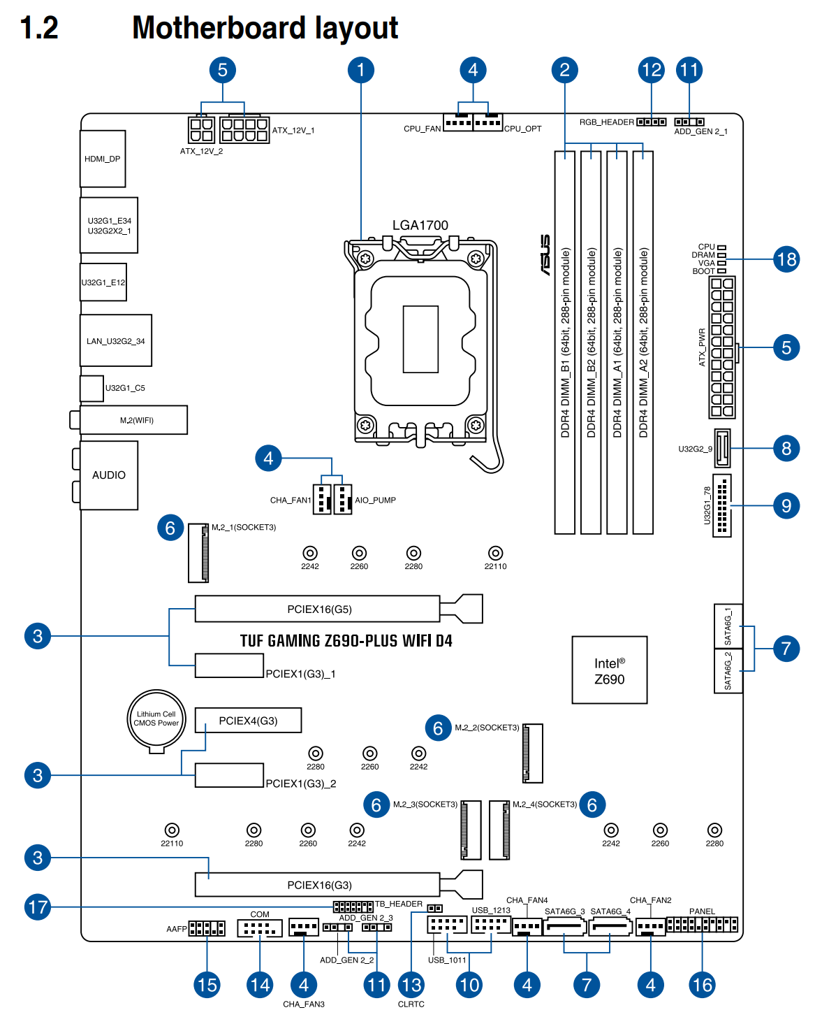

The nvme in question is a SK hynix Platinum P41 1TB. It is installed in the M.2_1 slot, as seen in the image below (taken from my TUF GAMING Z690-PLUS WIFI D4 manual):
