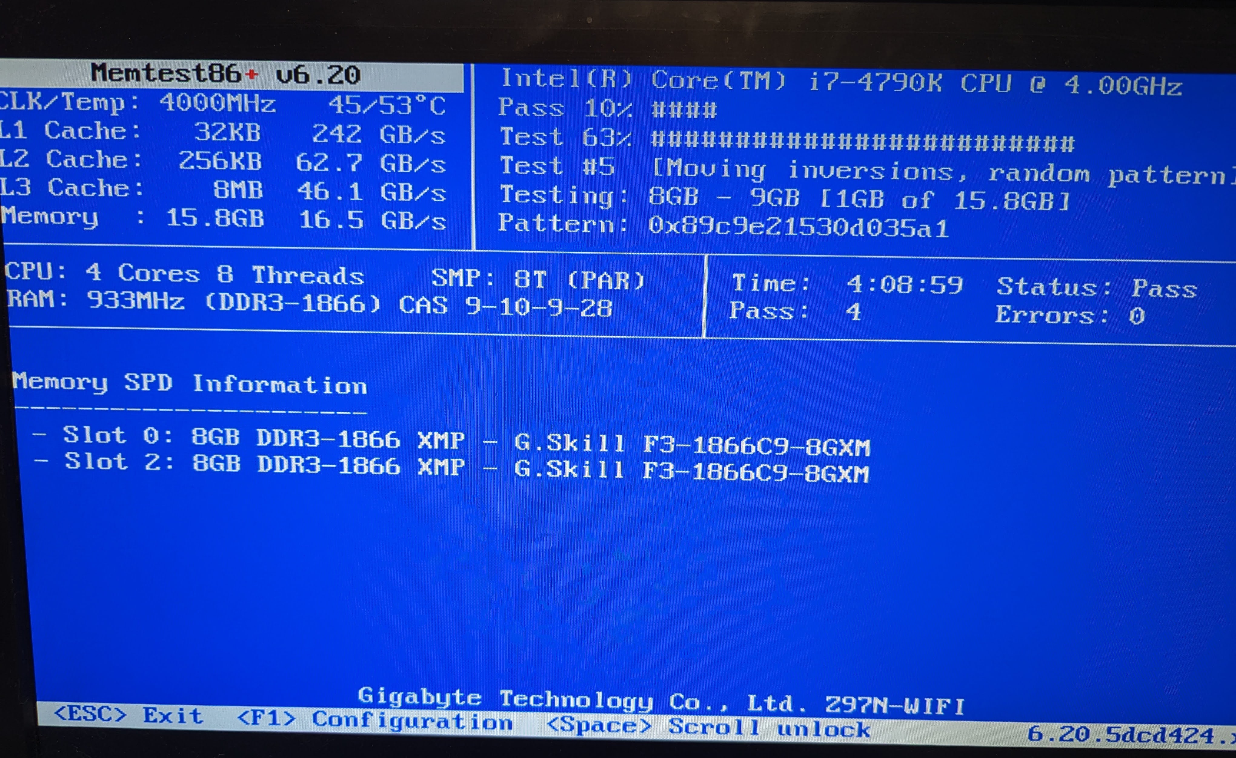

Pool is detecting data corruption, good idea to run memtest.
Also change docker network to ipvlan.

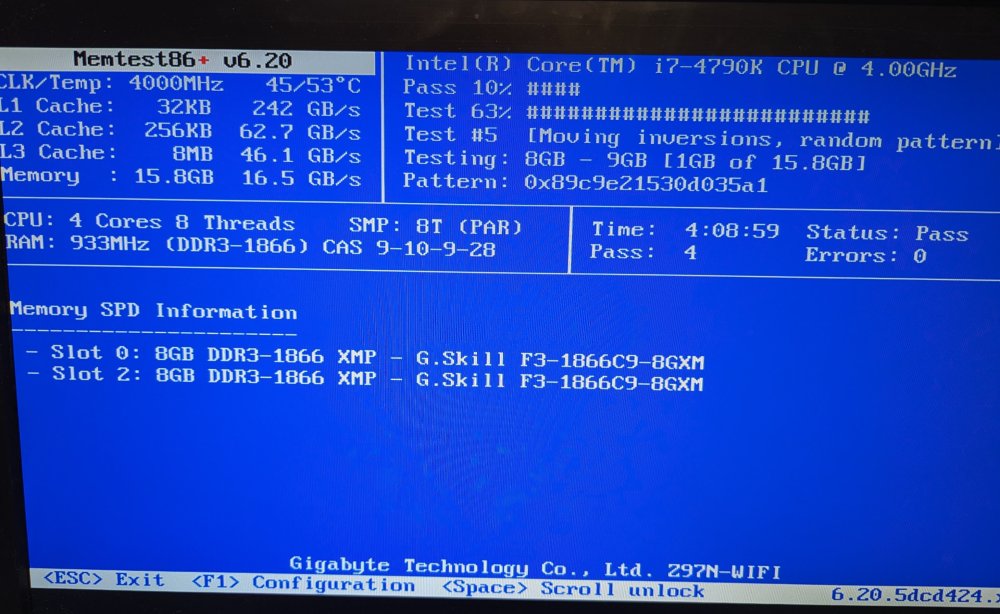

Attached picture of memtest run. Did 4+ passes with 0 error. I have also rebooted and set network to ipvlan. It's running parity check again, because of unclean shutdown. I'm guessing that's because the errors that were present.

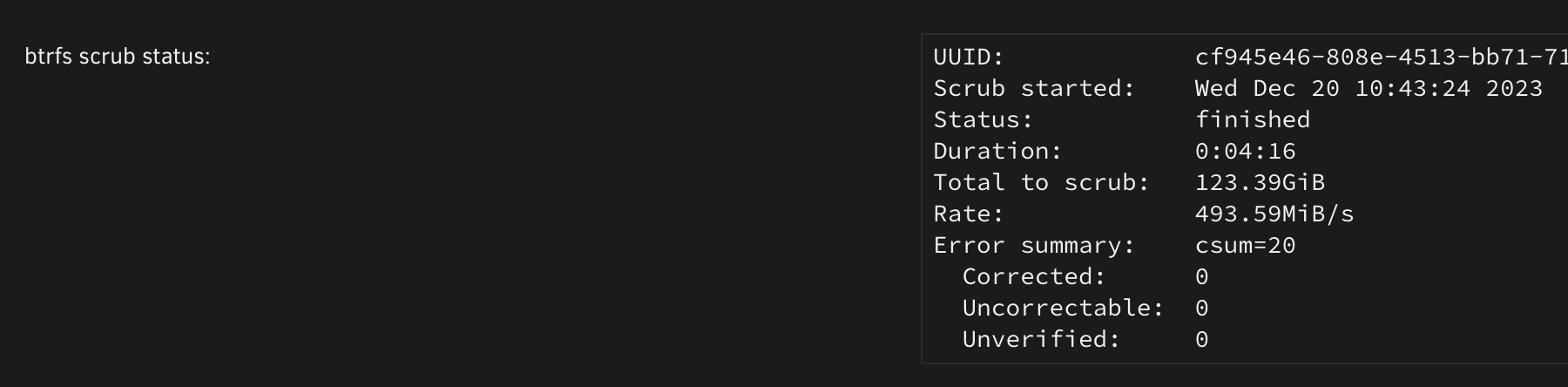

14 minutes ago, openam said:
and didn't find anything

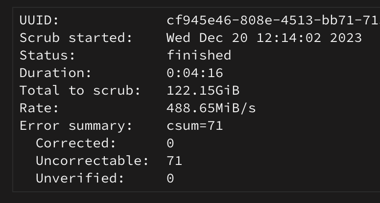

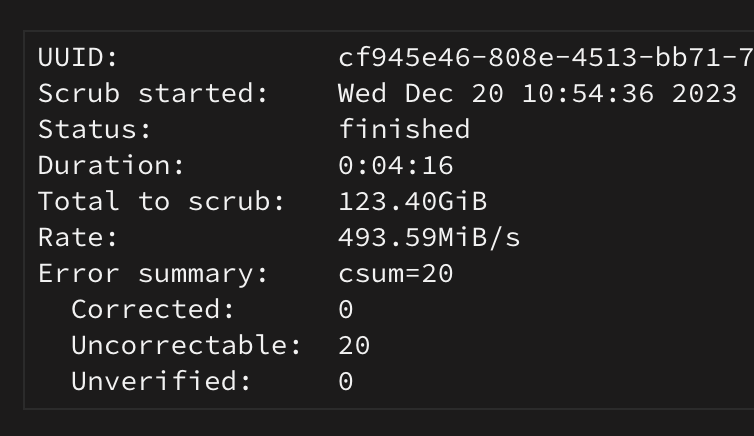

It did find 20 checksum errors, run a correcting scrub and post the output of that.
You're right, but it says they uncorrectable. Apparently I don't how to read that summary.
The corrupt files should be listed in the syslog, delete/restore them, then re-run a scrub.

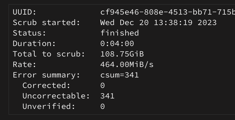

I was down to just 6, but delete it and ran again, and now it's showing 71. Do I just keep playing whack-a-mole?
Oh man. I've been deleting them out of /mnt/user instead of /mnt/cache
/mnt/cache is included in /mnt/user.
Every time I delete some and re-run it appears to get worse.
I know you did memtest but btrfs csum errors are often caused by bad RAM. Did you have memory problems in the past?
I do not remember having memory problems in the past (which may mean I personally have them 😁).
Another thing I did recently (about 1 week ago) was upgrade from 6.9.x to 6.12.x. Which makes me wonder if it's something like this guy was seeing,

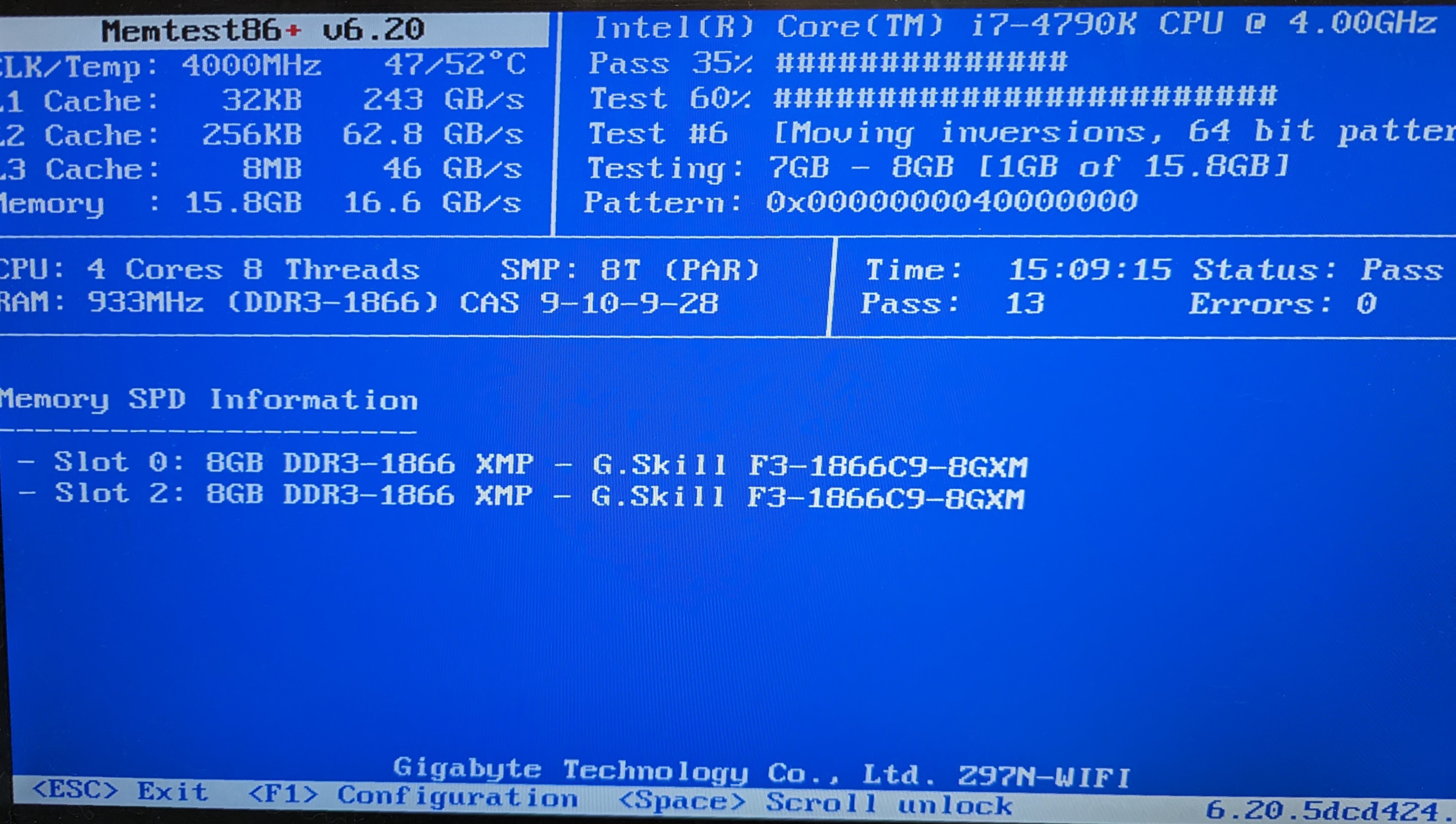

I have heard of people running memtest for many more hours than I did. Should I let in run all night?
Couple of hours is usually enough to detect a serious issue.
I ended up letting it run all night, and still shows no errors. I did order some cheap replacement memory sticks that should be here later tonight though.

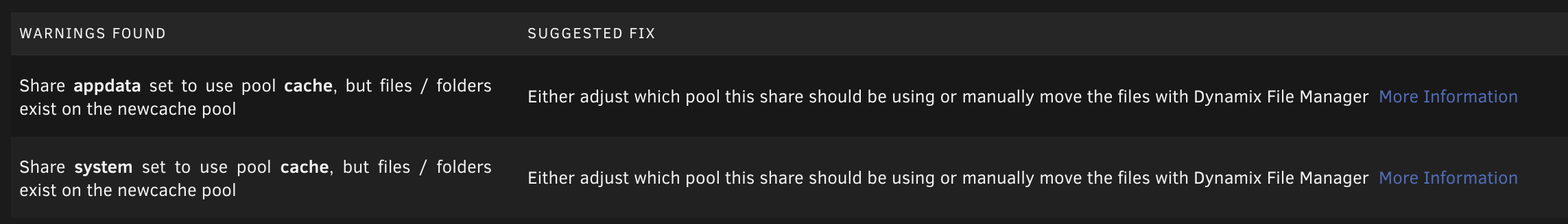

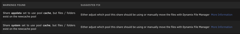

So after I copy everything to a new cache do I just update the shares reference to use the new cache?
Also I got these warnings, but that kind of makes sense since I'm coping from one to the other.
