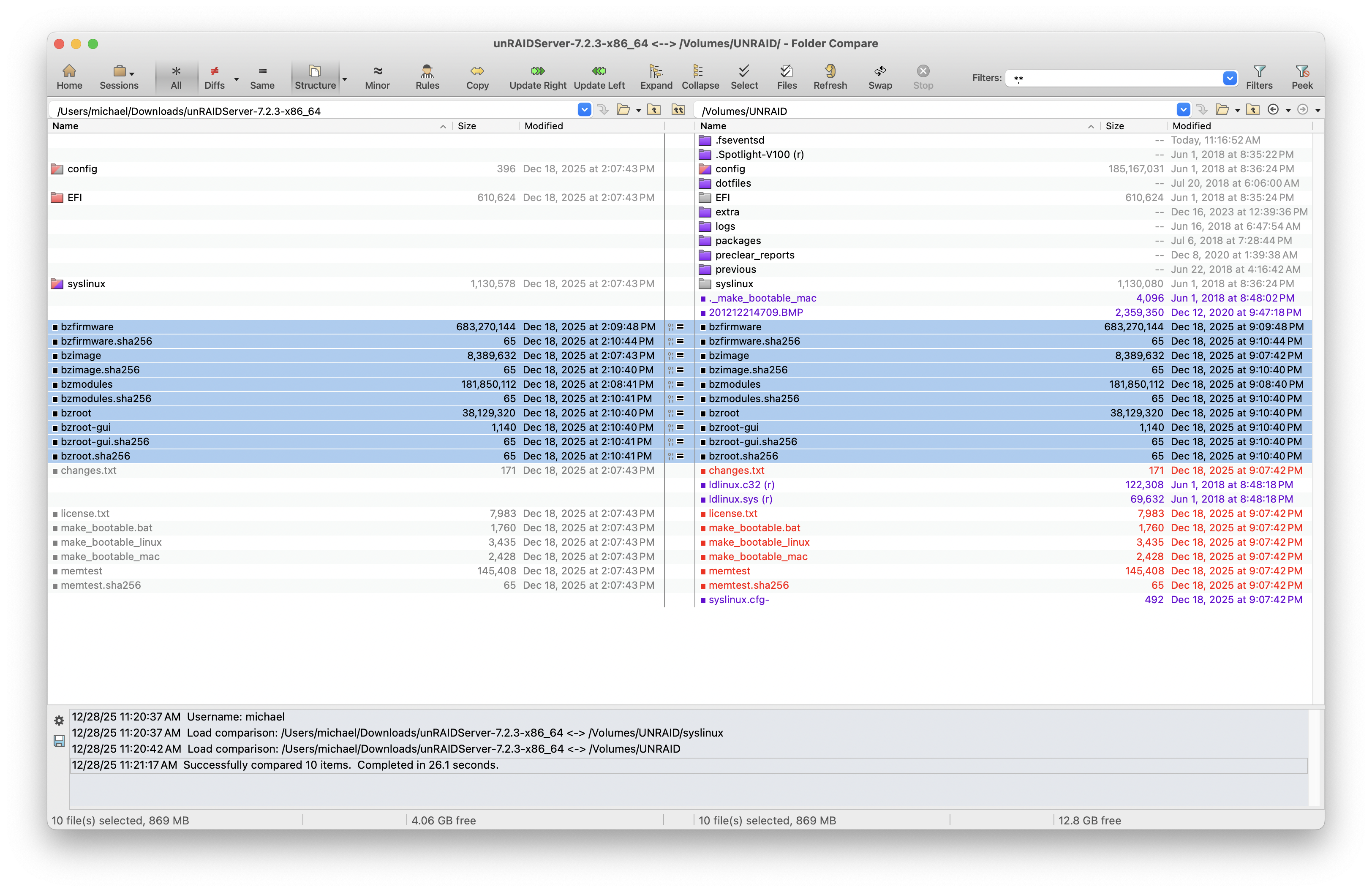

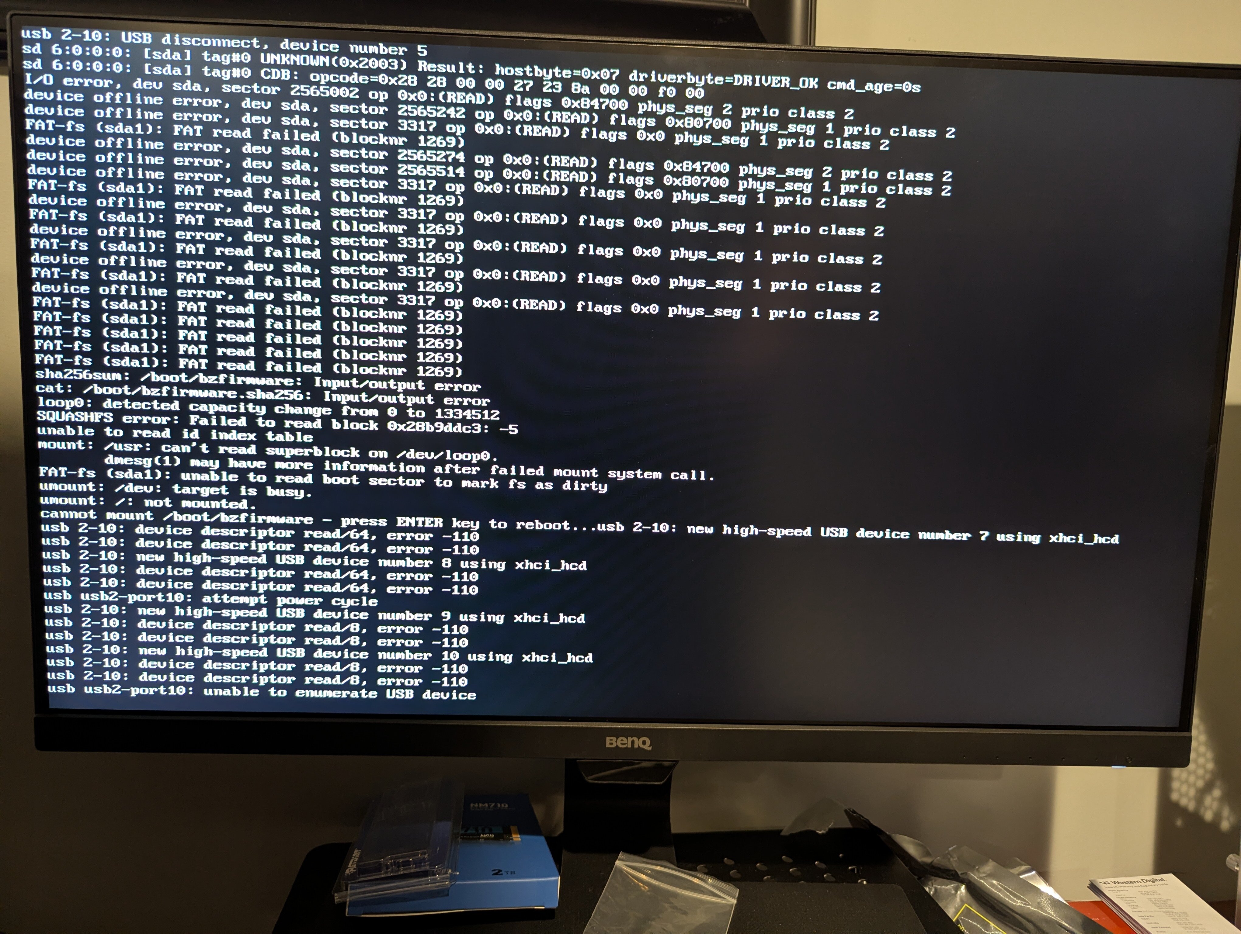

  1. Thanks for the help. I copied the bz* files back over the ones in the root of the flash drive. It seemed to work, re-ran the parity check (it passed), and everything is back up and running! I'm making a backup of the flash drive now.
  2. I took one when it came up with the upgrade to 7.2.3 from 7.2.0 (So it may be corrupt). I do have an old one from February 2025, but I'm not sure if that would be up to date enough. I had Backup/Restore Appdata running on it, but I believe those are on the array 😬. I copy the bz* files over and started up the machine. It's running, but I haven't started the array.
  3. I download it from the link I found here. I have beyond compare are I take it these are the files you are talking about. The binary comparison says they are already the same. Should I just copy over it, and try it out again?

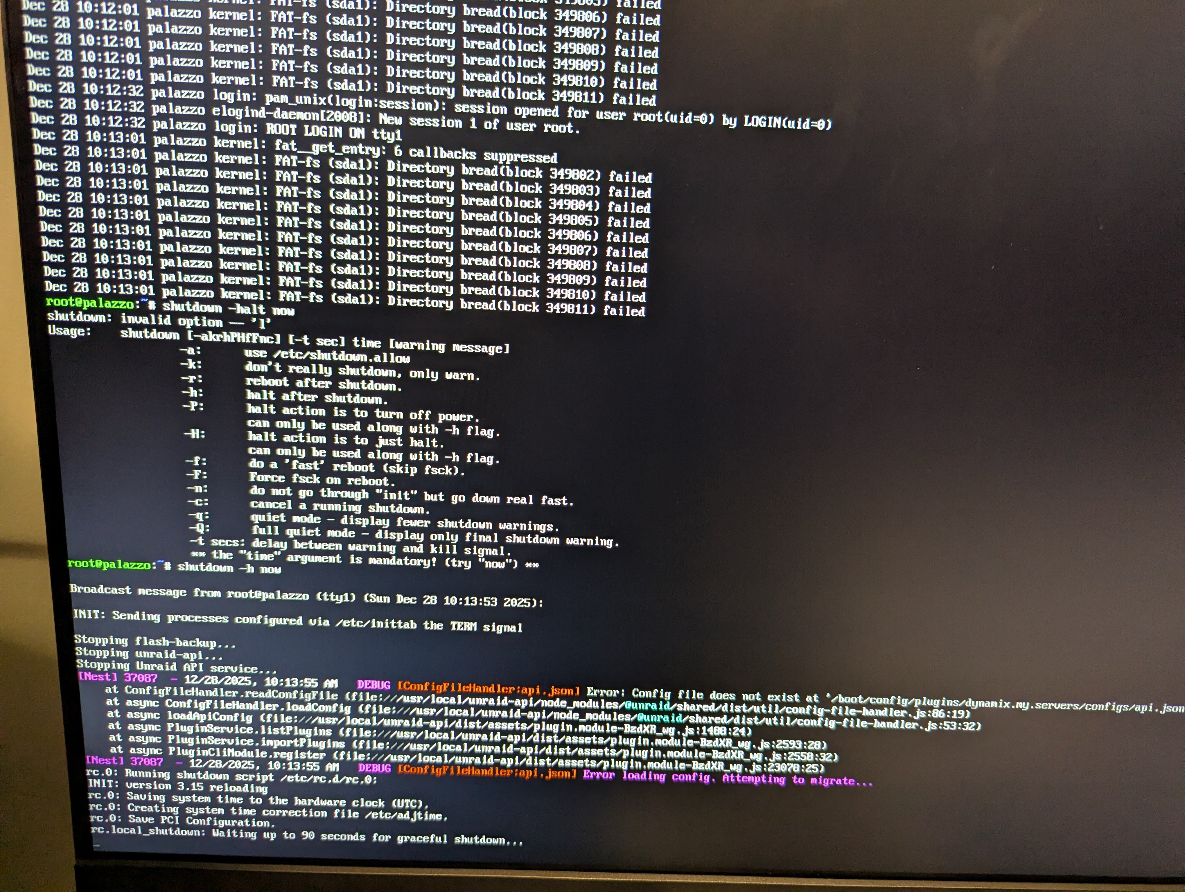

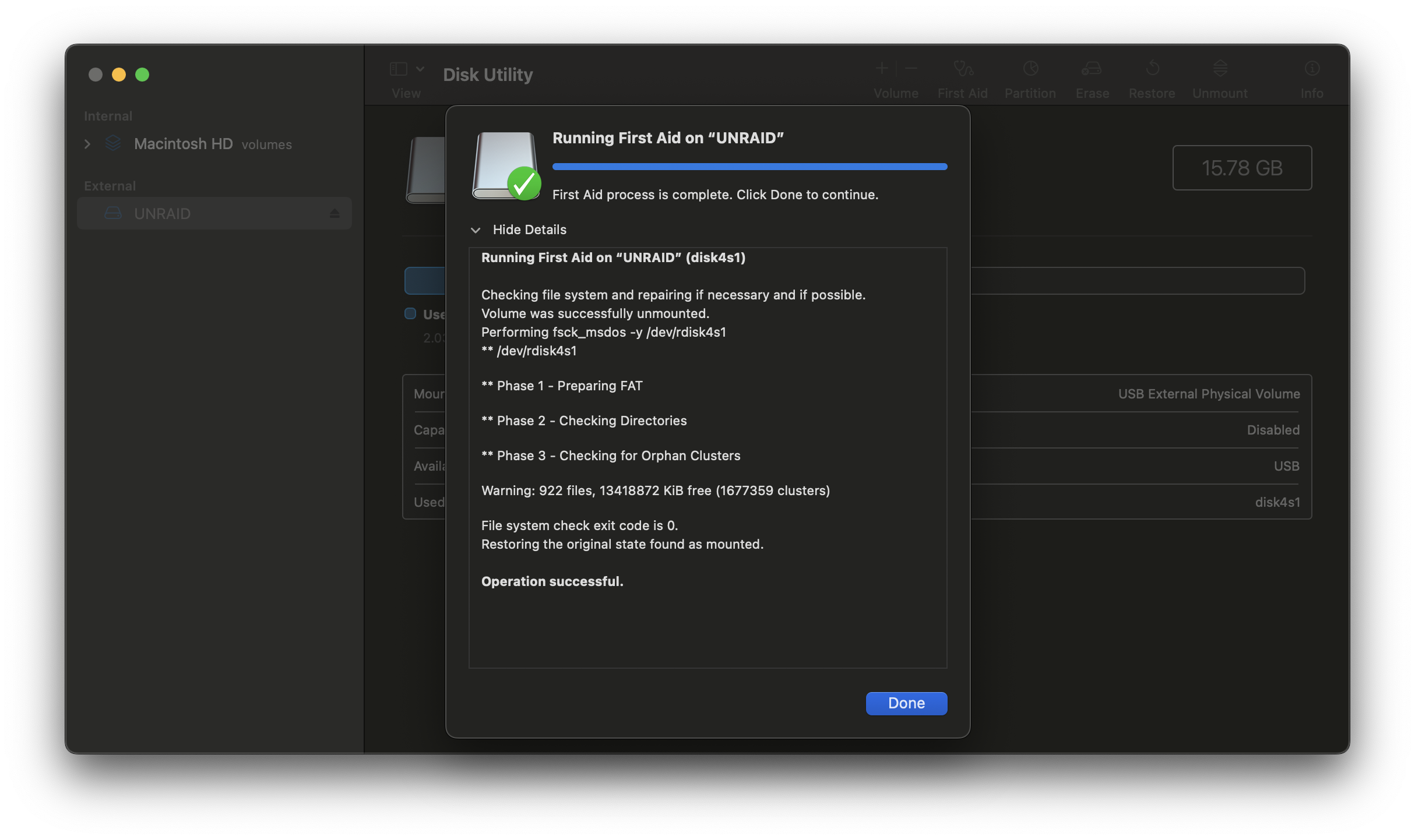

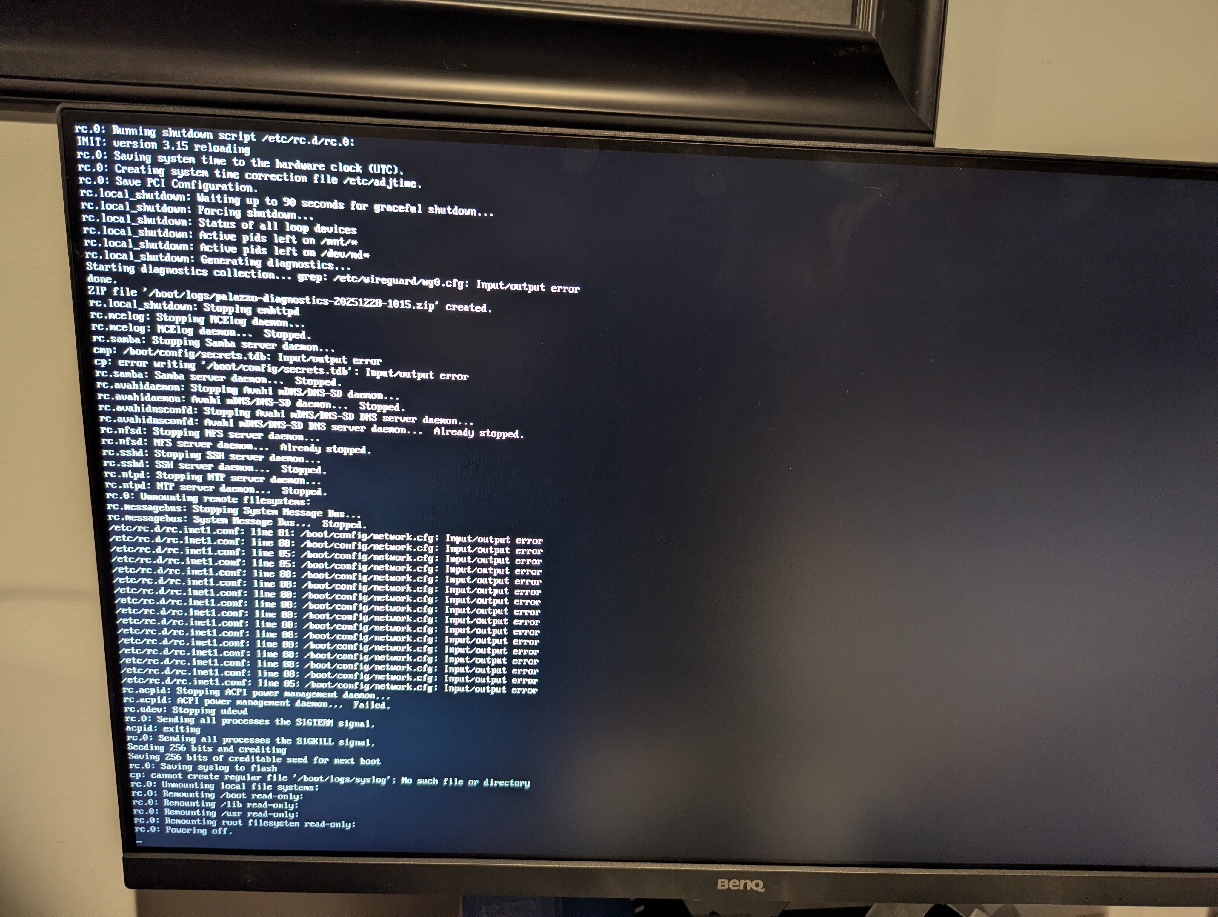

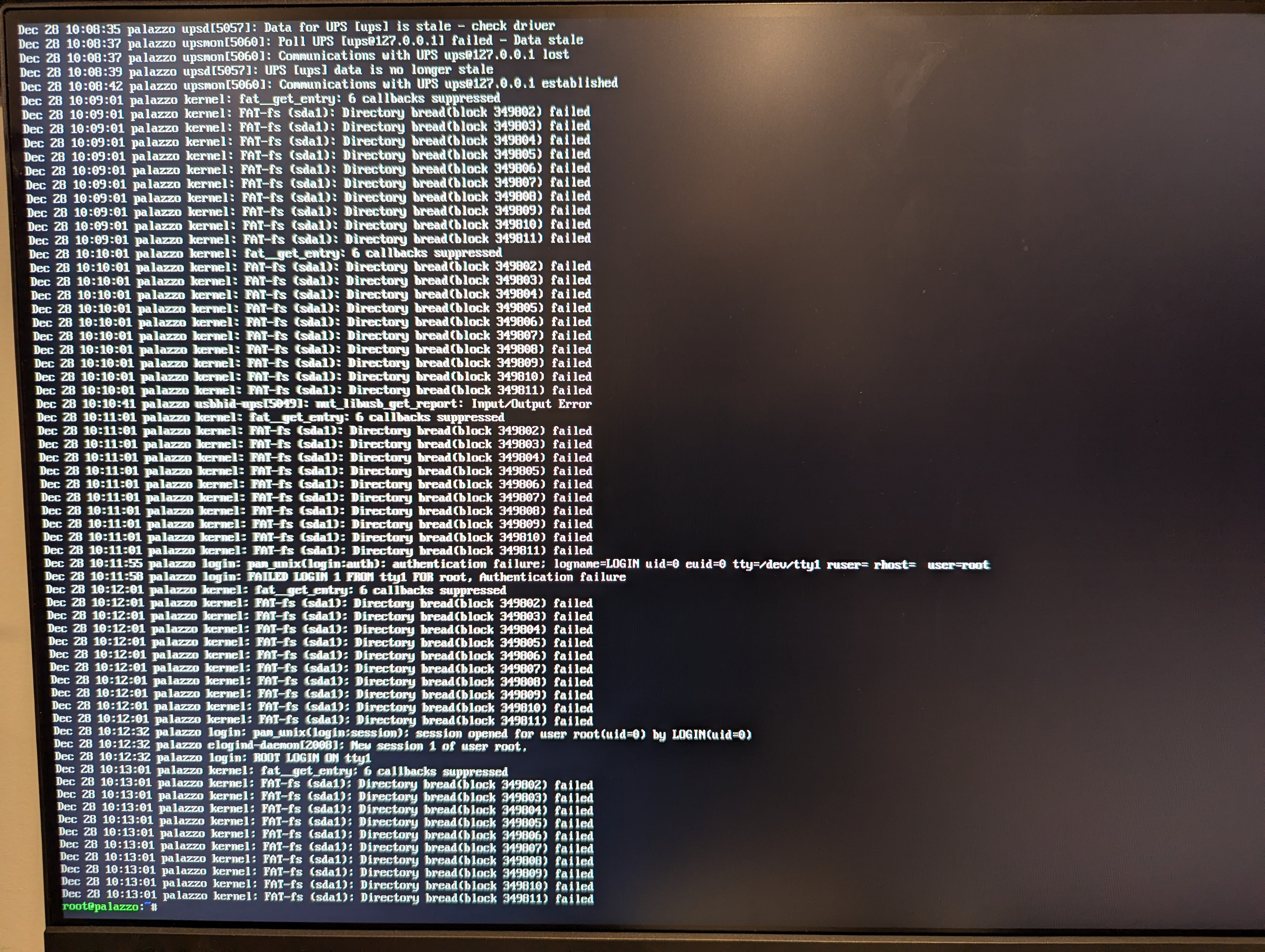

  4. My unraid server locked up yesterday. I ended up re-seating the USB Flash drive, and got it to boot. I just left it up and running without starting the array all night. This morning I noticed the upgrade from 7.2.0 to 7.2.3, so I had it do the update and then started the reboot to finish update. It didn't seem to want to come up. That is when I went and saw this: I hit "enter" like it said to reboot the device. When it came back up it didn't find a boot drive, so I re-seated the USB flash drive again. It started up and I downloaded a backup of the flash drive. It then started to not respond again and I saw this: I couldn't reach it remotely so when I was logged in in locally I just shut it down Then looking at the info about replacing your flash drive I saw that I should try and run Mac Disk Utility to check for and repair errors. Here is what that showed. This is where I'm currently at. The machine is off. I have the USB here by my mac, I have ordered a new USB flash drive. Does it seem like the flash drive is really failing? Should I just wait for the new flash drive to show up, and migrate to that? Is there something else I should look at?

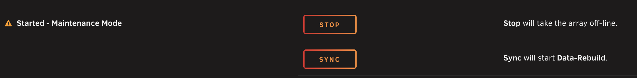

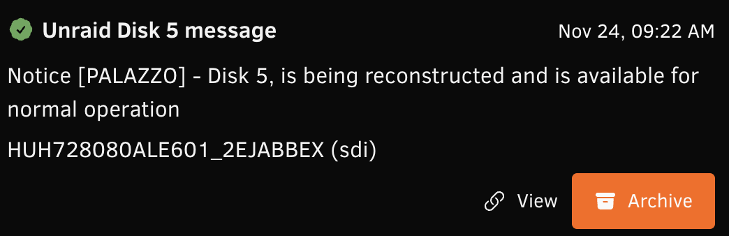

  5. Thanks everyone. Everything is back up and running. Sync completed. Then I stopped the array, and restarted it not in maintenance mode.
  6. I ended up hitting the Sync button because there was no progress showing that the rebuild was started. It appears to be running now.

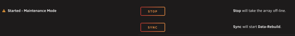

  7. I started in maintenance mode. How do I know if it's being re-built. It feels like I'm getting conflicting messages. This says it's being re-constructed But this says Sync to start Data-Rebuild Is there a difference between reconstructed and Data-Rebuild? Is this just a UI issue? Or do I need to hit the Sync button to actually get this to fix it?

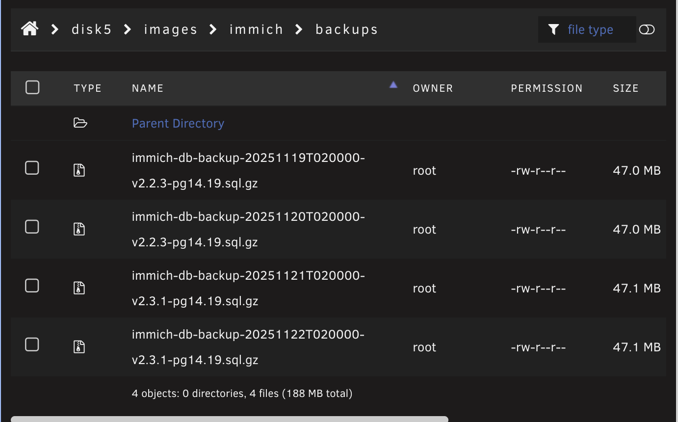

  8. Started the array, attaching diagnostics. Looking at disk5 it appears that there is stuff in there. palazzo-diagnostics-20251124-0853.zip

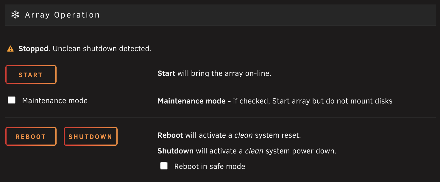

  10. I just re-read your message. Sounds like 2 different ways to start parity check. 1 - Start array after unclean shutdown 2 - Explicitly start parity check (I assume this is after array is started) Is that what you mean? If so I originally just did the 1st option.
