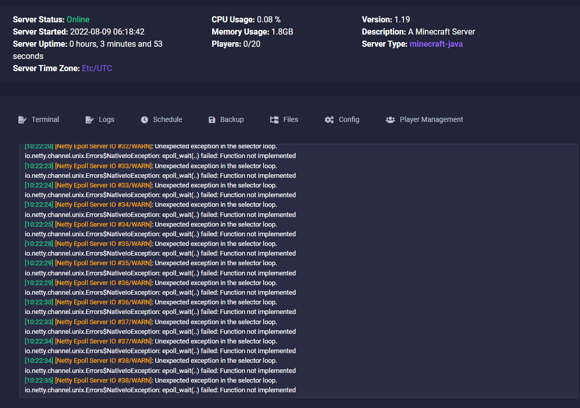

Anyone know how to fix this issue with vanilla servers? image.thumb.png.c0b5d3c191b2a9418b7a5e6d1f83b479.png
Yes download the latest version of Minecraft java, you are two revisions behind
