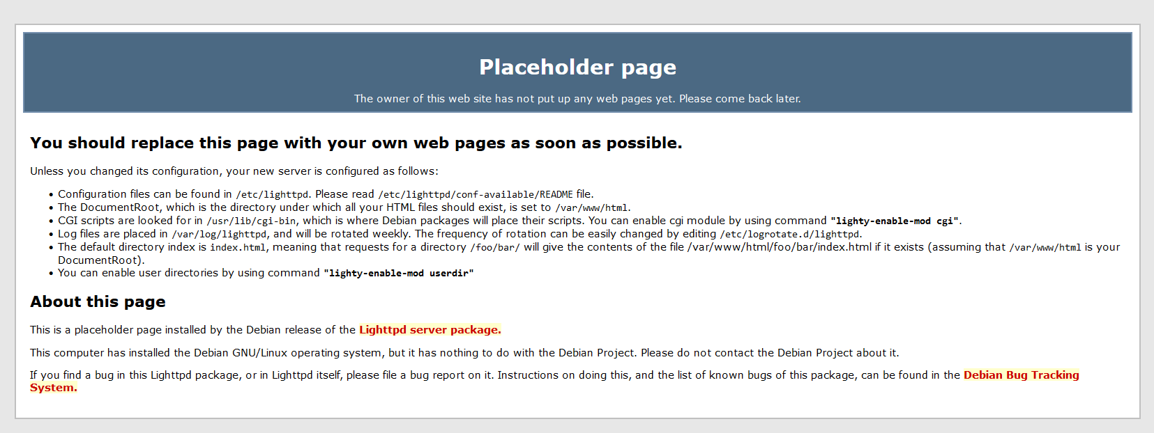

Hi, after an update i now receive the following page instead of the pihole gui. API is still working, Pi-Hole too. Any idea why this is happening?
