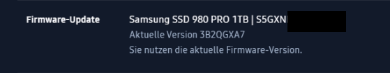

  18. Alright, added the line. 980 pro firmware is up to date
