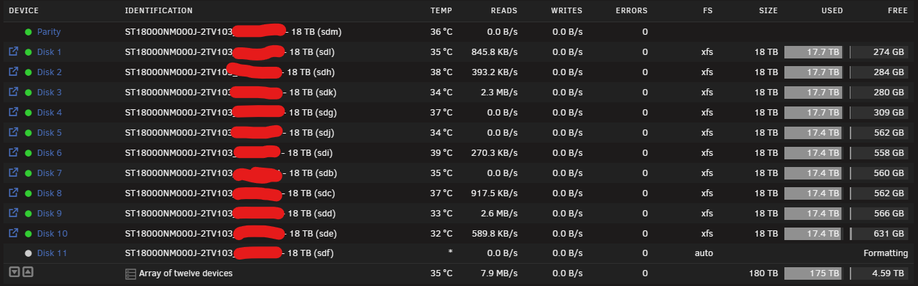

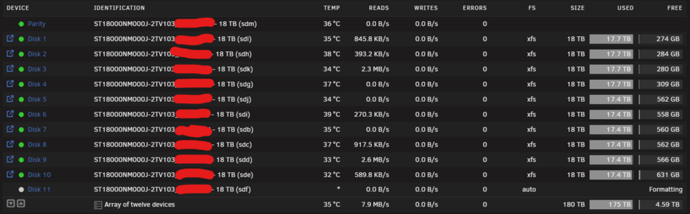

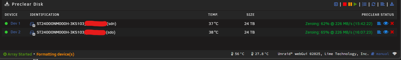

  1. Just wanted to say, this is still an issue to this day if anyone comes across this. If you have a running pre-clear and trying to add a drive to the array at the same time you will be unable to format the drive.

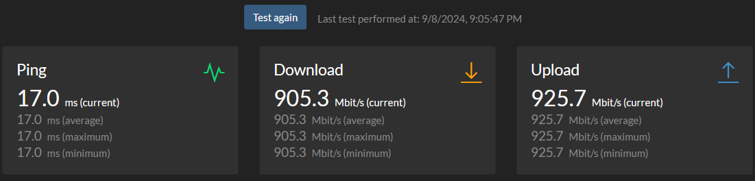

  4. When I pull an app down from community applications the pull takes forever. I know I am not the only one that has seen this issue, and I looked at a lot of threads where people seem to resolve this by making sure their docker image is on their SSDs. Mine is on my cache pool SSDs, which is two 4TB Seagate FireCuda 530s. Here is the latest speed test from SpeedTest Tracker. I installed this just to make sure I wasn't going crazy. I've also confirmed that none of my appdata or system data was on my array. Not sure what else I should be looking for. Any help is appreciated! yeetunraid-diagnostics-20240908-2115.zip

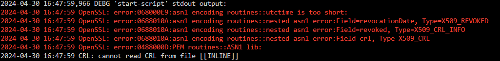

  11. My container won't start. I am using PIA. I tried updating the OPVPN files from PIA, but that did not help. OpenSSL: error:068000E9:asn1 encoding routines::utctime is too short: OpenSSL: error:0688010A:asn1 encoding routines::nested asn1 error:Field=revocationDate, Type=X509_REVOKED OpenSSL: error:0688010A:asn1 encoding routines::nested asn1 error:Field=revoked, Type=X509_CRL_INFO OpenSSL: error:0688010A:asn1 encoding routines::nested asn1 error:Field=crl, Type=X509_CRL I went back to binhex/arch-qbittorrentvpn:4.6.4-1-01 to resolve this, so I know this is must only be an issue with 4.6.4-1-02 or my appdata somewhere. Edit: Added redacted supervisord.log and Command Execution Edit 2: I wrote out the error messages in case someone tries searching this topic or google to find what the error means. Here is my Command execution. docker run -d --name='binhex-qbittorrentvpn' --net='bridge' --privileged=true -e TZ="America/Chicago" -e HOST_OS="Unraid" -e HOST_HOSTNAME="YeetUnraid" -e HOST_CONTAINERNAME="binhex-qbittorrentvpn" -e 'VPN_ENABLED'='yes' -e 'VPN_USER'='REMOVED FOR SECURITY' -e 'VPN_PASS'='REMOVED FOR SECURITY' -e 'VPN _PROV'='pia' -e 'VPN_CLIENT'='openvpn' -e 'VPN_OPTIONS'='' -e 'STRICT_PORT_FORWARD'='yes' -e 'ENABLE_PRIVOXY'='yes' -e 'WEBUI_PORT'='8080' -e 'LAN_NETWORK'='192.168.1.0/24' -e 'NAME_SERVERS'='84.200.69.80,37.235.1.174,1.1.1.1,37.235.1.177,84.200.70.40,1.0.0.1' -e 'VPN_INPUT_PORTS'='' -e 'VPN_OUTPUT_PORTS'='' -e 'DEBUG'='true' -e 'UMASK'='000' -e 'PUID'='99' -e 'PGID'='100' -l net.unraid.docker.managed=dockerman -l net.unraid.docker.webui='http://[IP]:[PORT:8080]/' -l net.unraid.docker.icon='https://raw.githubusercontent.com/binhex/docker-templates/master/binhex/images/qbittorrent-icon.png' -p '6881:6881/tcp' -p '6881:6881/udp' -p '8585:8080/tcp' -p '8118:8118/tcp' -v '/mnt/user/Seeding Torrents/':'/data':'rw' -v '/mnt/user/Seeding Torrents/':'/seeding':'rw' -v '/mnt/user/appdata/binhex-qbittorrentvpn':'/config':'rw' --sysctl="net.ipv4.conf.all.src_valid_mark=1" 'binhex/arch-qbittorrentvpn' 9a258e96adc3c32057ccd9972e8dab39a8b33185c6f4038dd68e0bce61bcdee8 yeetunraid-diagnostics-20240430-1657.zip supervisord.log
