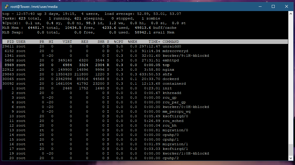

First off, I can't get into the web ui due to the backlog on my load currently sitting at 53, 53, 53 when I'm running dual L5630 or 16 threads.
2nd, so I can't post my diagonastics unless I can pull it from my CLI interface and drop it on one of my shares. Please comment if I can pull that from CLI.
thirdly, I'm on day four of my 3rd preclear of my parity disk. It should have less than 4 hours to go of a 48 hour run, so I'll reboot tomorrow if this backlog doesn't clear.
My CPU usage is low, I have enough ram 64GBs, I've stopped all my dockers and vms from the CLI, but I can't see what is driving my I/O so high.
Any thoughts?
