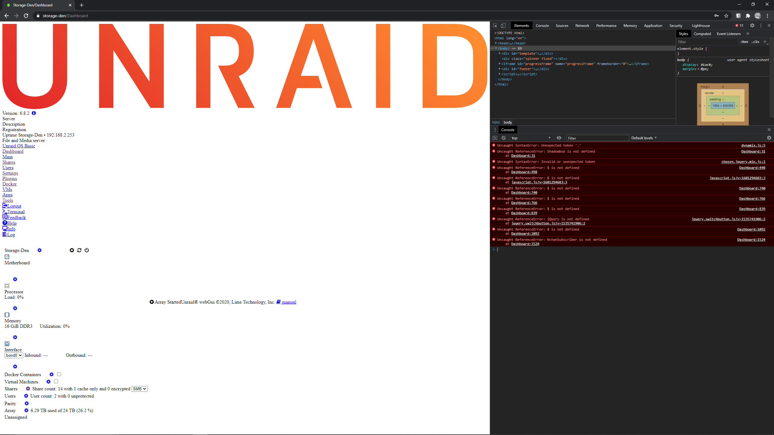

Starting just today I tried logging into the interface. The whole thing doesn't work with errors showing in the javascript console. I will post an image of what I see below. I'm on version 6.8.2. It was working fine up till today when it just stopped. I tried using the previous folder to try and get it working again with no luck. Any ideas?

A little further testing reveals that it is working fine on my Mac but not in Windows. The problem Is isolated there.
Definitely a browser issue then. Have you tried clearing browser cache?
I have yes. I think I found the root of the problem. I don't know how it's breaking it though. I use bit defender as my AV. It 'works' with it turned off. Going to have to follow up with them to solve the problem I think.
