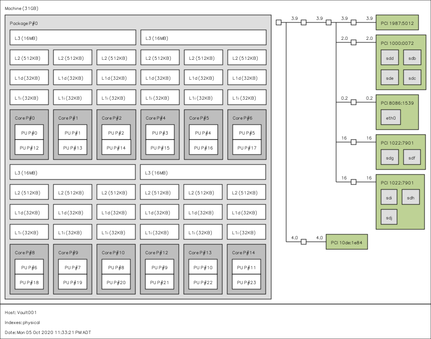

Lstopo 3900x
For my 3900x. Which cores should I be assigning to my gaming vm? I currently have 3-11,15-23 but I think this is wrong since my game (Hunt Showdown) crashes to desktop like ALL the time and when ever there is disk activity my VM stutters. I'm hoping assigning correct CPUs to my VM will fix this.
Since the 3900x has 2 Dies (0-5, 12-17 is a die), Should I only assign Cores from a single die to my VM? For example: 2-5, 14-17?
While the 3900X has 2 dies, it has 3 or 4 CCX.
Each CCX communicates with IO die separately so ideally you want to avoid lots of CCX.
I assume you would be able to confim in Ryzen Master.
From the image above, it appears you have 4 CCX of 3C6T.
Die 1  CCX 1   0-2,12-14
Die 1  CCX 2  3-5,15-17
Die 2 CCX 1   6-8, 18-20
Die 2 CCX 2  9-11, 21-23
