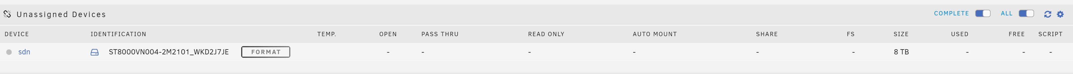

I just added a brand new 8TB drive to my server. I clicked unassigned devices so it would show up. It took a while for it to be listed. I went into unassigned devices and looked at the log and see this:
Oct 7 11:51:56 AUBURN kernel: sd 7:0:21:0: [sdn] 15628053168 512-byte logical blocks: (8.00 TB/7.28 TiB)
Oct 7 11:51:56 AUBURN kernel: sd 7:0:21:0: [sdn] 4096-byte physical blocks
Oct 7 11:51:56 AUBURN kernel: sd 7:0:21:0: [sdn] Write Protect is off
Oct 7 11:51:56 AUBURN kernel: sd 7:0:21:0: [sdn] Mode Sense: 7f 00 00 08
Oct 7 11:51:56 AUBURN kernel: sd 7:0:21:0: [sdn] Write cache: enabled, read cache: enabled, doesn't support DPO or FUA
Oct 7 11:51:56 AUBURN kernel: sd 7:0:21:0: [sdn] Attached SCSI disk
Oct 7 11:53:04 AUBURN unassigned.devices: Error: shell_exec(/usr/sbin/hdparm -C /dev/sdn 2>/dev/null | /bin/grep -c standby) took longer than 10s!
Oct 7 11:53:27 AUBURN unassigned.devices: Error: shell_exec(/usr/sbin/hdparm -C /dev/sdn 2>/dev/null | /bin/grep -c standby) took longer than 10s!
Oct 7 11:53:27 AUBURN unassigned.devices: Error: shell_exec(/usr/sbin/smartctl -A /dev/sdn | /bin/awk 'BEGIN{t='*'} =='Temperature:'{t=;exit};==190||==194{t=0;exit} END{print t}') took longer than 10s!
When it did show up this is what is showing in the unassigned device area: I can't click format.
I decided to go in and try to pre-clear the drive and when I select start pre-clear the process starts but just shows as starting.... I gave it about 30 minutes but still shows as starting. I stopped the pre-clear and status still showed as starting. I cleared the status so now it says Start Preclear.
Am I doing something wrong? Bad disk? Anything I should be checking?

I removed the disk and waited a minute then re-inserted it. This time the unassigned devices saw the disk. I just restarted the preclear again but it shows as starting... it has been this way for about 10 minutes and still there.
