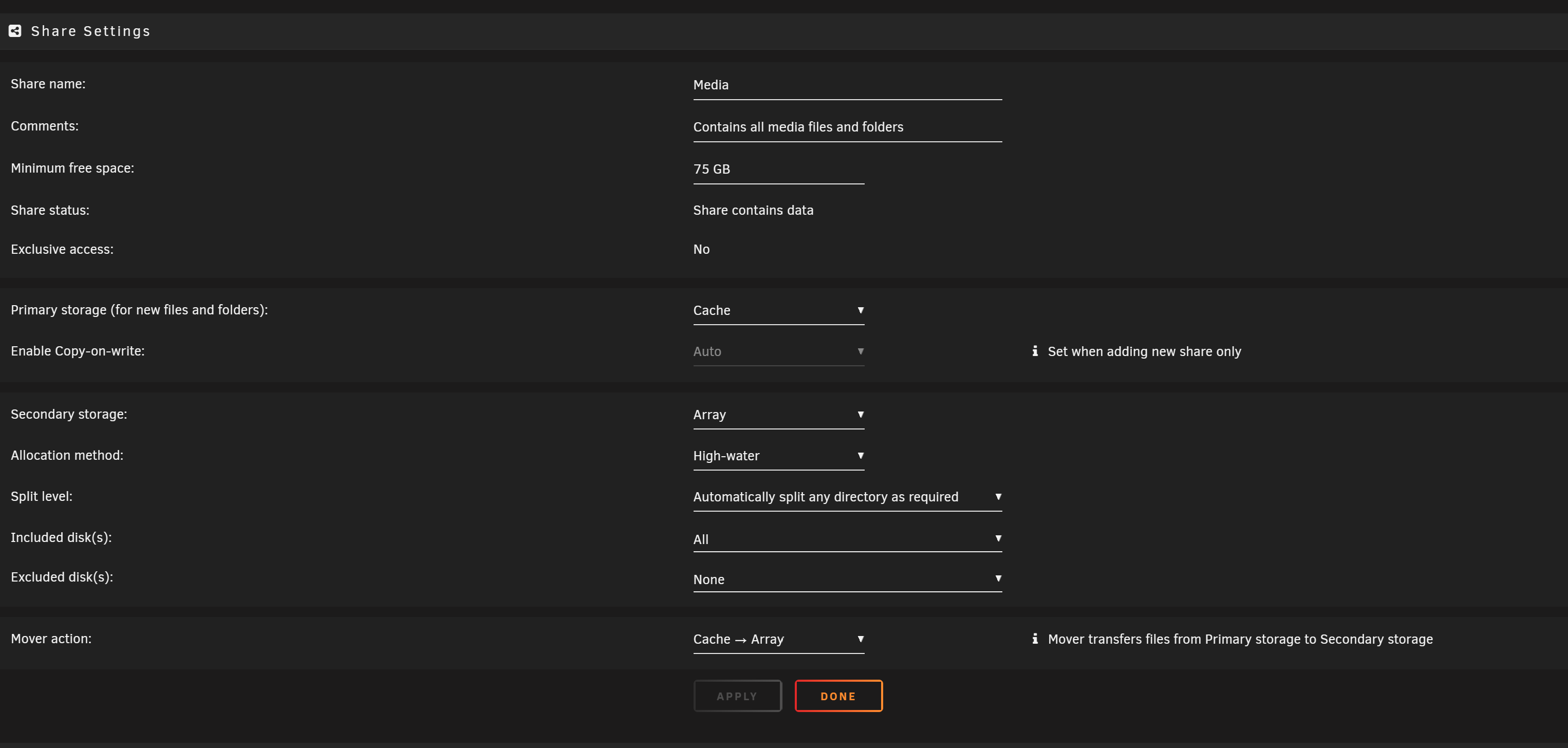

  4. I think I figured it out. I had to disable flow control on the nic on my windows PC. That seems to have drastically increase speed. Now getting 950 MB/sec with no drop off. Related. Should I be using Jumbo frames (9014)? What is the downside?

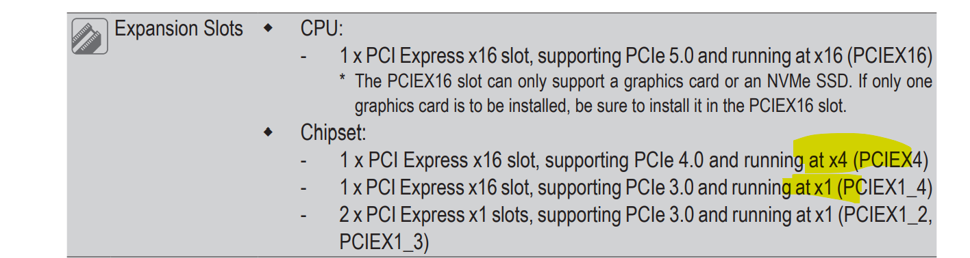

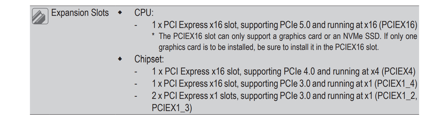

  11. That is the problem. One of the bottom two 16x slots is x1 and the other is x4. I have the HBA in x4 and the SFP in x1. The SFP works but getting like 180MB transfer speeds. I swapped the cards because the HBA was taking days to do a parity check. After doing that I noticed the drop in speeds on the SFP.
  12. I should planned this better. I have an intel i9 14900 chip in a gigabyte motherboard that has 5 PCIE slots. Only one of the slots is x4 and that currently has my HBA card. However, I also have a SFP+ card that needs a x4 slot to get 10gbe. I do have a free x16 slot which I am considering putting my HBA card in however I am concerned that if I do that my NVME will be affected. * I don't plan on gaming in the future but I had wanted to leave the slot open to future proof. Thoughts? Here is a link to the MB I have: https://www.gigabyte.com/Motherboard/Z790-EAGLE-AX-rev-1x#kf mb_manual_z790-eagle-ax_1002_e.pdf
  13. Thanks for finding that. I appreciate all the help. I changed the card to the PCIEX4 slot and it is now showing as 4X
