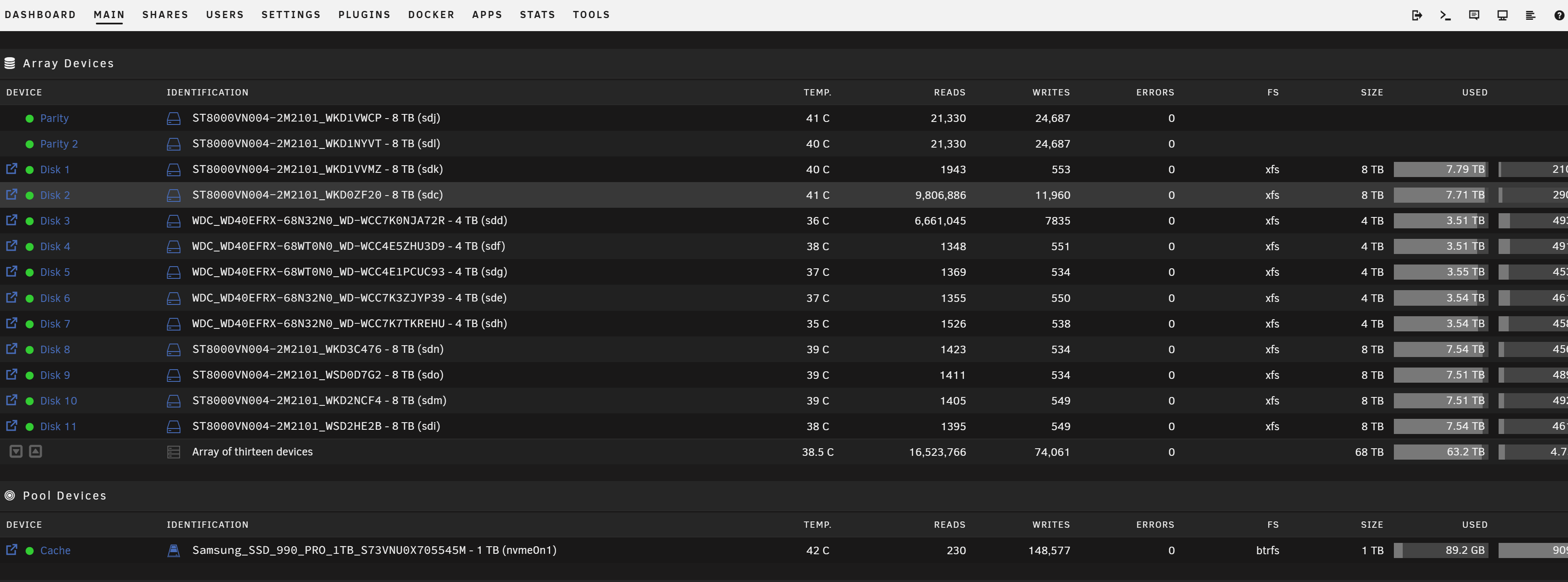

I stopped the parity check and downloaded diskspeed am running benchmarks now. Anything I should be looking for?- Extremely Slow Parity check and It just started for no know reason
Should I stop the parity check or let it run? Also, in my upgrade build I moved the HBA card to 8x pcie slot (I think it is the 8x, I know not the 16x) slot. Could that be the issue? No enough lanes?- Extremely Slow Parity check and It just started for no know reason
Background: About two weeks ago I upgraded the hardware in my unraid server. New MB, CPU/Cooler, Cache(nvme) and Ram. I kept the power supply, HBA and nic. Everything seems to be running fine. Issue 1: Around 4pm yesterday (Sunday) my parity check kicked off. No idea why. It is set to run at the end of every month. Why did it kick off? Issue 2: The parity check is very slow. This is the first parity check since my upgrade. Before the upgrade it would take 17 hours. It has been 17 hours and is only 25% done. Should I stop the parity check? My HBA is not in my 16x pcie, could that be the issue? I am attaching a diagnostic file. auburn-diagnostics-20240916-0954.zip- RDP Windows 11 Workstation to Redhat Linux VM?

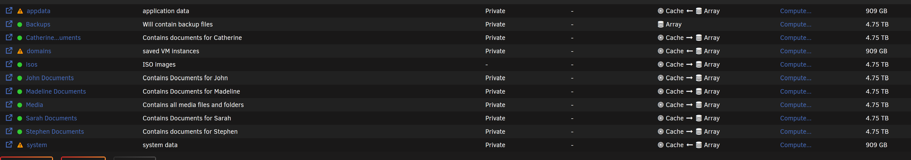

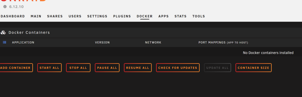

Thanks. i was able to re-install the apps and everything seems to working again.- Dockers Disappeared after replacing Cache drive?

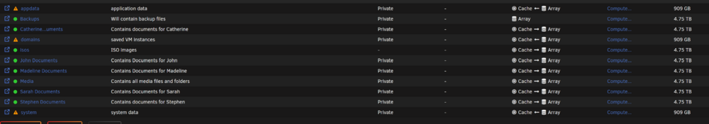

Here is the post I put in the lounge (was not sure where to put this). This has more info: This procedure assumes that there are at least some dockers and/or VMs related files on the cache disk, some of these steps are unnecessary if there aren't. Stop all running Dockers/VMs Settings -> VM Manager: disable VMs and click apply Settings -> Docker: disable Docker and click apply For v6.11.5 or older: Click on Shares and change to "Yes" all cache shares with "Use cache disk:" set to "Only" or "Prefer" For v6.12.0 or newer: Click on all shares that are using the pool you want to empty and change them to have the pool as primary storage, array as secondary storage and mover action set to move from pool to array Check that there's enough free space on the array and invoke the mover by clicking "Move Now" on the Main page When the mover finishes check that your cache is empty (any files on the cache root will not be moved as they are not part of any share) Stop array, replace cache device, assign it, start array and format new cache device (if needed), check that it's using the filesystem you want For v6.11.5 or older: Click on Shares and change to "Prefer" all shares that you want moved back to cache For v6.12.0 or newer: Click on Shares and change the mover action to move from array to pool for all shares that you want moved back to cache On the Main page click "Move Now" When the mover finishes re-enable Docker and VMs- Dockers Disappeared after switching my cache drive?

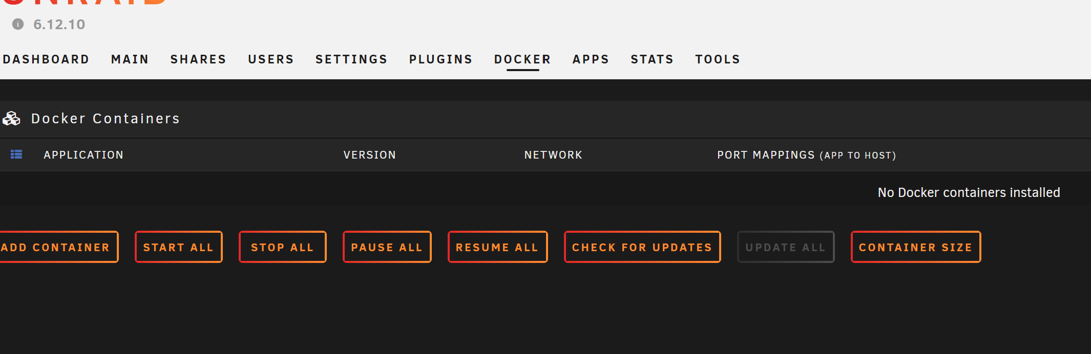

In case you need diagnostic file. auburn-diagnostics-20240910-1520.zip- Dockers Disappeared after switching my cache drive?
I changed my SSD which had erors to a new nvme drive. I followed the steps below and re-enabled docker and then went to docker tab and none of the dockers are there (Plex etc)? This procedure assumes that there are at least some dockers and/or VMs related files on the cache disk, some of these steps are unnecessary if there aren't. Stop all running Dockers/VMs Settings -> VM Manager: disable VMs and click apply Settings -> Docker: disable Docker and click apply For v6.11.5 or older: Click on Shares and change to "Yes" all cache shares with "Use cache disk:" set to "Only" or "Prefer" For v6.12.0 or newer: Click on all shares that are using the pool you want to empty and change them to have the pool as primary storage, array as secondary storage and mover action set to move from pool to array Check that there's enough free space on the array and invoke the mover by clicking "Move Now" on the Main page When the mover finishes check that your cache is empty (any files on the cache root will not be moved as they are not part of any share) Stop array, replace cache device, assign it, start array and format new cache device (if needed), check that it's using the filesystem you want For v6.11.5 or older: Click on Shares and change to "Prefer" all shares that you want moved back to cache For v6.12.0 or newer: Click on Shares and change the mover action to move from array to pool for all shares that you want moved back to cache On the Main page click "Move Now" When the mover finishes re-enable Docker and VMs- After Upgrade, Can't Boot to USB
