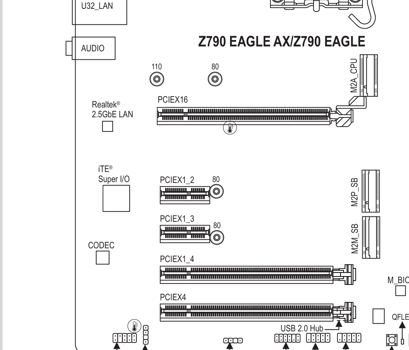

You have a 16 drive PCIe 2.0 HBA in a x4 slot and  17 drives, I'm imagining you connected all 16 HBA ports? That's 2GB/s divided by 16 drives, likely will limit things at the start of the check. Likely when you get past 50% and you're beyond those 4TB drives it'll speed up.

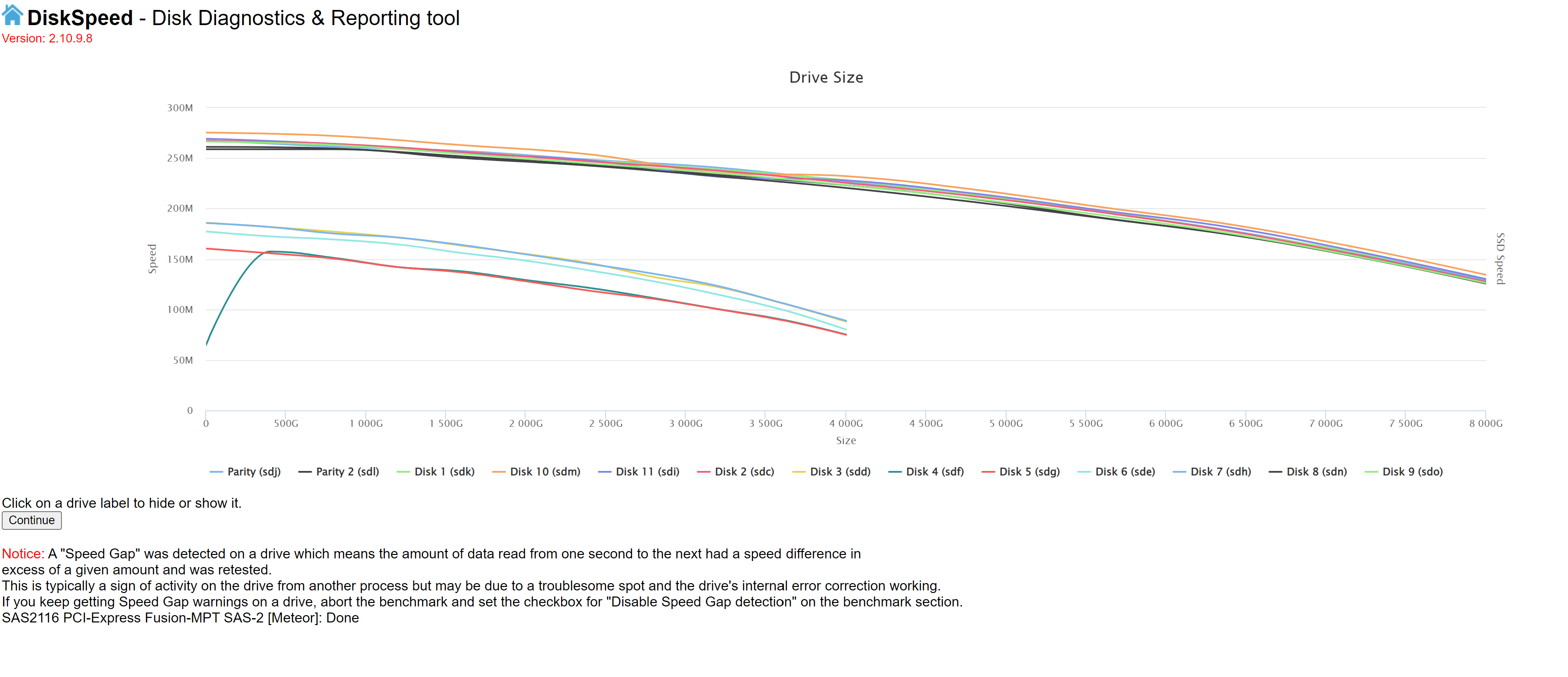

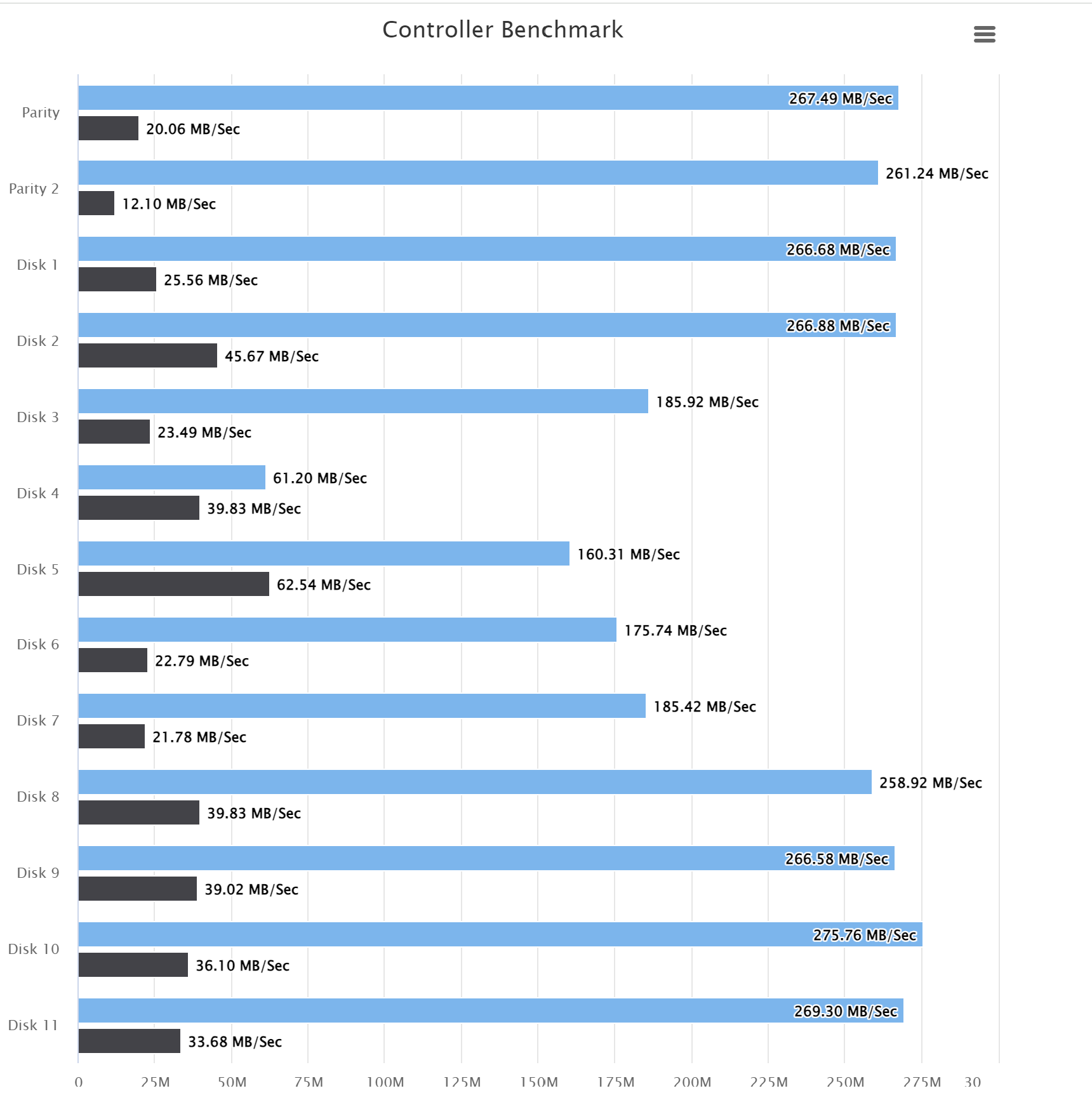

I stopped the parity check and downloaded diskspeed am running benchmarks now. Anything I should be looking for?
Post the results, both the disk and controllers tests.

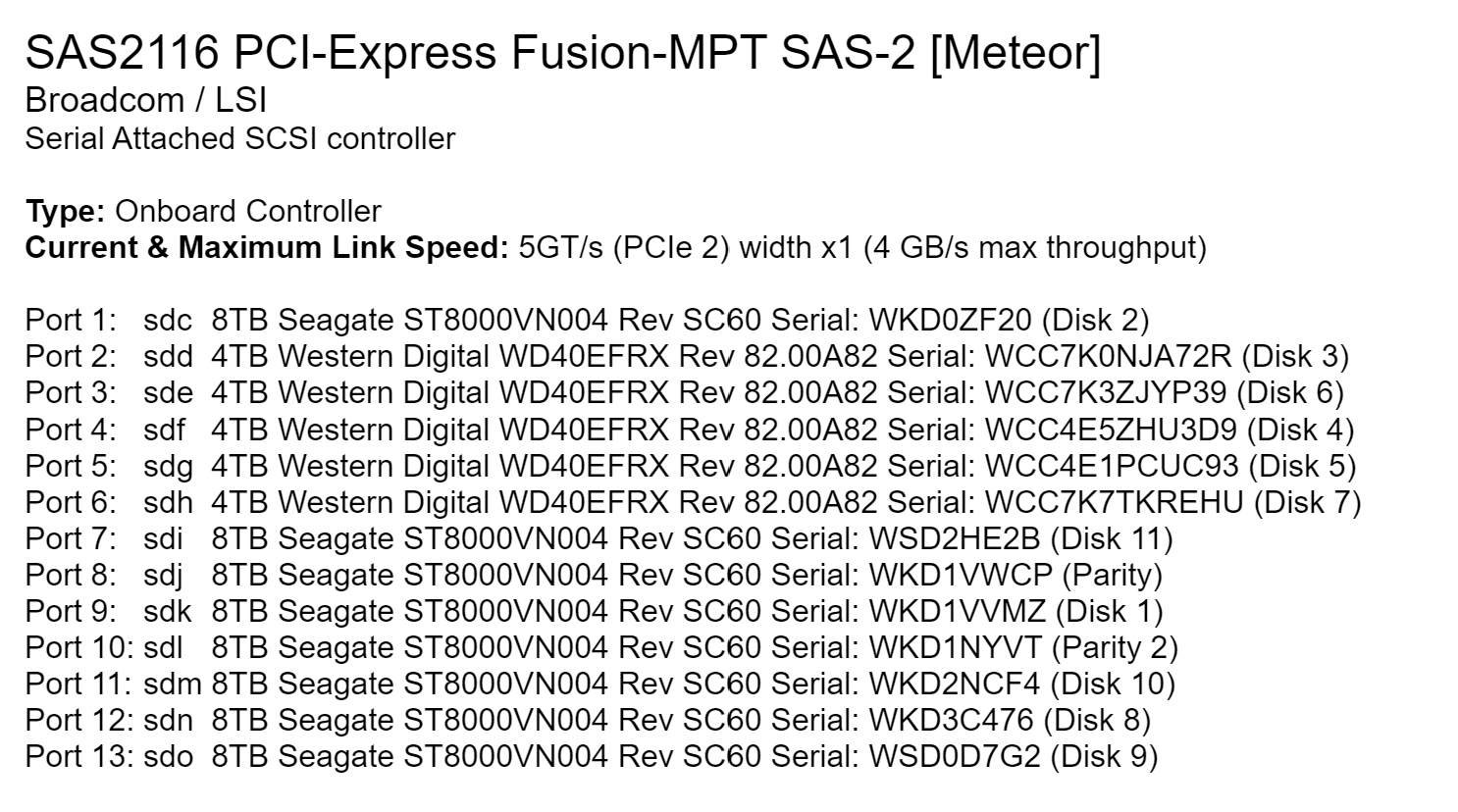

You've put the HBA in a x1 slot? That's going to be maxed out by 2-3 drives...

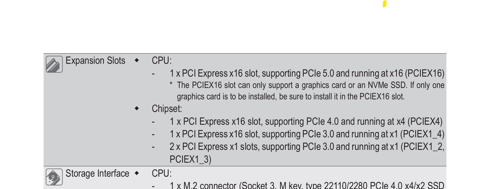

My screwup. I don't have a graphics card so the PCIEX16 is available but that may change which is why I did not use that. I also figured maybe incorrectly that because the card is old there is no point in putting it there.

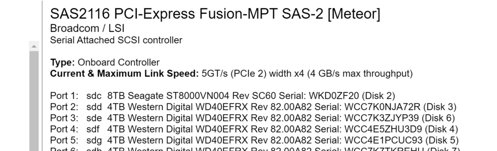

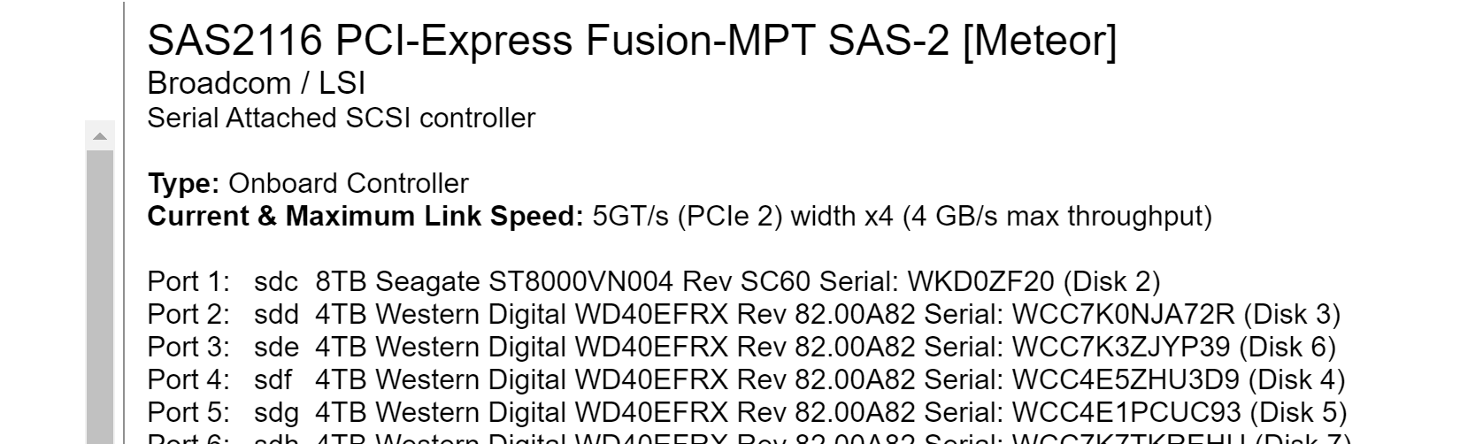

Want to make sure i put it in the right slot. Put it in the PCIEX4?
Thanks for finding that. I appreciate all the help. I changed the card to the PCIEX4 slot and it is now showing as 4X
